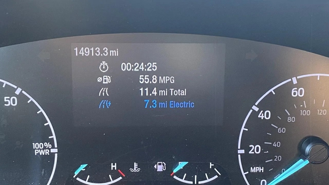

The design supports gasoline for acceleration and battery for sailing, gliding, coasting whatever you'd like to call it.
Remember: 22 horsepower is what you get. Not powerful enough to reasonably accelerate, just about right for maintaining speed.
This truck gets 55 to 58 MPG using it in this manner. Sometimes 60+ MPG.
The extra weight of extra batteries will hurt MPG in most cases. Also double the mass to heat up when too cold and double the mass to cool down when hot, and all that spends gasoline.
Without a plug, larger batteries won't help you UNLESS you have this specific case:
3 miles of downhill travel that is steep enough to require regen braking followed by uphill to use that up. Repeat.
If you don't have that repetitive scenario, extra batteries will just hurt your cost. Buy if you are into buying useless accessories for your truck, then knock yourself out, as long as you are not expecting performance gains or higher MPG.
I do this 6 days a week. On Sunday I rest.
