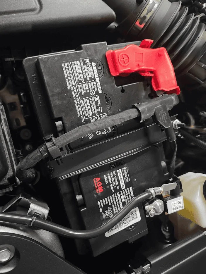

Seriously doubt it was replaced by the dealer, I just got the truck last week. Here is a pic of the battery, maybe its because I have AWD and 4K tow, dunno.

I have both and mine came with a flooded battery. Can you post a photo of your actual battery? Like I said, curious since as built data for the 2023 AWD I looked up would have indicated an AGM battery but it showed an enhanced flooded. If you did get an AGM and the BCM thinks it has a flooded battery then you're not really benefiting from having an AGM
Havent starting messing with forscan yet but will check when I put my cruise control switches in.
Ford Maverick Is 12 volt battery for hybrid a AGM battery? 1670509224736
NoVaJimmy
Apr 29, 2022
1,552
2,451
KCMO
Lexus GX 460
Thanks and good for Ford for making the upgrade. While in there I'd definitely make sure the BCM is set for an AGM. The as built data for the in transit 2023 FX4 I looked up last night was set for an enhanced flooded battery so if it does have an AGM the BMS isn't taking advantage of the superior charging characteristics of the AGM and charging it like an enhanced flooded battery.
Thanks for the tip, I may go ahead and check today in forscan, think there are a few settings I can play with...havent used it since I got my super duty a couple years ago so prob need to get the license upgraded. Is anyone keeping a spreadsheet of all the forscan changes you can make, I know there was one for my other truck out there...

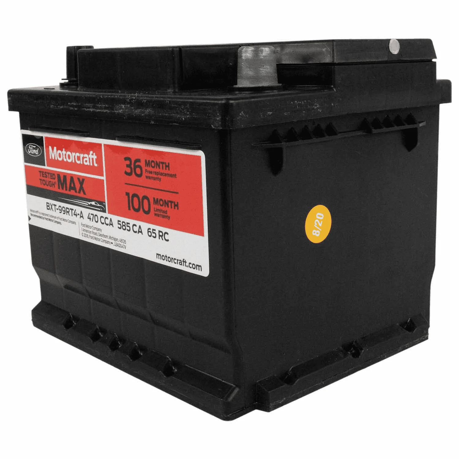

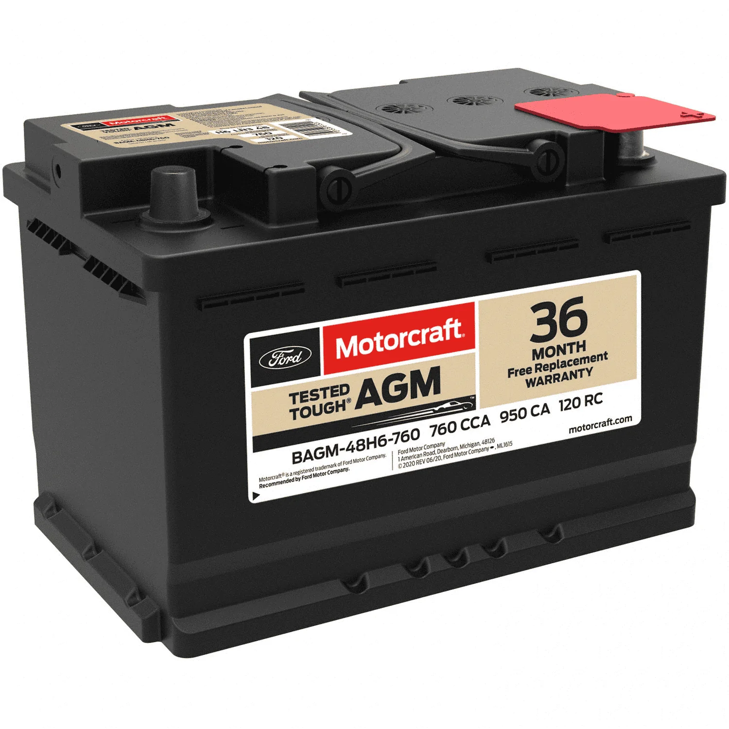

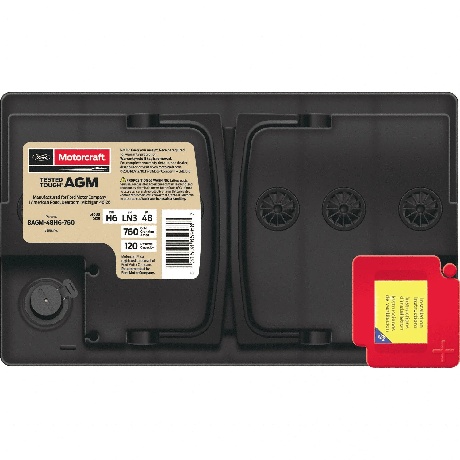

2.0L ECOBOOST - AGM battery: BAGM-348H6-760 (AGM in the part number)
https://parts.ford.com/shop/en/us/battery-and-related-components/battery-7862483-1
"AGM" is clearly printed in large letters on the top and side of the battery
Ford Maverick Is 12 volt battery for hybrid a AGM battery? 1670513031387
Ford Maverick Is 12 volt battery for hybrid a AGM battery? 1670513069458

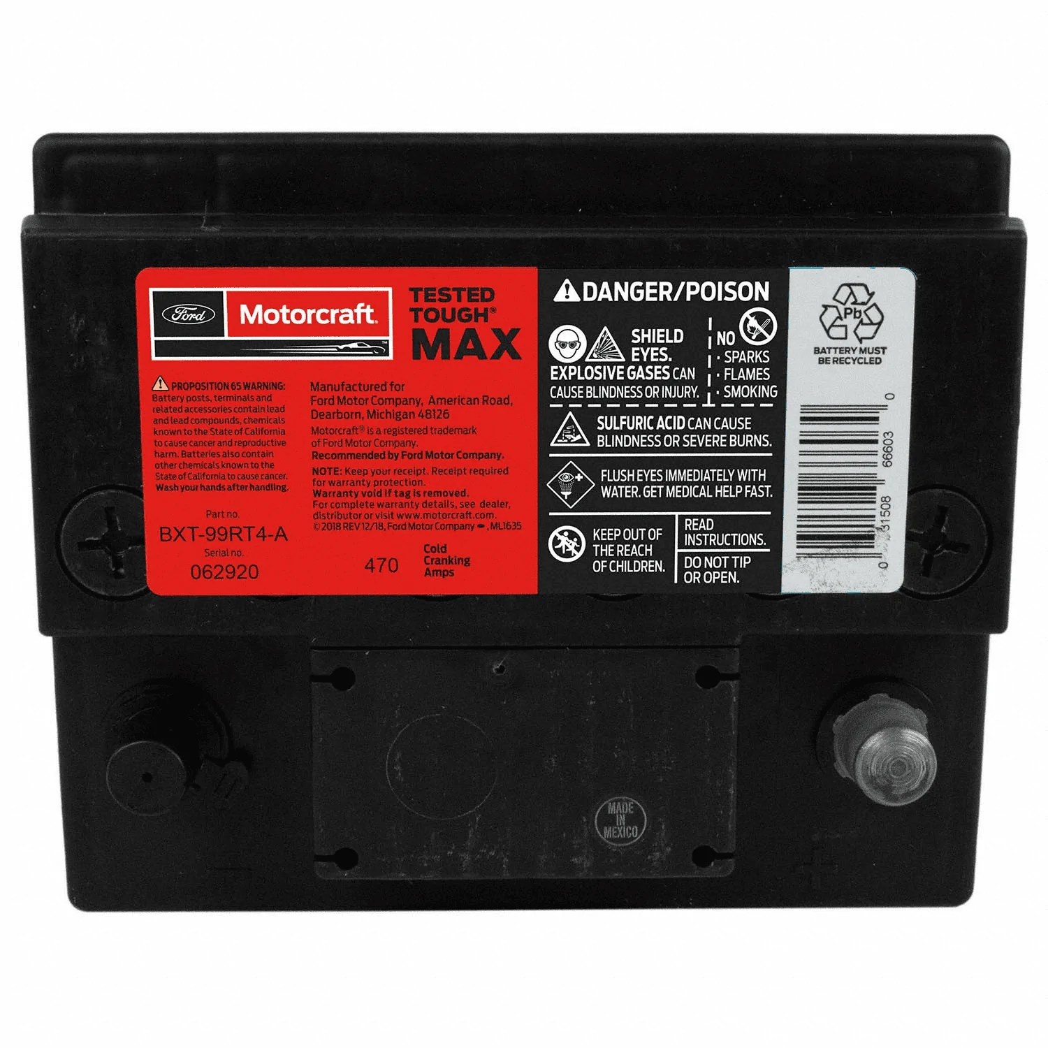

2.5L, HEV - Standard Flooded Battery battery: BXT-99RT4-A
https://parts.ford.com/shop/en/us/battery-and-related-components/battery-7868851-1
"AGM is nowhere top be found on the battery
Ford Maverick Is 12 volt battery for hybrid a AGM battery? 1670513150257
Ford Maverick Is 12 volt battery for hybrid a AGM battery? 1670513248304
Is it possible that ford has shipped hybrid Mavericks with different batteries?
Possible, yes.
I can't tell you what you have in your vehicle, you may have an AGM, but various members have shown photos of their "BXT-99RT4-A" battery in their hybrids. This is not an AGM battery.
