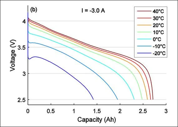

4) Batteries perform worse in the heat. "Even your cell phone drains faster in the heat." FALSE - and the video could/should be corrected.
Batteries perform BETTER in the heat. Always. Up to their degradation limits which are quite hot.
Ford Maverick Option for a second hybrid battery 1667059730610
Capacity, or Amp Hours (Ah) are what we are mostly talking about in this thread.
At 40'C you will have about twice as much battery power as you will at -20'C. Not a lot of us drive around at -20'C.
But you will have about 25% more battery power at 40'C (105'F) than 10'C (50'F).
Also deceptive was his "Winter" was 80'F. You all living north of Texas are going to hate the MPG loss in actual winter.
I'm sure you'll agree, taken in context, WINTER is the real foe to MPG and summer is your friend. 😎
