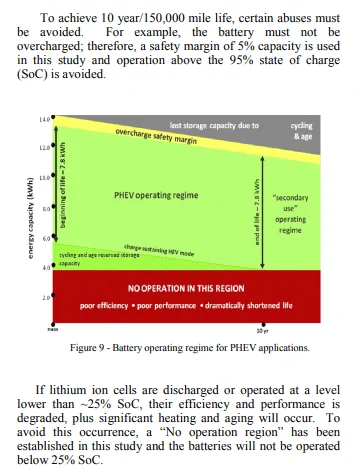

So after 8 years, when we have to pay for battery replacement, there is a lot of money and effort going into figuring out how to salvage and remanufacture EV batteries. by the time we need one, should be affordable options.
Also, EV battery design today typically allows for degradation over 8-10 years. Say a battery will lose 30% over 10 years, that 30% is added capacity in the design with software controlling the effective capacity. So a battery will not be overcharged at full (vs. the only charge to 90% and unplug of early EVs). But will continue to eat into the excess as needed as the battery ages to maintain performance. Once the battery eats up the excess capacity (lets say 10 yrs) then you will see actual performance degradation. But the battery is ALWAYS degrading over time. Those living in hot climates will see faster battery degradation. single best thing a person can do to increase battery life is to avoid long periods of parking in direct sun on hot days. (see graph from study on design of PHEV. Note dark green (hard to see) is reserve and is used to offset degradation. Link to Ohio State U research paper that this graph comes from. https://cecas.clemson.edu/~sonori/Publications/536.pdf
