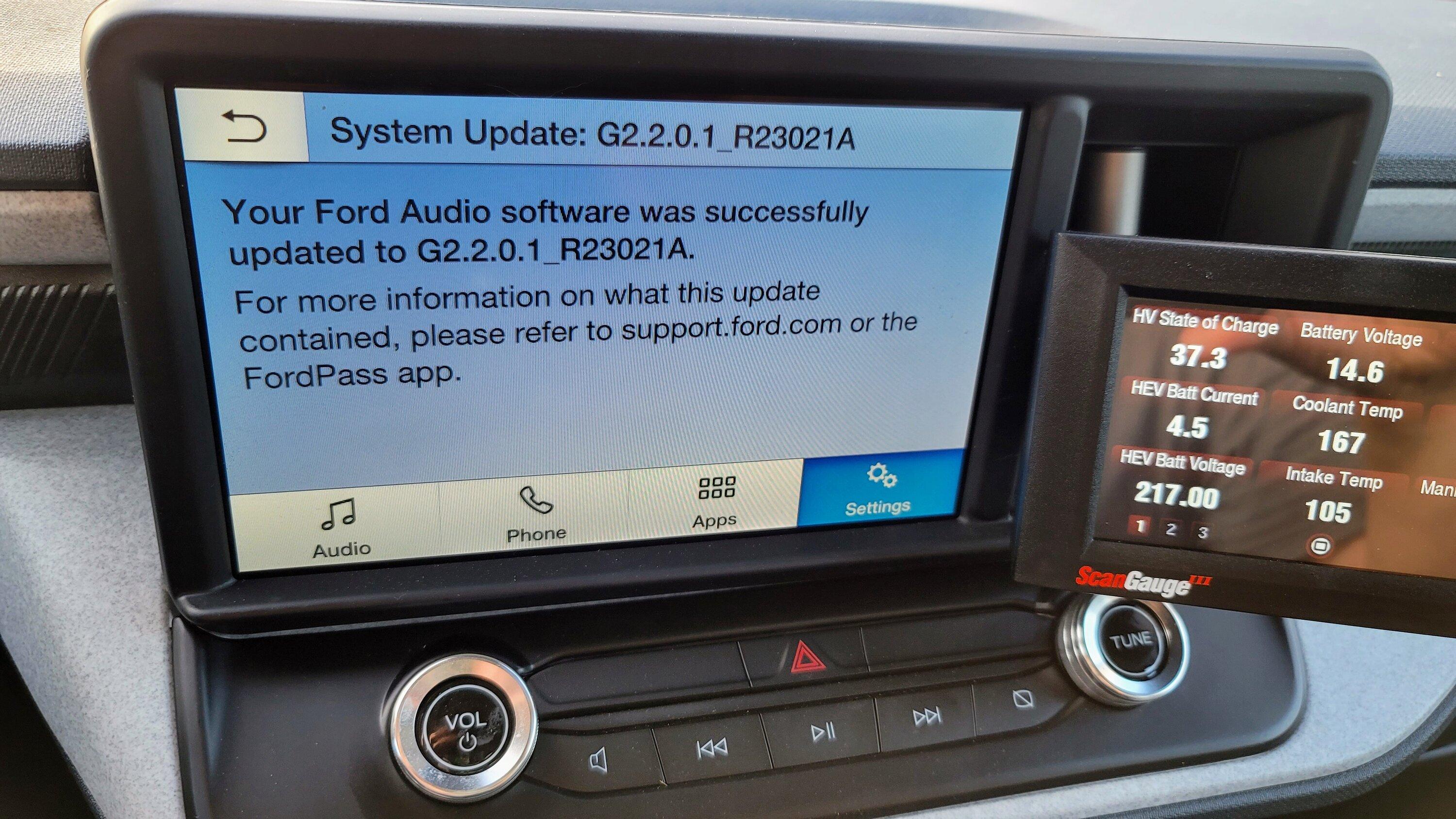

Ford Maverick New stereo firmware update available! 20231001_182523
Welp, that was a PITA.
So to preface, I had auto updates and WiFi turned off. My update experience went like this:
1. Get in and start the truck
2. Navigate to the Settings-->Wifi menu
3. Turn wi-fi on
4. Have it fail to connect to the 2.4GHz band on my home wifi. Phone had 4 bars of connectivity, truck had 1.
5. Turn on Wi-Fi hotspot on my phone
6. Rescan available networks and have truck connect to my phone hotspot.
7. Truck fails to connect to phone hotspot.
8. Truck decides that it did in fact connect.
9. Enable auto updates on truck.
10. Sit and wait for truck radio to do anything.
11. Nothing happens after 5 minutes.
12. Soft reboot truck radio using power and FF button.
13. Radio reboots, navigate to auto updates menu.
14. Truck decides that it wants to update and starts downloading update.
15. Update downloads in about 10 minutes.
16. Update installs in about 8 minutes.
17. Nothing happens.
18. Decide to soft reboot radio again.
19. Radio reboots.
20. Robot lady voice startles the shit outta me.
21. Update complete :)
