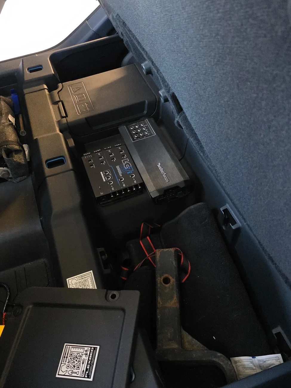

If you use forscan it's not just eq on or off. You can remove the crossover on the rear. Instead of taping off at a speaker use pac audio LPHFD31 so you will have all front rear left and right adjustment. I went with a audio control lc7i pro to a 5 channel rockford and a shallow 10 rockford power series behind the seat.
