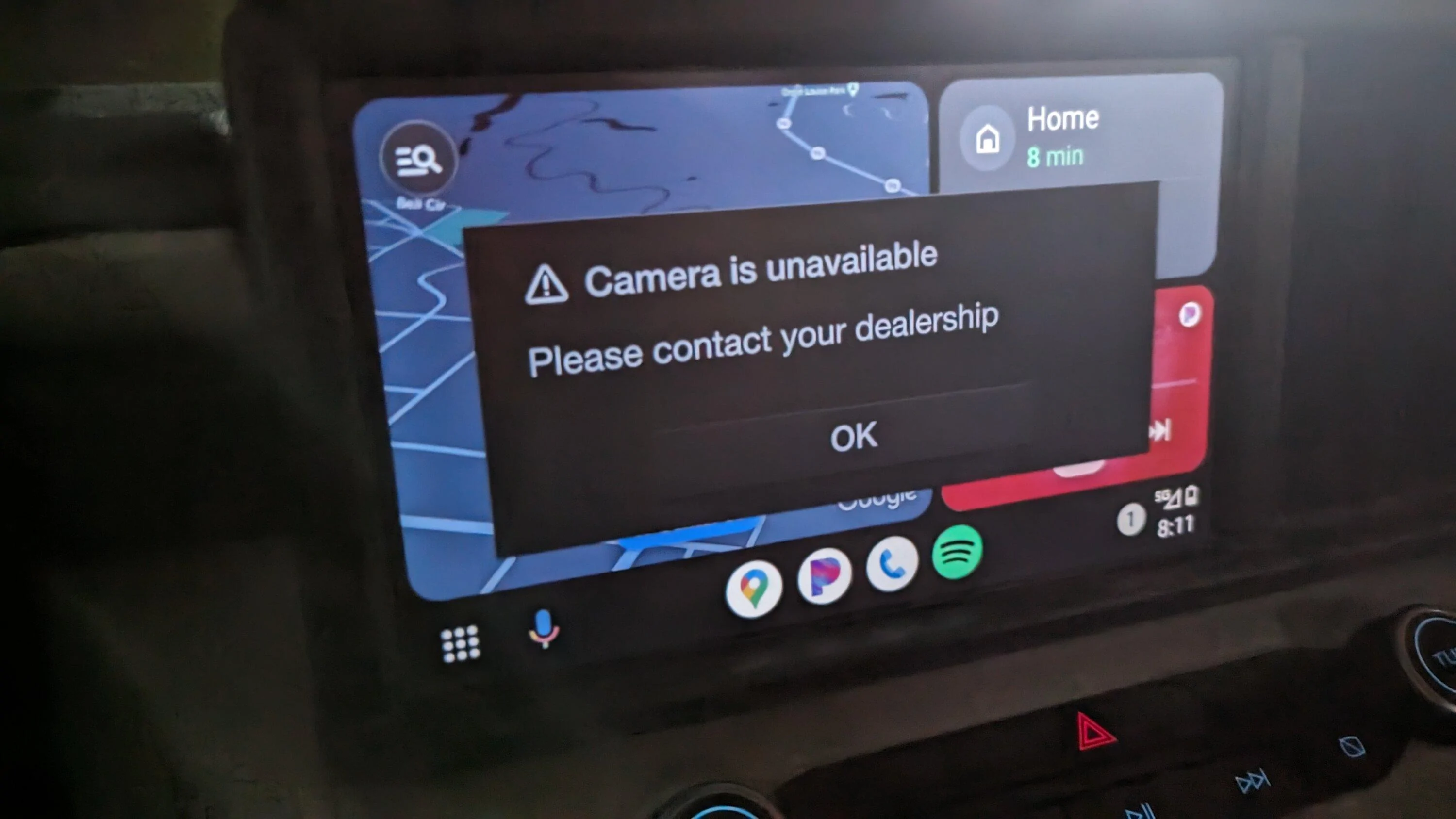

Never got this before...
Me thinks that there is a loose connector somewhere. You're still under warrantee, follow the instructions and contact a dealer that you trust.
Lulz, I trust no dealer. I am significantly more qualified.
There isn't a loose wire either. It's just a shitty system in general.
i had the same screen pop up about 6 months ago. It never re-occurred so I just assume it was a one-off anomaly
I get that every once awhile. I always hit OK and the reverse camera always works like normal. Just software bugs.
