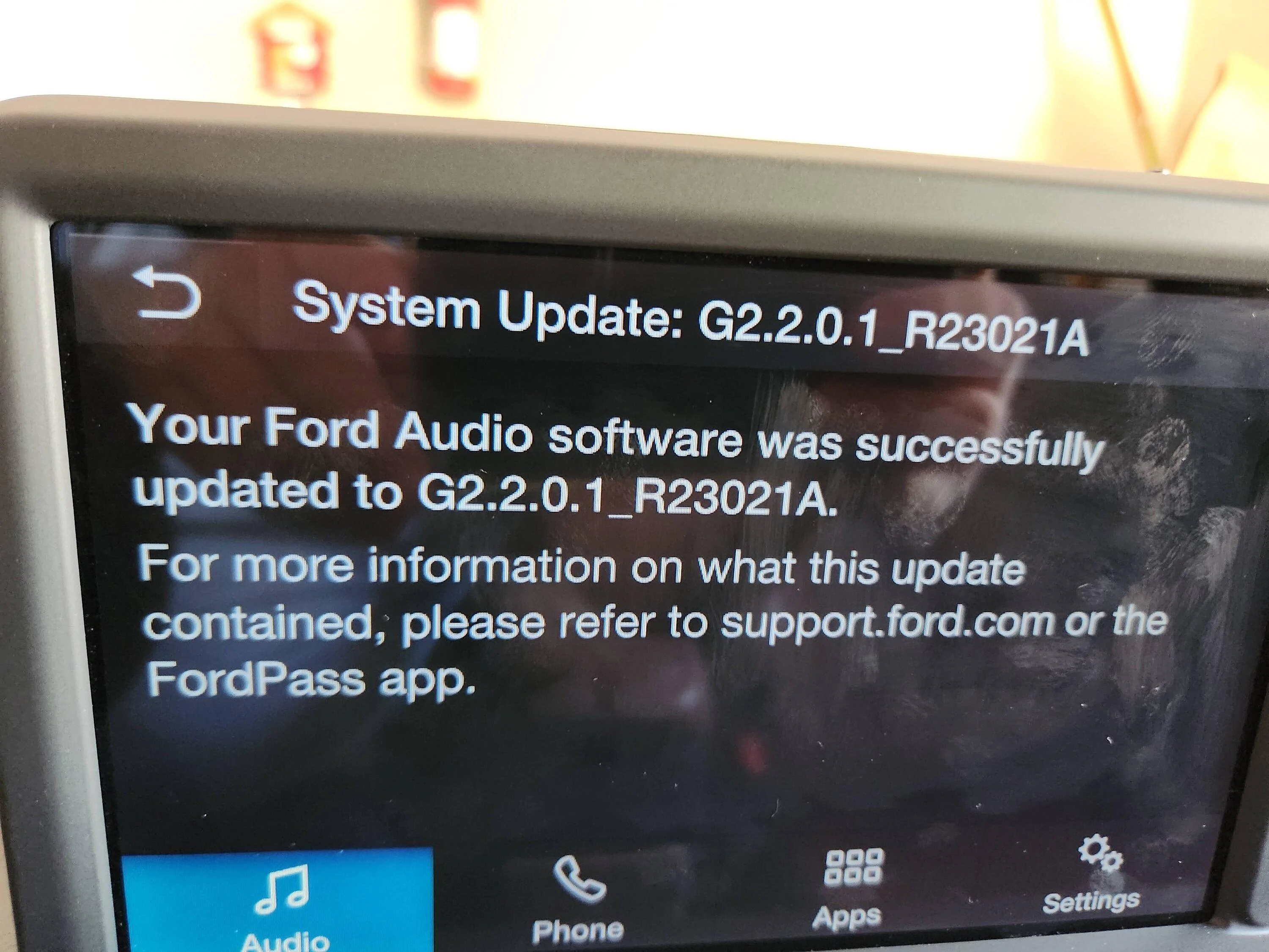

Finished updating mine as well. I think it took a fair bit longer than 10 minutes though. I got a weird message at 80% saying the password was rejected? It seemed like the WiFi disconnected. I reconnected (with the same saved password) and it finally finished. The installation step showed some odd messages like "Logging is already disabled" and I didn't get the audio "upgrade complete" until I did the reset.
I will be interested to see if there is any stability improvements. Since I've owned mine, I get random audio pops, USB playback glitches, and of course the USB scanning every time the vehicle re-starts. I somehow doubt I'll see any changes to those annoyances.
This screen says to check Ford Support or the FordPass app for what's included. That must be a joke. The App doesn't say anything and neither does Ford Support.
