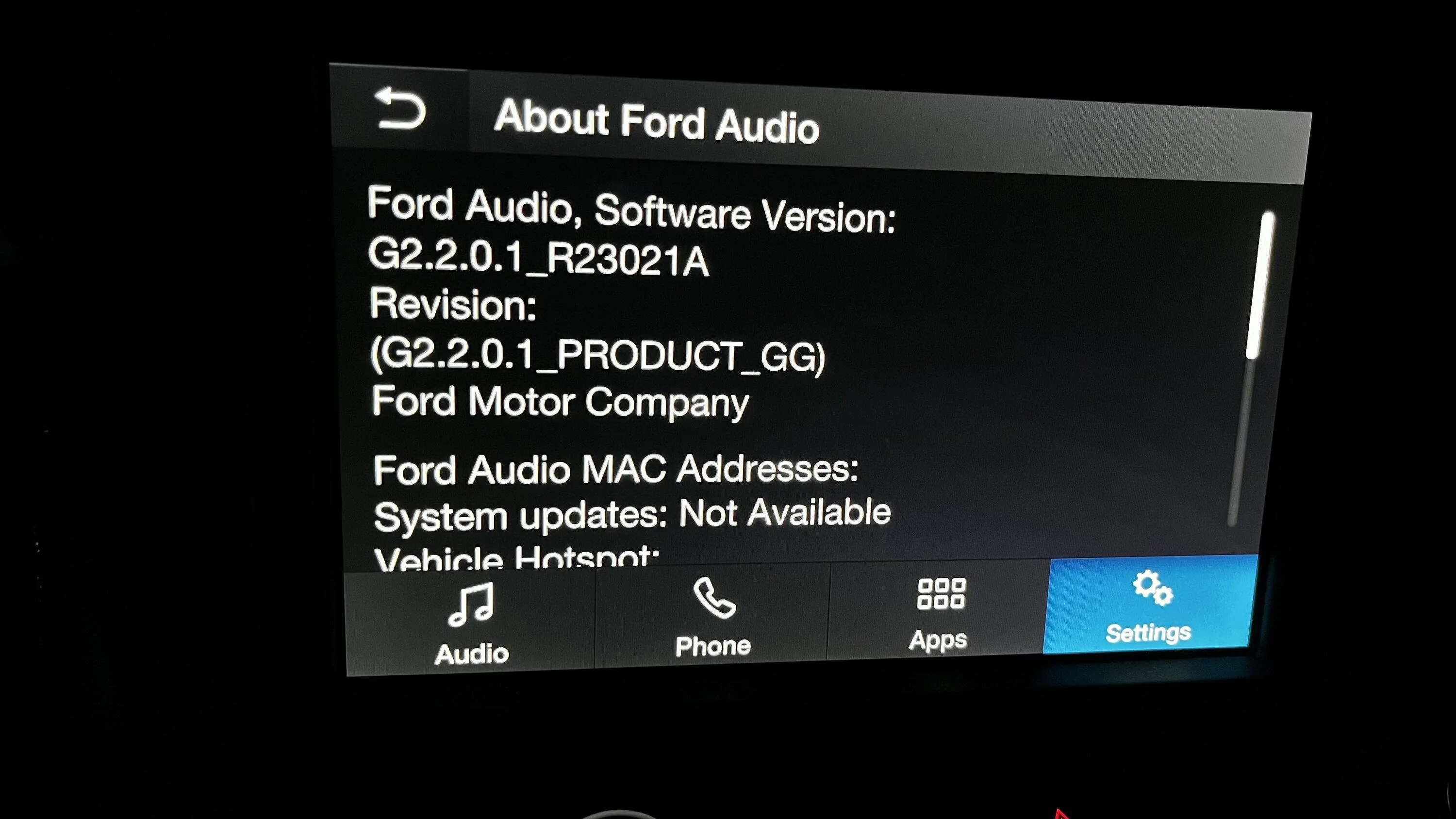

I got it to work on WiFi finally. I did the hard reset, tried different WiFi connections. Once it started to download, it took about 40 minutes to download and 10-15 to install. Didn’t get the confirmation screen pop up. But, got a verbal message that said what the pop up would have said.

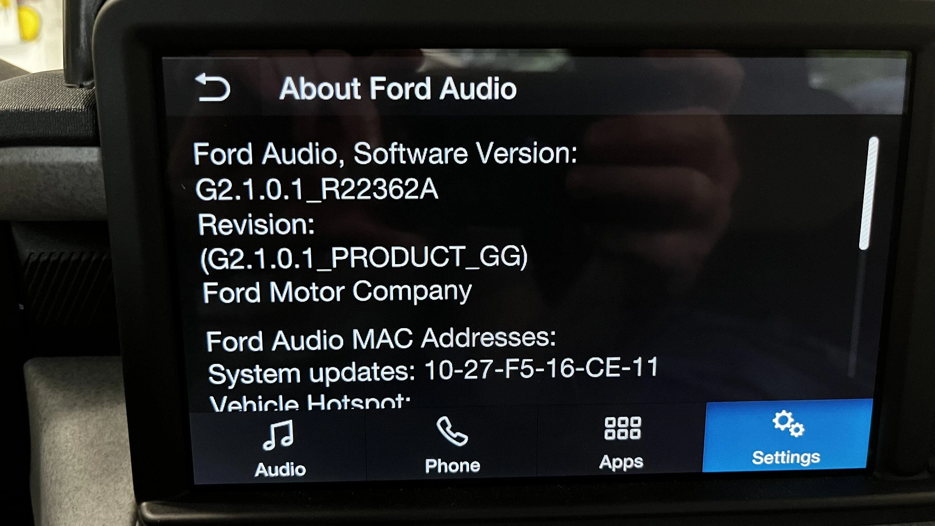

Previous is the one you mentioned.
This is the new one
Ie tried many times to get the new updates with no success so any help? I’ve got strong wifi signal. Tia

I tried this when I got home from work. After a few tries I got it to take, download, then install after about 10 minutes total. Winning combo for me was truck actually running, not just key on, and my phone hotspot connected and not just the plenty strong house wifi. I left it sit for a bit after the download and install were complete with the key off and out, and went back out in the garage and keyed on and after a minute or so it gave me the audible voice message that the install was successful. And the current version said G2.2.0.1 which it didn't until after it sat dormant for a bit. I'll see if anything has changed tomorrow when I drive it. It's kind a finicky process but that worked in my 23 XLT.

Just completed the update, 15 minutes to download and install. Left the truck for about 15 more minutes & like others, did the on/off cycle twice. Received the audible success message & verified the 2.2.0.1 version. Wasn't having any issues & who knows what if any improvements I'll see but I definitely want to have the latest software.
