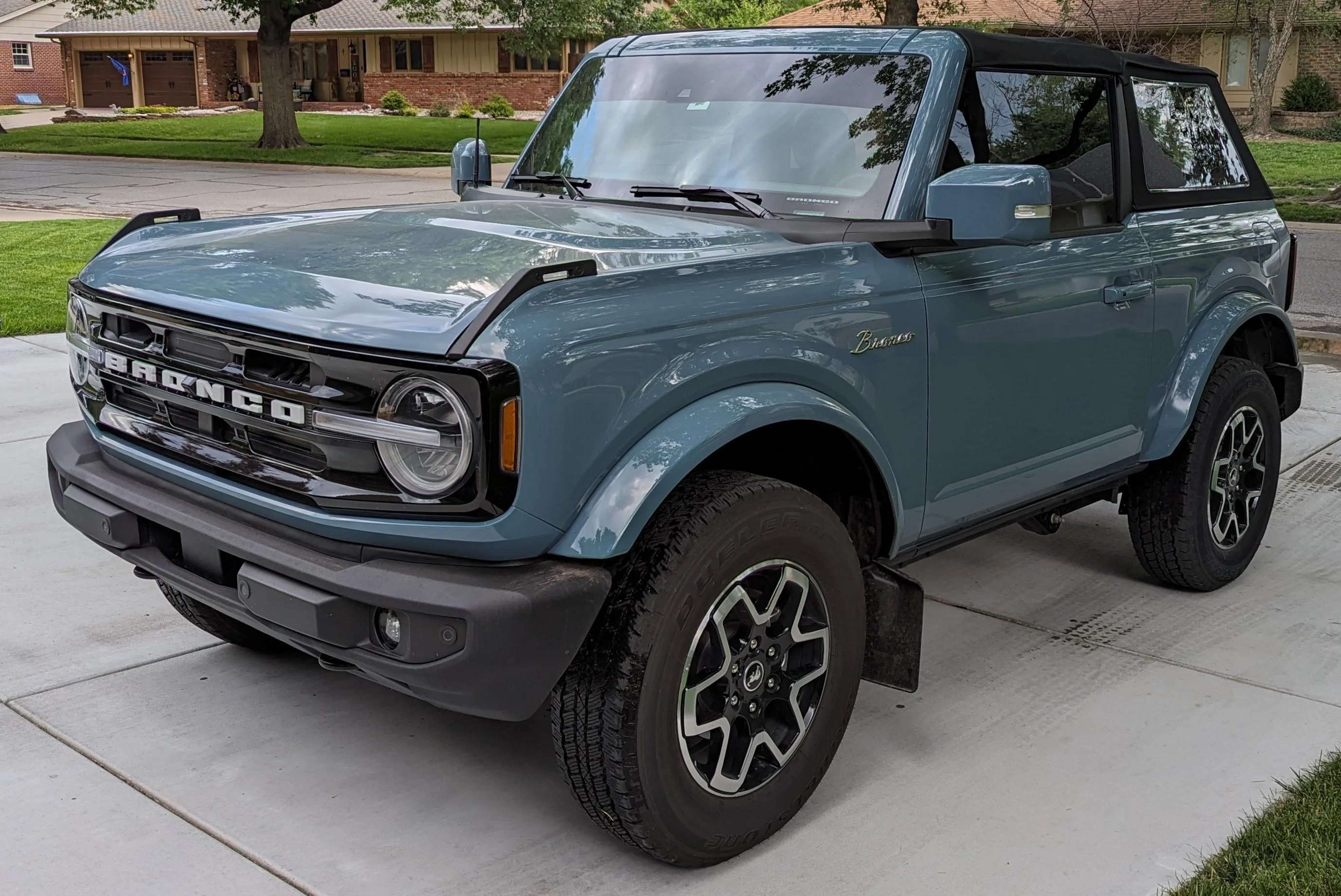

First off, all modern paint sucks. This is not a Maverick specific problem. It's apparently better for the environment now, but it's thin and easily chipped especially on plastic surfaces.
Ceramic coatings are very expensive for what you get. It is wax with a clearcoat. The clearcoat is .02-.05 mil thick. It offers no meaningful protection against stone chips. Read that again.
You can achieve the same shine by hand washing, clay bar if necessary, and applying your own wax. I use Meguiar's hybrid ceramic every 60-180 days (depending on how much it's out in the elements) and it's $15 a tube that lasts at least 6 applications.
The only real protection against stone chips on the bumper cover and front fascia is paint protection film. Products range from 4 to 13 mil thickness and the thick ones are 'self healing' against gravel chips and scrapes from branches because the material is so thick that it can melt and re-form smoothly in the sun or if necessary a heat gun. But even the thinnest PPF is more than 100 times thicker than the clearcoat layer of ceramic coatings.
If you have vehicles a very long time, buy a quality PPF and plan to have it professionally removed and replaced at the 5 to 10 year mark. The old days of PPF yellowing and cracking should be gone unless you're buying cheap crap on Amazon and applying it yourself.
You can spend your money on whatever you like but I would suggest PPF every time over ceramic, and no, I would not pay for ceramic on top of PPF but if that appeals to you, go for it. Here's a pic of my Bronco with PPF on the grille, partial hood, door cups, lower doors (to the 'blood groove'), fender flares and side mirrors. And the shine? Regular wax.
