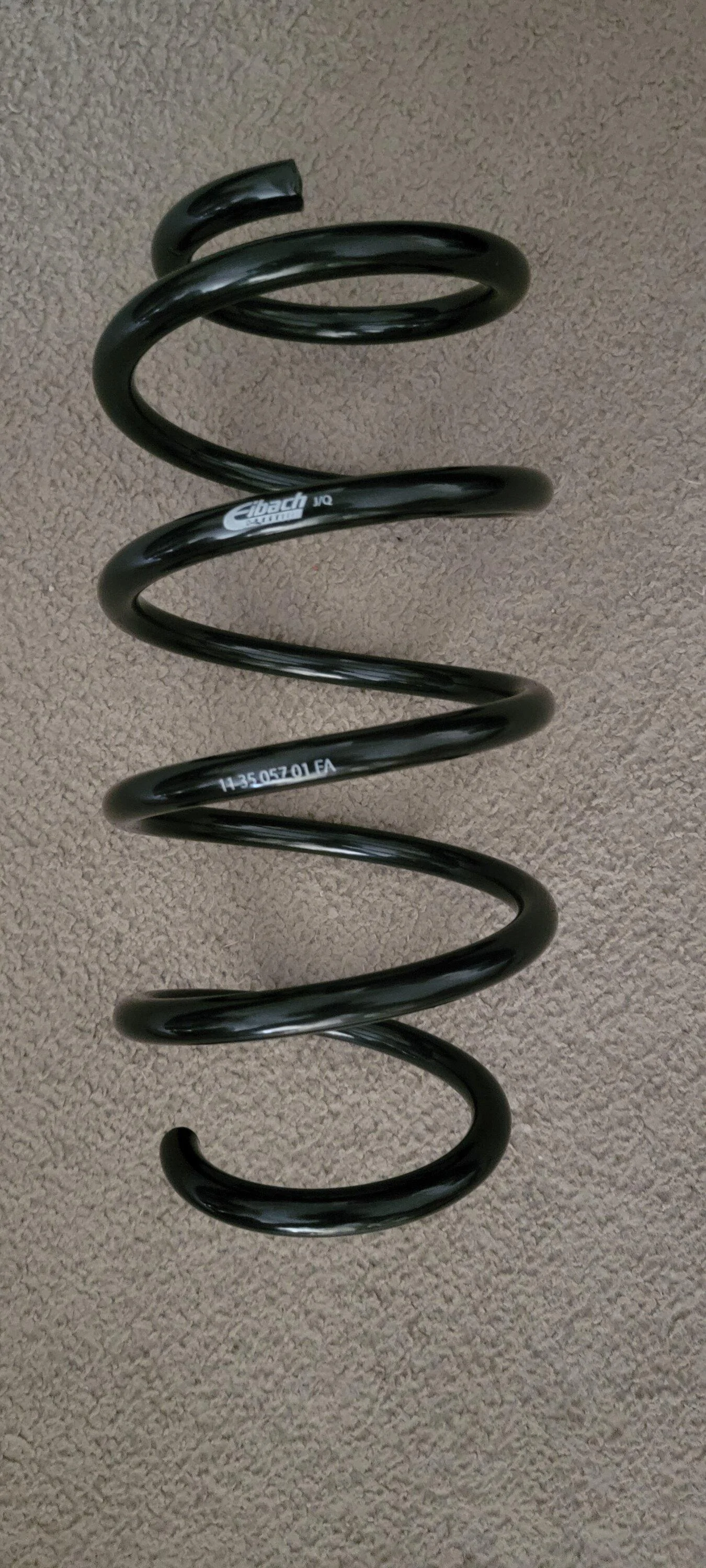

I received the updated springs today and they look to be much different. I will give them a go once the weather breaks.
Post up some pics, I asked Eibach for some but haven't gotten a response from them yet.

Hello everyone, we have finally been able to determine that there is enough variance between the production chassis components and our springs to cause interference in the scenario that both are at opposites ends of their tolerance allowances. We have designed a completely new front spring to account for this variance and they have already been tested on multiple vehicles with success. They should be available as early as next week. Thank you for your patience in allowing us proper time to diagnose and remedy a solution. Please contact the sales team at eibach.com if you are experiencing any noise issues currently.

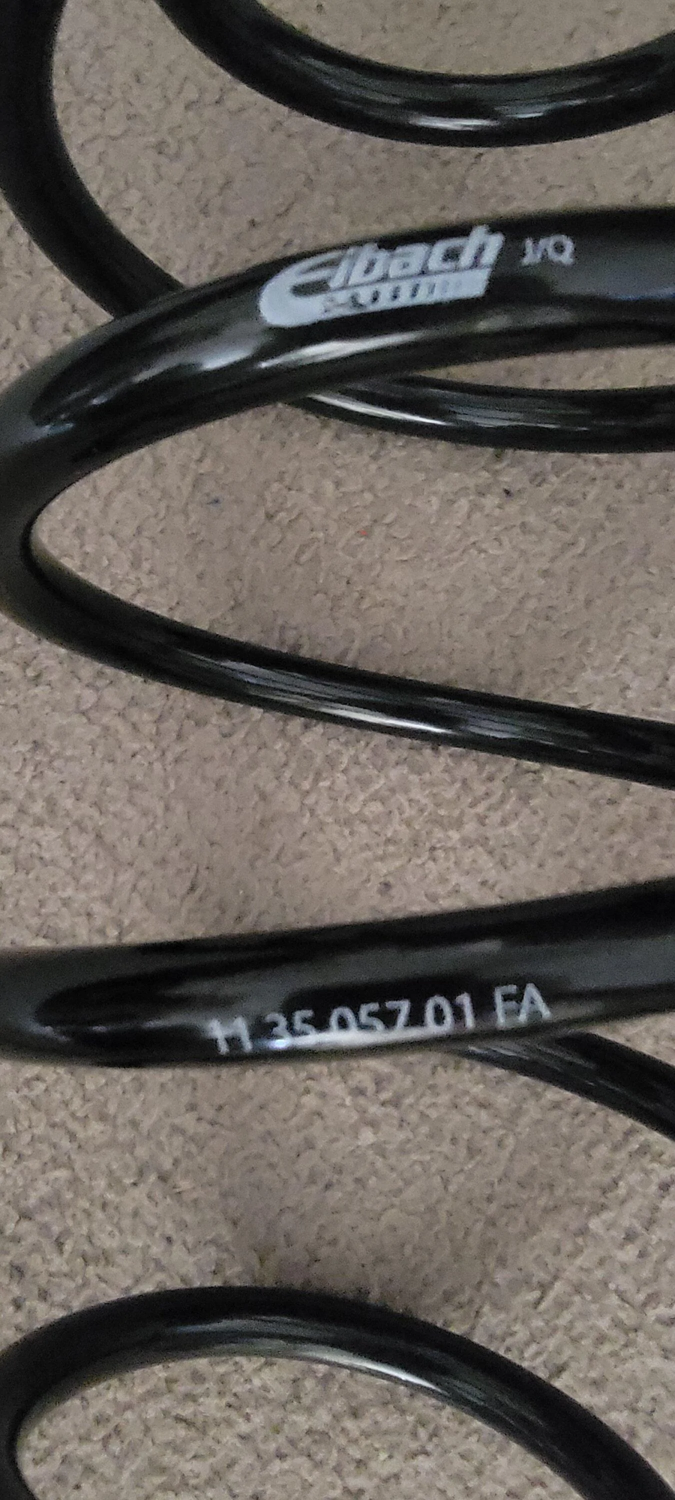

Thanks for posting those. Looking at my pics they don't look that much different except they removed the isolator sleeve. The part number is different, so I am very curious...

Where the isolator is in the first edition springs the coils are close together. The coils on these are nowhere near close to each other.

I actually just looked back thru the pics again and the part number is the same. I see the difference lies where the isolator was. Those 2 coils are more roomy now. Which begs the question of is the drop going to be the same with the same spring rate as before?
