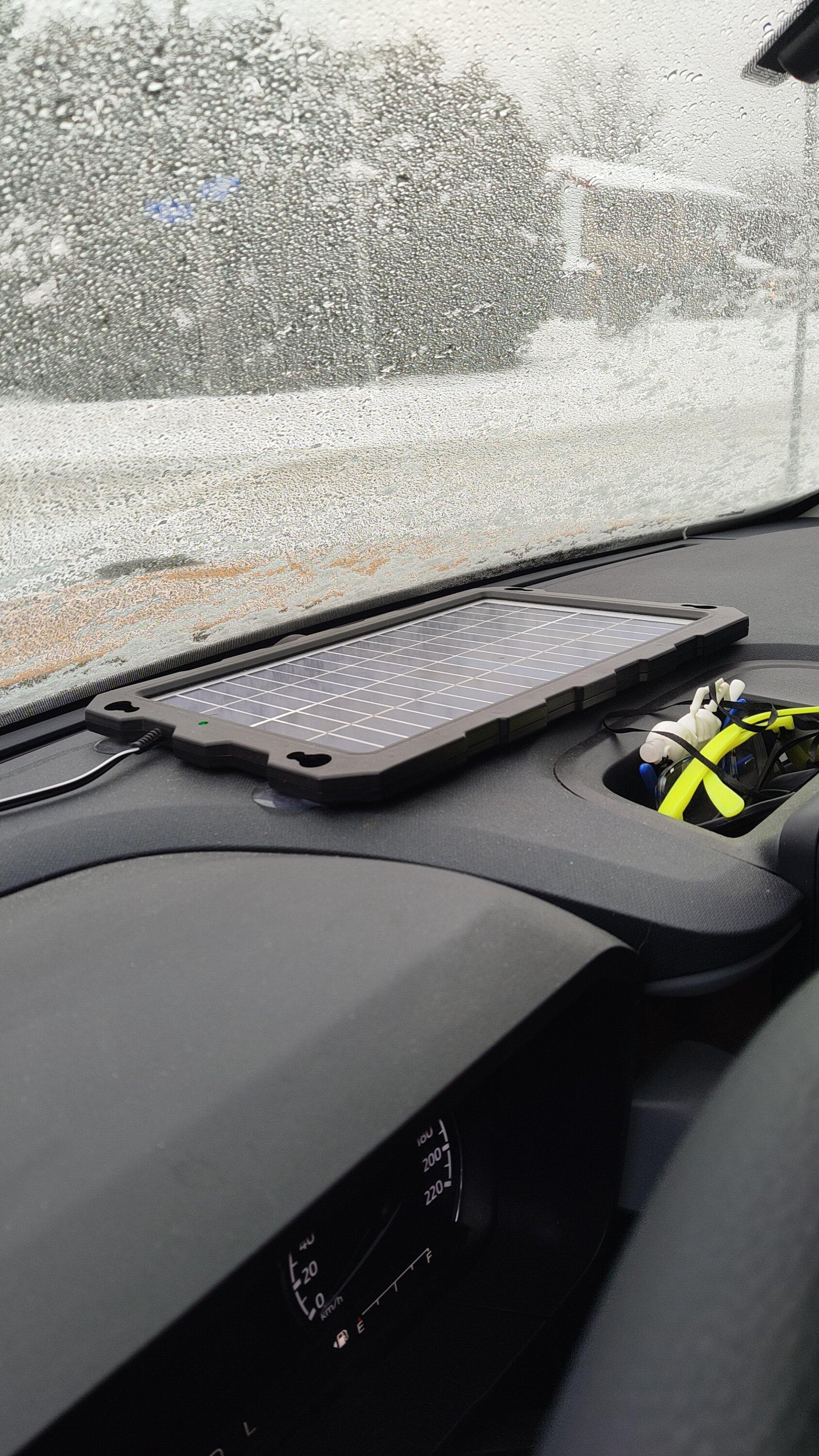

I put a solar charger that seems to help with the battery drain.

I like the Solar Charge idea. If I have it putting the charge back thru the cigarette lighter, will the current flow stop, to the battery, if the car is turn off and the cigarette lighter auto disengages? Does this mean you have to wire to battery?

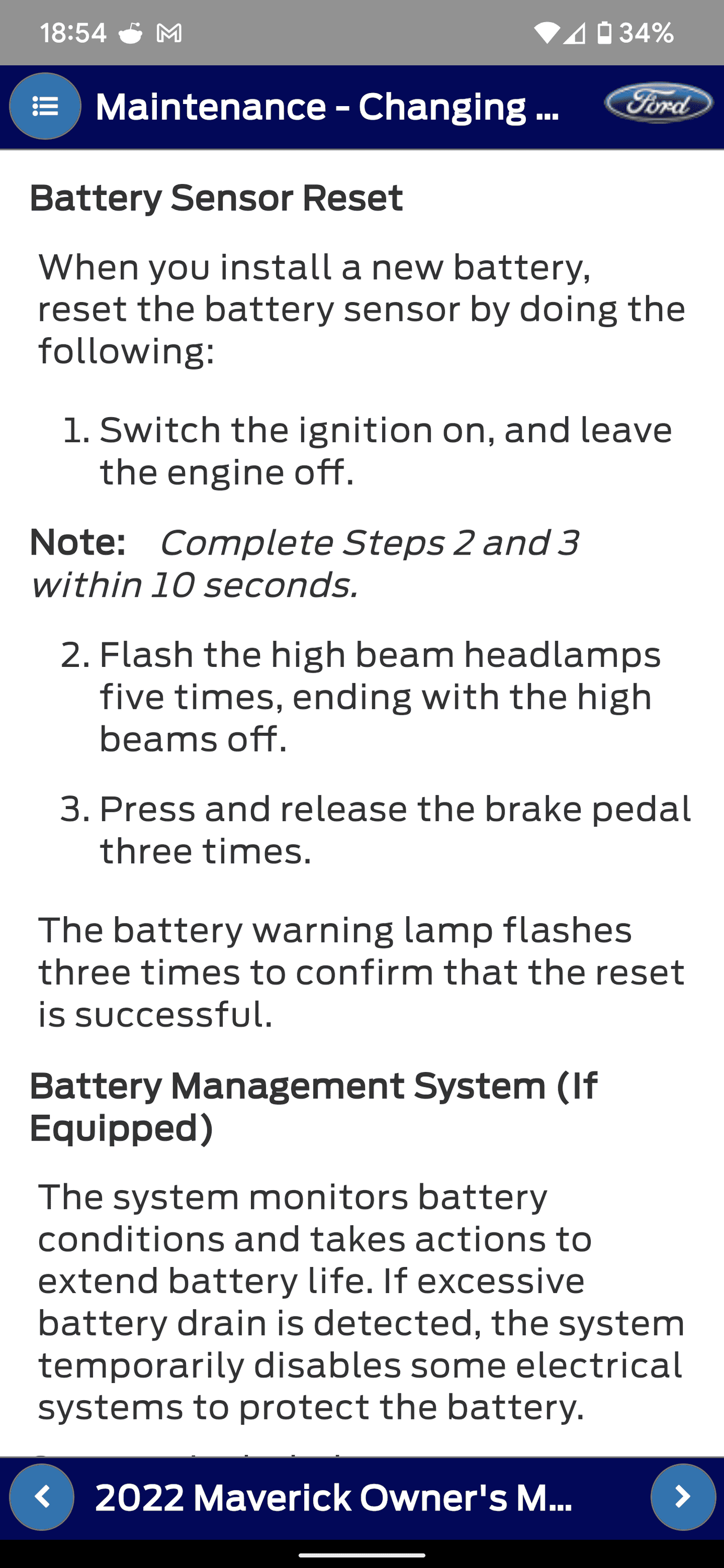

Interior dome lights no longer automatically turn on when opening door.
Either exiting or entering the Maverick - automatic dome lights no longer functioning
Any advice is appreciated. Thank You
Probably not a loose nut behind the settings controller...

Oh, You got "Deep Sleep". But in it's early stages the truck still starts. This is the stage my truck is in for about 5 months. Trying to guess what the next step is:
Transmission
Battery
Battery Cable
Problems.
But I do love my Truck. It's perfect, except.

Still no fix for deep sleep issue and dome light yet huh?
Charging the battery overnight then resetting the BCM fixed mine for 1.5 months. I just got a deep sleep message last night but I think it's due to adding a enclosed powered subwoofer which has been turning on randomly as I wired it into the speaker line input. Even opening and closing the doors causes it to trigger. I'm changing that to a remote wire from the ACC today.
