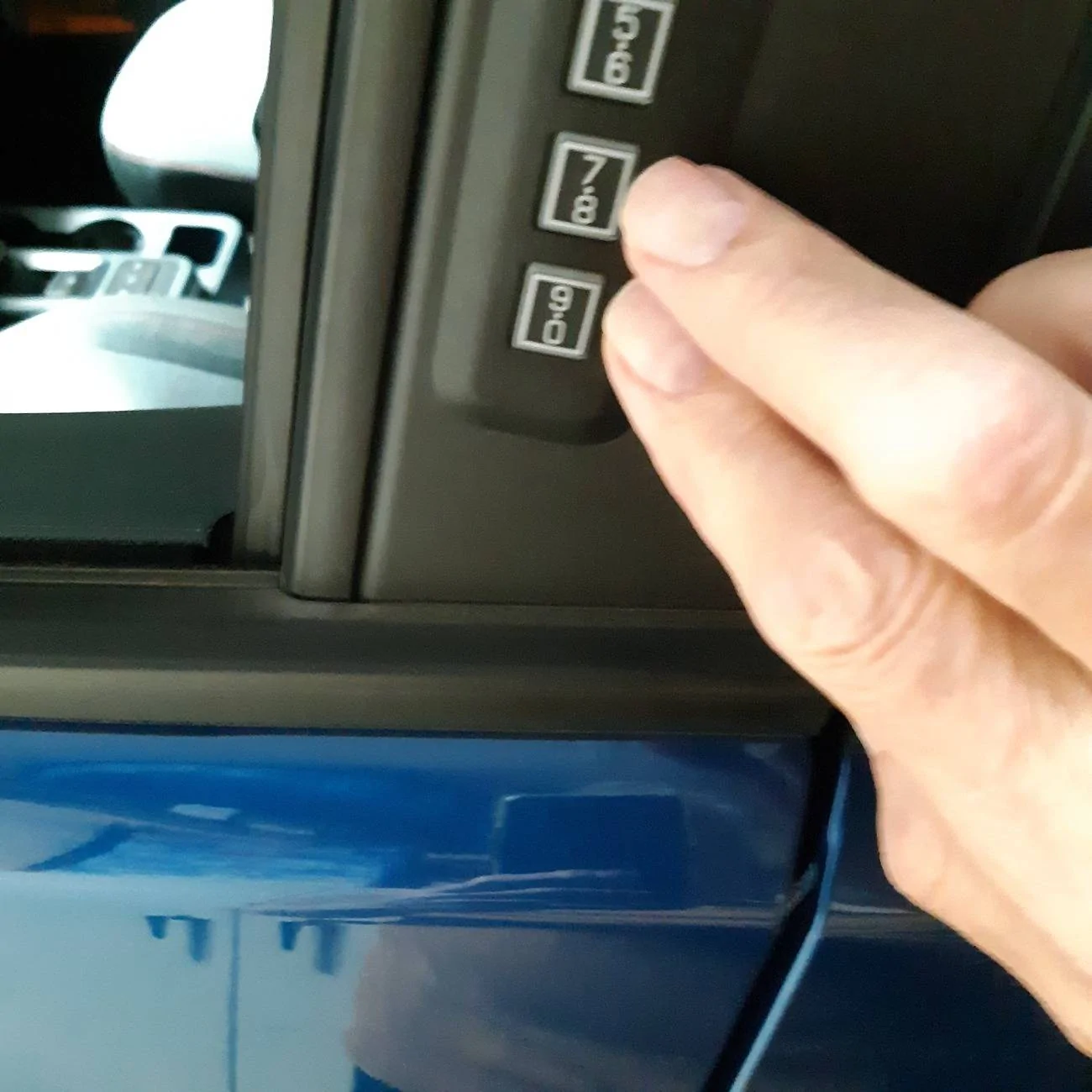

Does the keypad illuminate when you push any of the buttons?
Things that don't make sense. You confirmed that pushing the bottom two 8/9 buttons will lock the truck. That means that the keypad is working.
Ford Maverick Keypad not functioning 20250605_103616
Some things that I've confirmed.
When pushing a button, the keypad should illuminate but there is no sound all.
Is there any hesitation??
You have Less Than 6 sec. To input numbers.
Once the light goes out on the keypad or 5 1/2 seconds transpires, you have to start all over again.
