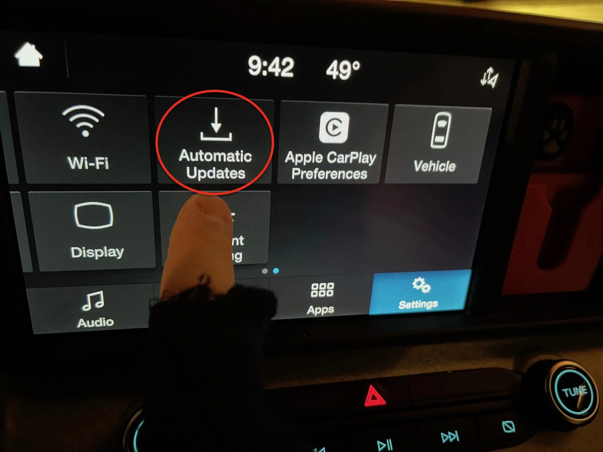

I went into settings and looked for Wi-Fi
Settings on the dash screen that you get to from the steering wheel or settings on the infotainment screen? I think they are on the radio screen right?
Not to sound like a jerk, but I usually use the dealer to help resolve these issues. The pickup does have a warrantee that includes the battery.
I am overseas and getting to a Ford dealer requires an appointment and it isn't real close to me and my guess is if I went there they would probably tell me "it is not possible". :)
All from the infotanement screen.
I’ll try and send you some screen grabs.

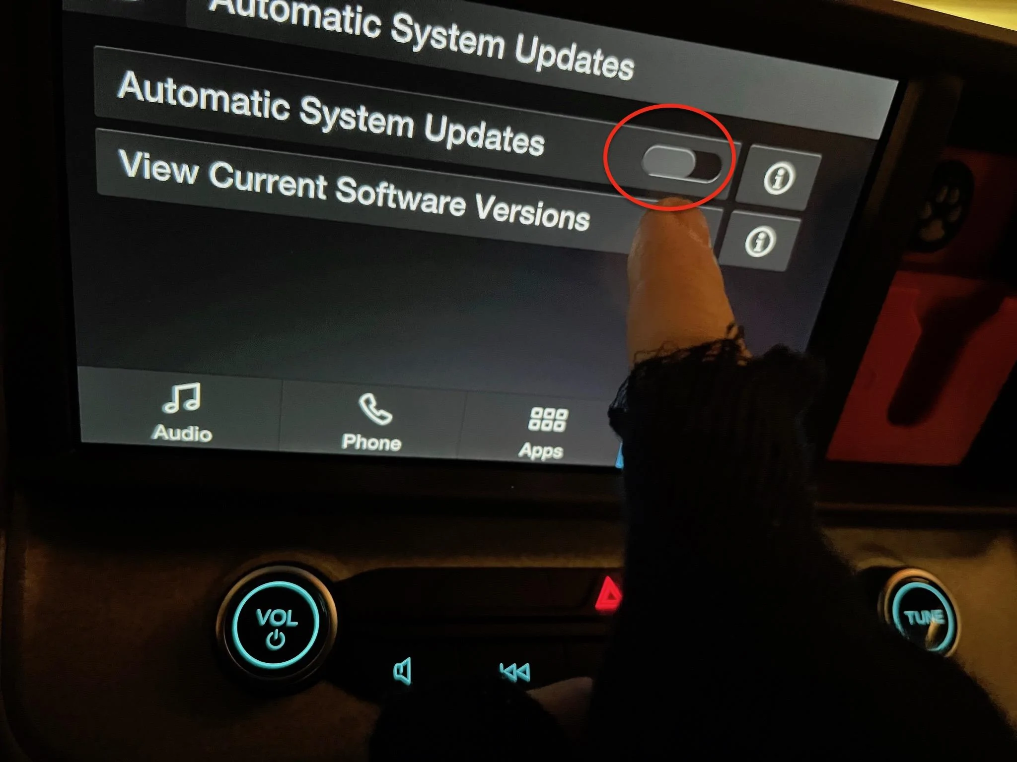

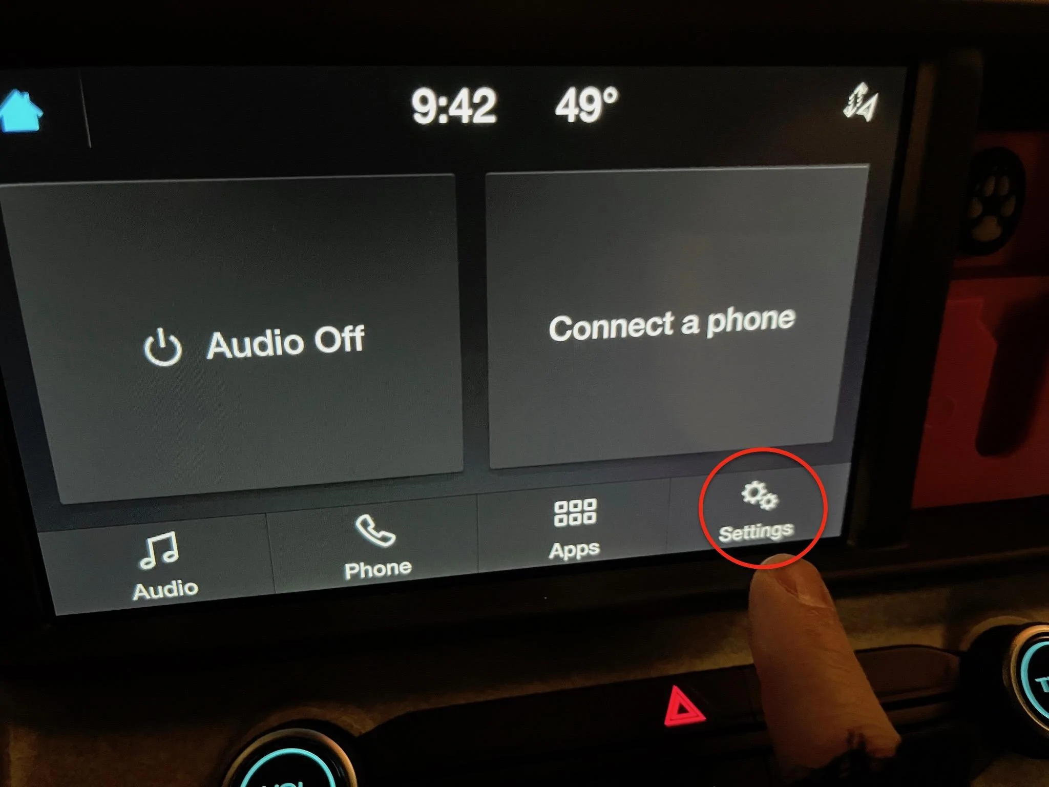

Here you go - see screenshots in order.

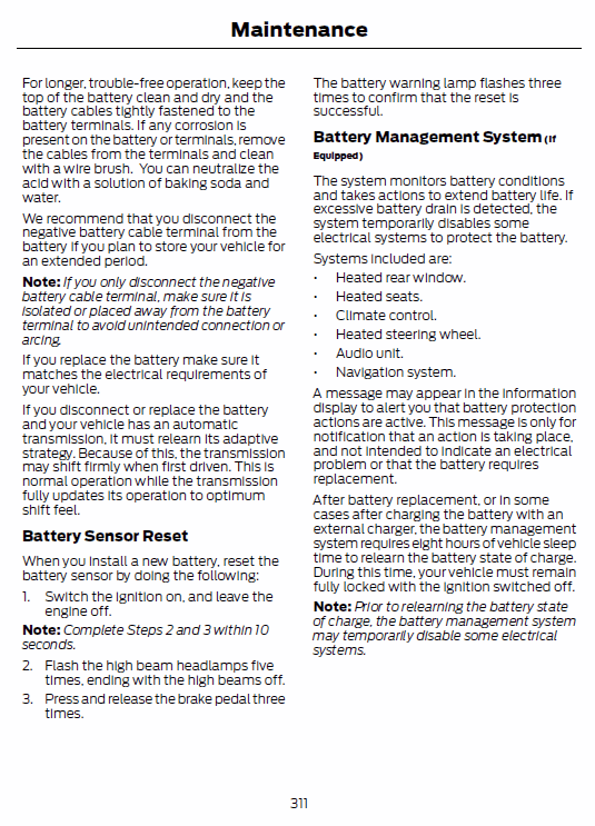

I tend to think it is a bad battery. Im over 14v while the truck is on but pretty much as soon as I turn it off it drops to 12.2
Same with mine, goes to 12.2 almost immediately. I was planning on taking it to the dealer and "requesting" a new battery(different model) another user posted here that fixed the issue.
However, after charging the battery overnight and resetting the BMS, I got the Deep Sleep message one time. I have not gotten the Deep Sleep now since the 16th of January. If I get it again, I will go to the dealer, just need to find the thread where they posted the replacement battery model #.
Edit: Here is the post, replacement battery listed in 4th post, Ford Motor Company BXT-99RT4-A
Deep Sleep Mode FIXED after 6 weeks! Solution: 12v Battery replacement | MaverickTruckClub - 2022+ Ford Maverick Pickup Forum, News, Owners, Discussions
