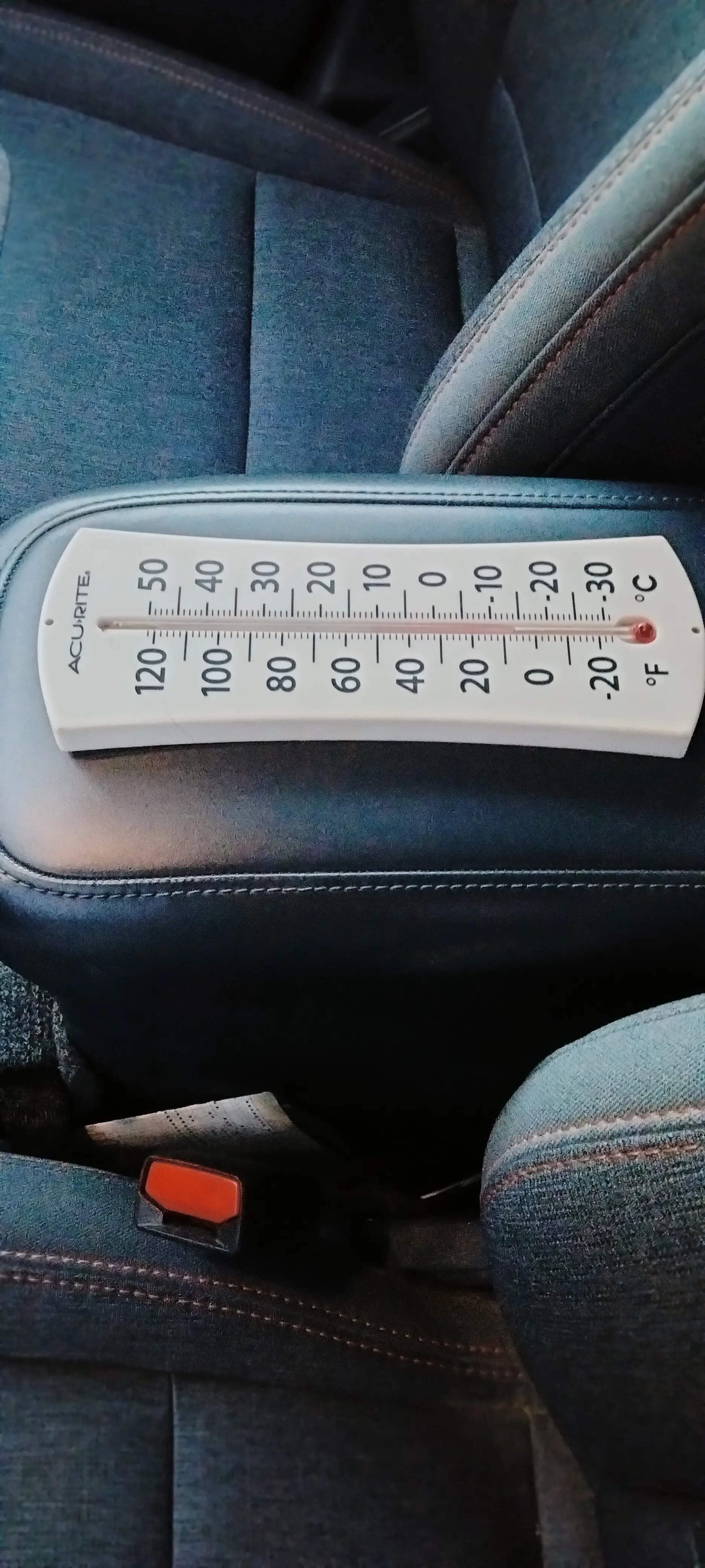

If I wanted to check the accuracy of the climate control system in the Maverick. Where would the best place be to mount a physical thermometer to check and verify the the auto function of the climate control system.
Ford Maverick Automatic Temperature Control issue - anyone else? IMG20251213162047
