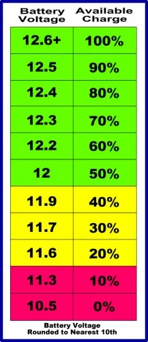

Here's a chart that shows battery charge state at various voltages for a lead-acid battery:
Ford Maverick Issue: Automatic Dome Lights Not Functioning BatteryVoltageChart
So if you're reading 12.2 volts, the battery charge state is roughly 60%.
Note that this is with the engine NOT running. (For Hybrid, vehicle is turned OFF.)
Thank you Jim. That chart is awesome.
