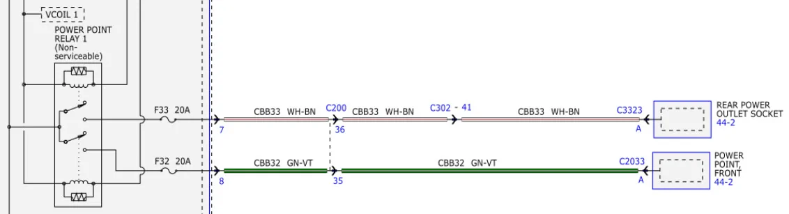

It seems the cigarette lighter shuts off its power after the car is off for a while. This is also one reason why a dash cam had to be hardwired if you want parking mode.
I would like to see the wiring diagram
Yes, after about 90 minutes. I was going to use the cigarette lighter to power my brake controller for flat towing. Had to wire one directly to the jumper post under the hood.

I do not think that is necessary, just back into the cigerate lighter I think would work
The cigarette ligher socket would have to be a constant on for the solar charger to work longer than a minute.
