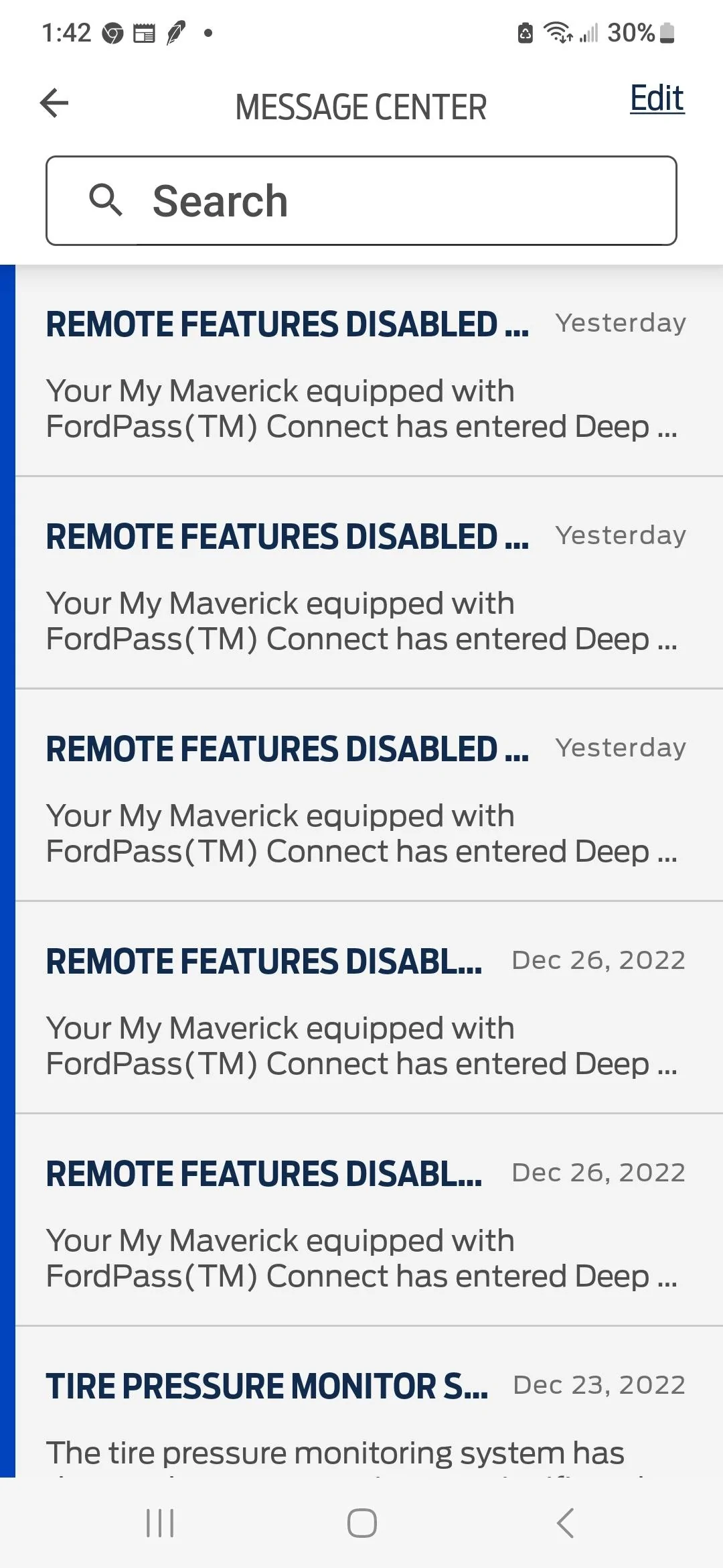

Ive had the deep sleep more during this cold weather. The weird thing is that it starts just fine with the remote start on my fob ( Lariat )
