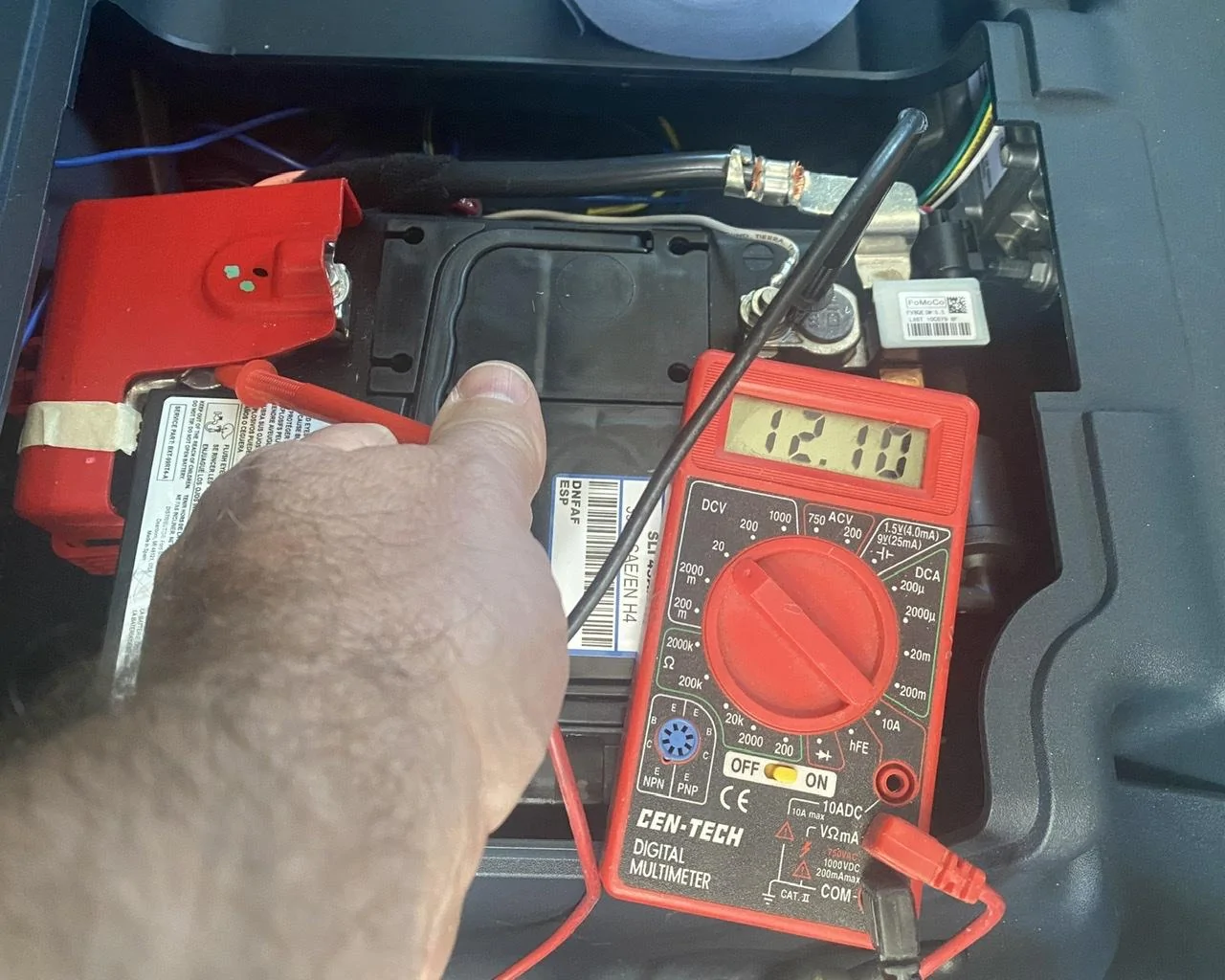

I can charge with key on at 14.6 to 15.2 volts on mine all day long, the next morning (like 16-17 hours sitting) it's down to 11.9v. Or 11.8 volts.
I just turned off WiFi in mine. i have never used the on-board wi-fi but was one of the "lucky ones" to get it as a standard feature before it was deleted on later builds.
Gonna let it sit a whopping 48 hours and see if the resting voltage is better than 11.9.

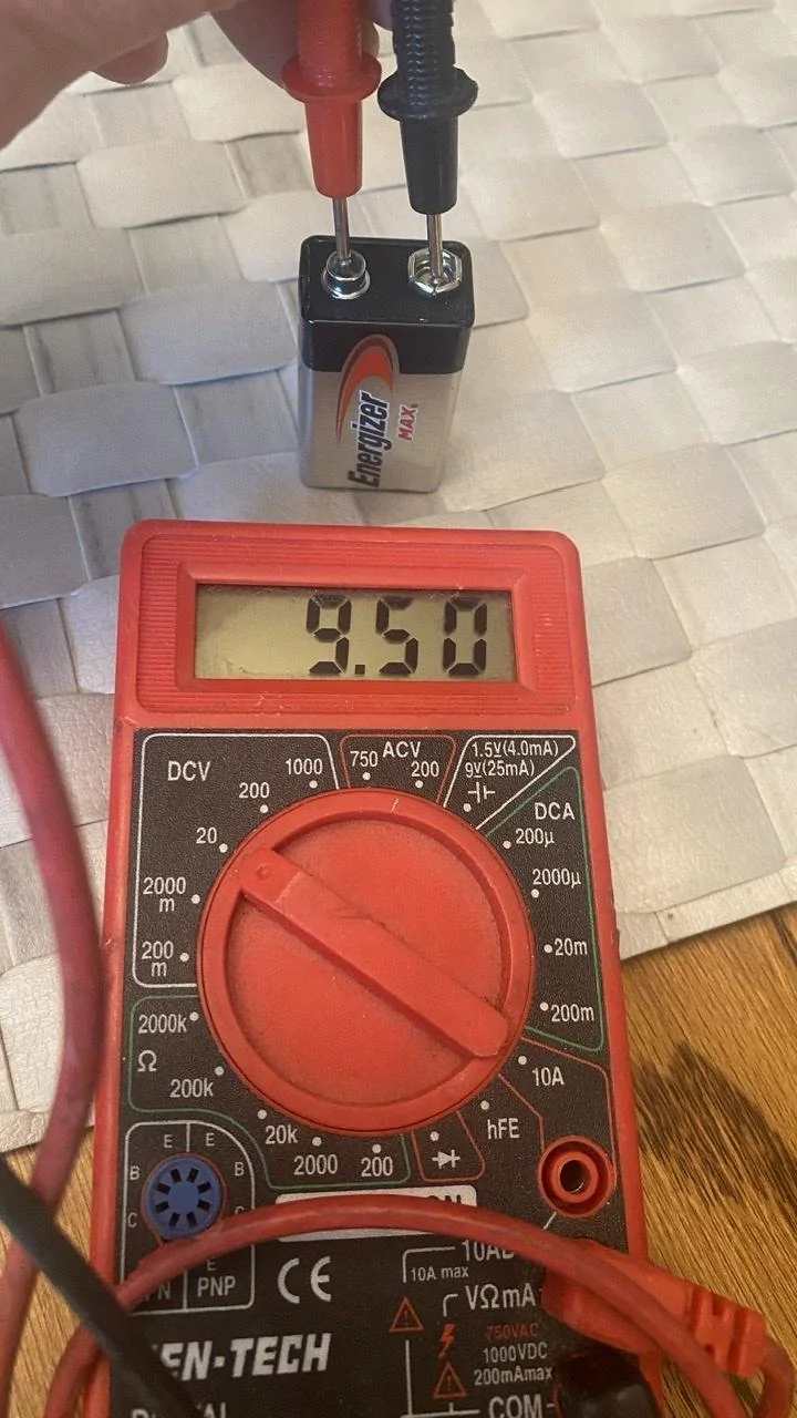

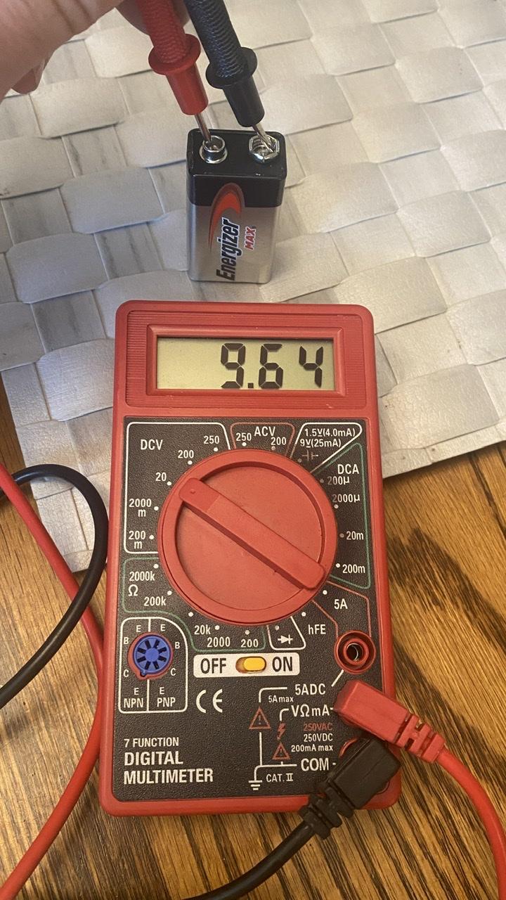

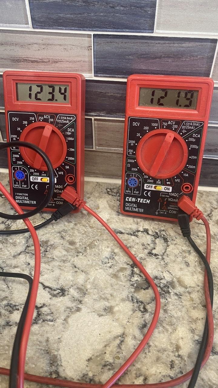

I let it sit for two whole days with WiFi off. I used two cheap meters and one OBDII scanner. Here's the voltage after hours of charging at 15 volts before parking. Up to you which meter you want to trust. CEN-TECH was consistently a little lower, but matches pretty close to OBDII

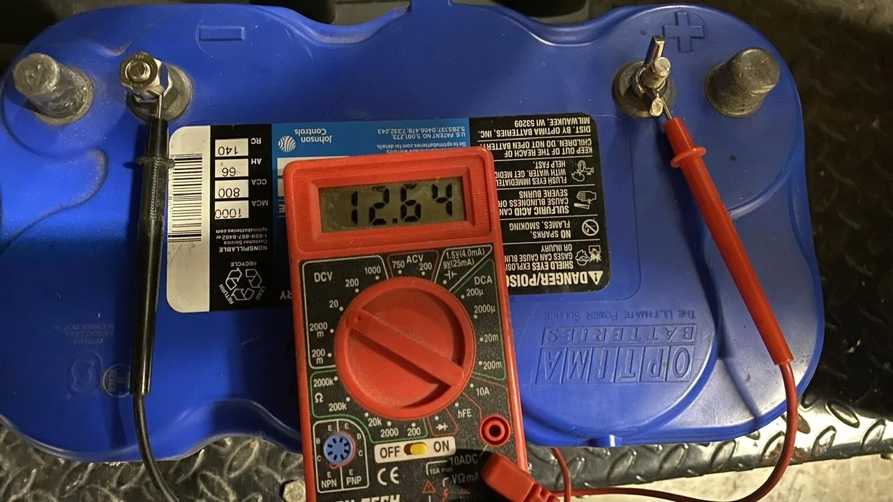

Optima Blue Top AGM
8+ years old.
First 3 years I used it for a small electric trolling motor. Would run it down to about 11.8 then charge it back up overnight.
The past 5+ years I use it on a 3500# winch on a flatbed trailer. Since moving it to the rarely used trailer I only put this battery on a charger about twice a year: Spring & Fall.
At 8 yo this is the resting Voltage.
So why does my 8 month old mav battery rest at 11.8 to 12.0!?

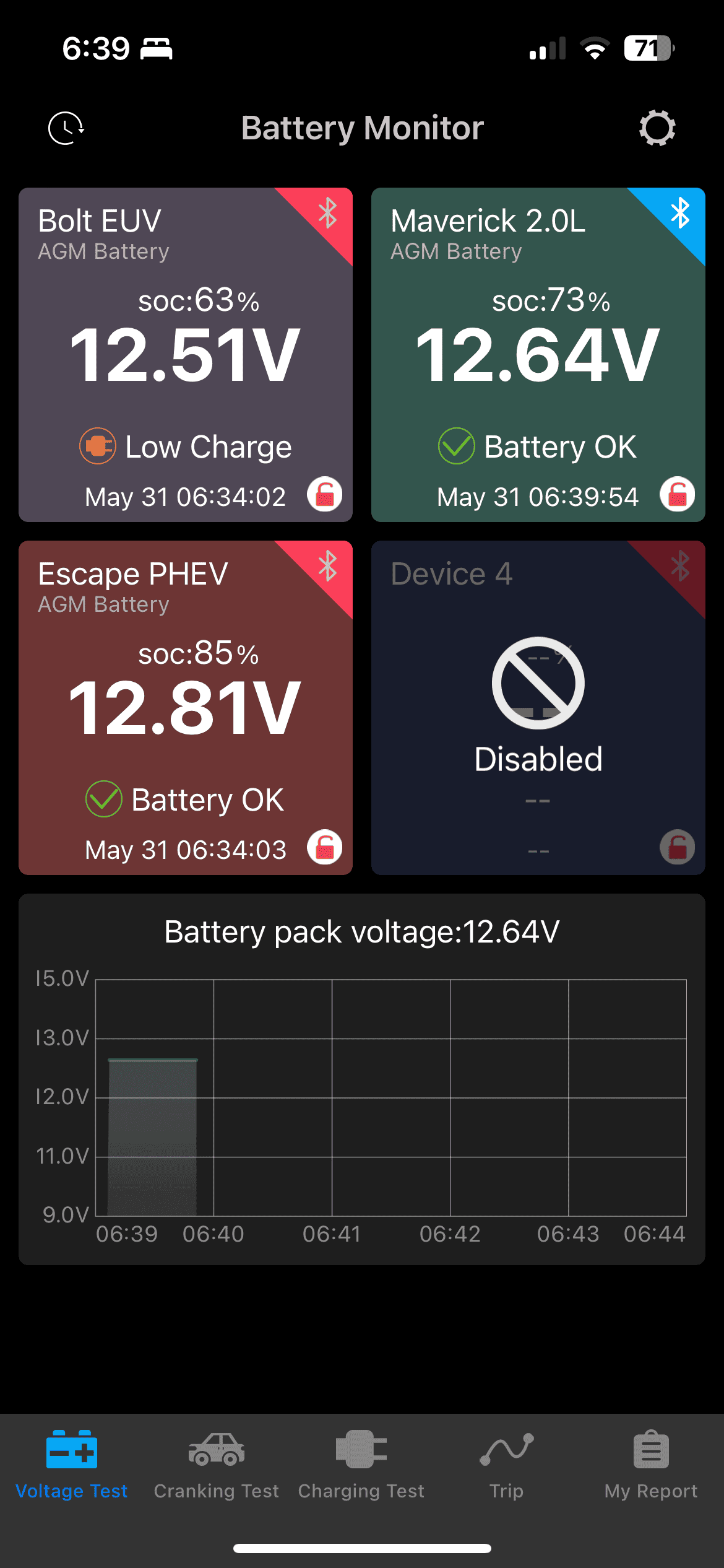

I've been watching my Maverick 2.0L AGM, Escape PHEV AGM 12V batteries with BM2 battery monitors.
Maverick's is OEM Group 48, truck bought 2-2023.
Escape's is Group 48, bought the battery 12-2022 & installed in place of OEM Group 99R FLA.
The Maverick was driven yesterday for couple of short drives.
The Escape has been sitting, I charged its AGM battery yesterday.
Screenshot of the batteries. The one labeled Bolt is actually the Escape's OEM FLA battery like in Maverick Hybrids. I haven't connect the BM2 to my Bolt's AGM yet.
Ford Maverick Hybrid +12V Battery Replacement Escape AGM, Maverick AGM, Escape OEM FLA - 2023-05-30.PNG

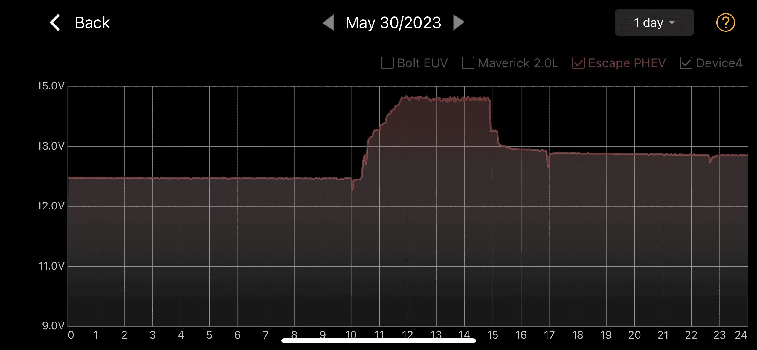

Escape PHEV's 12V AGM battery for 5-30
Ford Maverick Hybrid +12V Battery Replacement Escape PHEV - Charged w Deltran 2023-05-30

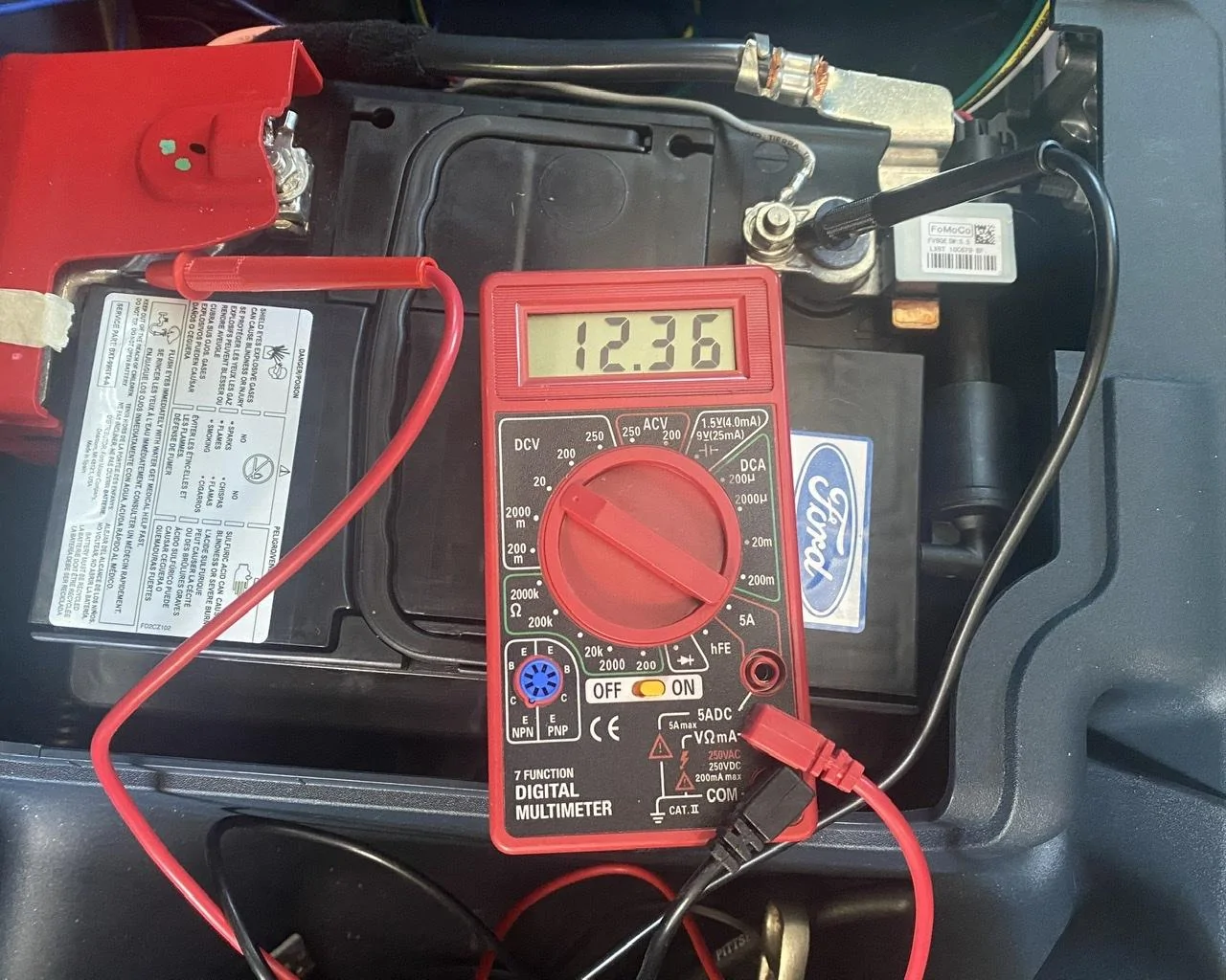

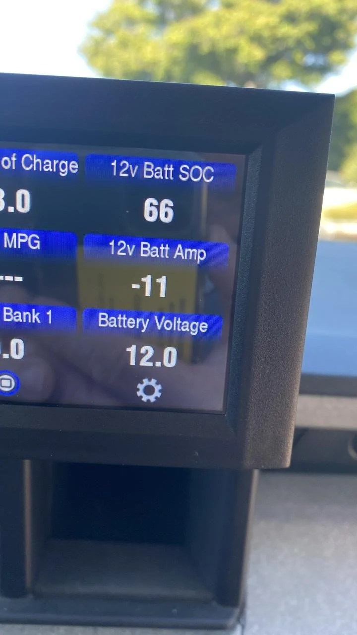

Some more observations:
Drove home an hour or more with low voltage side showing 15.0 volts +/- 0.2 volts the whole trip. At start, 11 amps going into the 12v battery. 2 min later 7 amps going into the 12v battery. 2 min later 4 amps going into 12v battery. 2 min later zero amps going into the 12v battery. Voltage stays at 15.0 whole drive. I assume truck assumes the 12v battery is all topped off.
I get home. I don't lock the truck. I play with my dogs for 45 minutes.
No key in ignition, no key in pocket, nearest key is in house, 75 feet away, in a cast iron dutch oven. Safe to say no key is secretly communicating with truck?
I open the unlocked passenger front door. The parking lamps or "welcoming lamps" come on, truck bed lamps (stock) come on. Interior dome light comes on. Ford logo on Radio display come on. OBDII scanner comes on but gets NO DATA just power. Is the truck considered "awake"??
On a hunch, a minute later I open and close the DRIVER door by just reaching over. I don't get out of the front passenger seat. Same response only now the OBDII scanner is alive and getting live data (temperatures, volts, amps) from the various modules in the truck. Is the truck now considered "awake"? In my opinion, yes.
It is consuming power, no doubt.

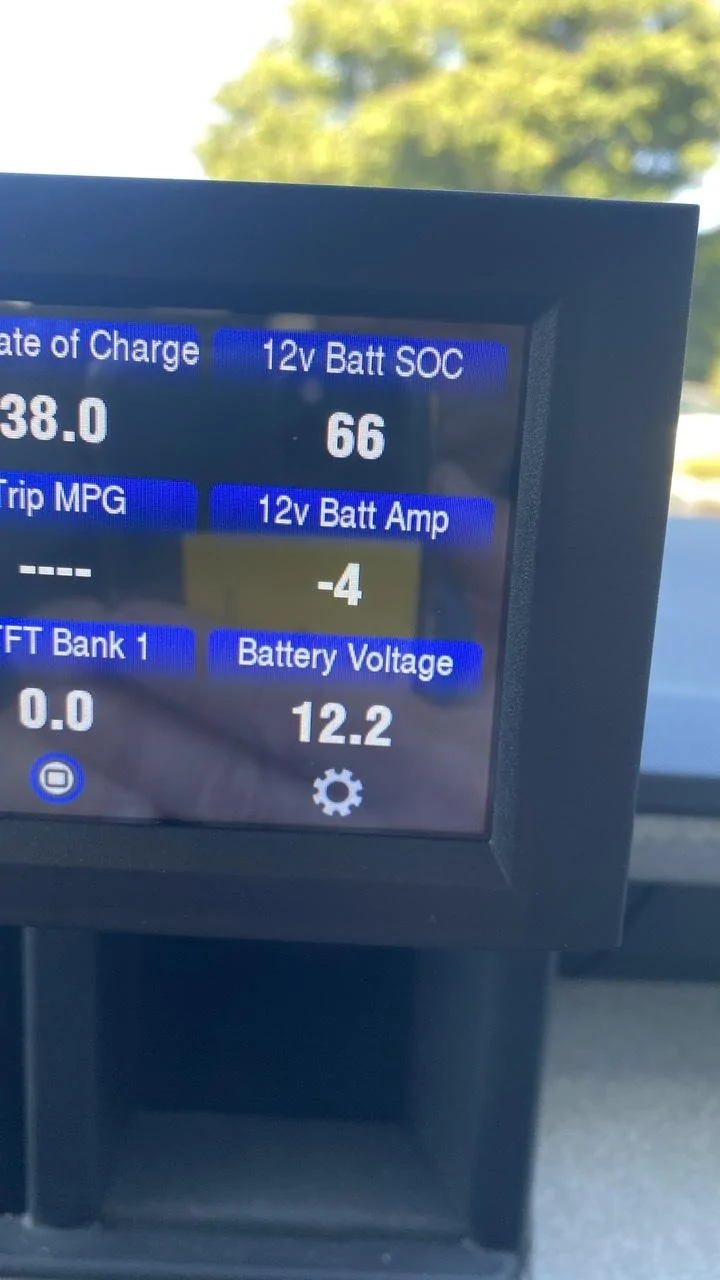

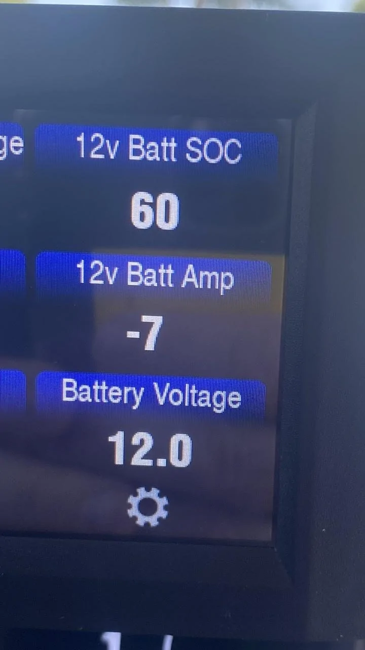

With dome light and "welcome" lights on, it's drawing 11 amps out of the 12 volt battery. After sitting still, and waiting for the lights to "time out", once all lamps are off, there's still 4 amps coming out of the 12v battery.
No matter how much charging time I give it, it's at 12.2 volts in this state. And 12.0 volts with the welcome lights on. And 11.8 or 11.9 volts just "resting" the following morning.
So those in flat tow mode, beware, it's pretty simple to "wake up" your truck and draw down a lot of 12 volt juice.
No key, 45 minutes after a long trip of charging, welcome lights on:
