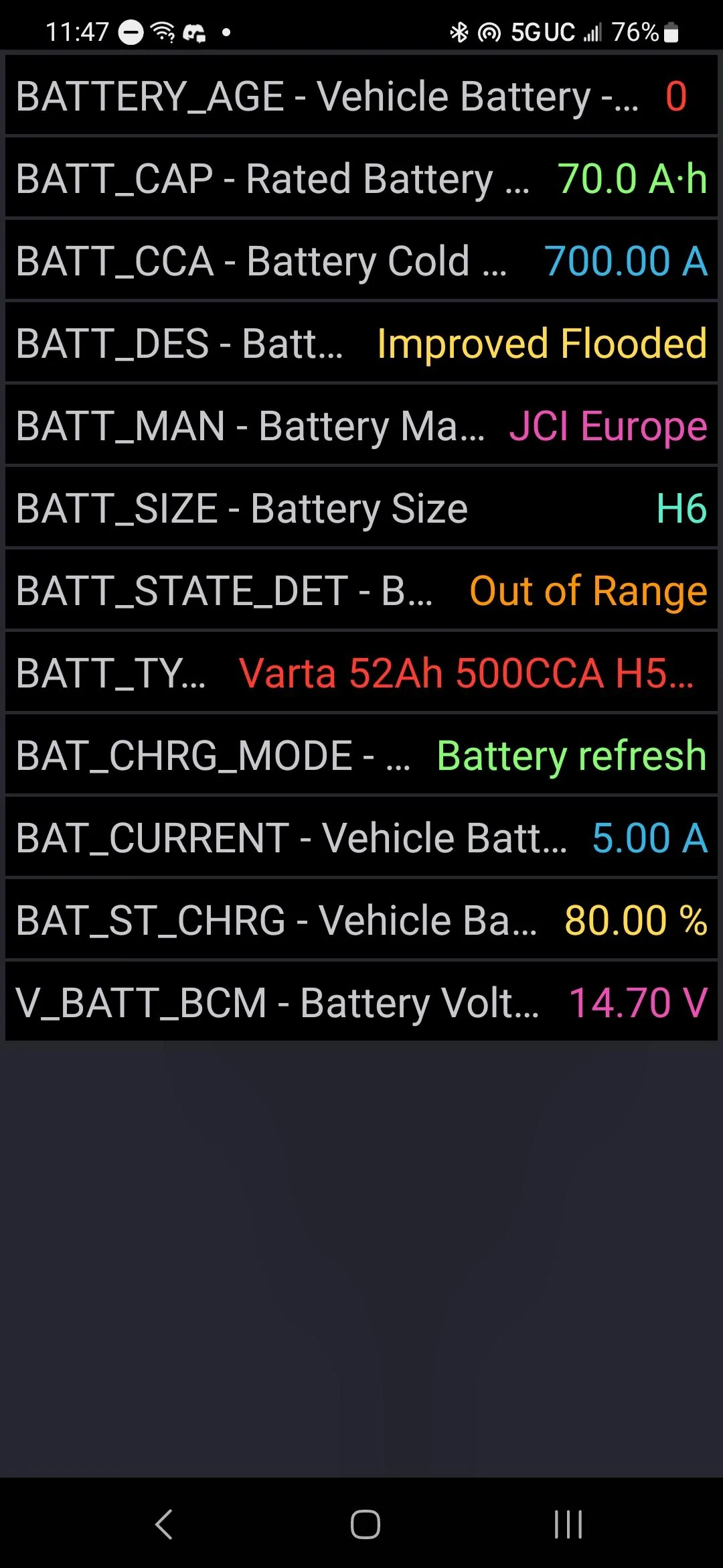

For the most part I have not, and that may have been an error on my part. BlueSpec seems to be having better luck with his settings.
It's still an H4 battery, 45AH capacity, and the charge type is set to AGM (Stock setting, thanks Ford!).
The one thing I did try was increasing the target SOC to 92%, up from the stock 80%. Didn't seem to change anything. The truck ignores the target SOC level, and that might be part of our issue. Regardless of where the battery is relative to the target SOC, the charge amps do not seem to increase. I'll sometimes see it pump more amps into the battery, but it doesn't seem to drive off of that. Not sure what the trigger is.
When I set my battery type to the Varta 52AH option, Forscan lists a 70AH battery instead. I don't know which is accurate, so I've avoided the battery type options until now. Charging mode also seems affected by this change, I see "Conventional Charging" while I'm driving currently, with the other type selected it seems the truck stays in "Battery Refresh" mode. No idea what the difference is, but I've seen it in my and BlueSpec's screenshots.

Thanks for sharing. I guess I’ll stick with Bluespec’s settings.
I haven’t even owned my truck a year and it’s spent a combined total of multiple months at the dealership for this issue with no fix. It’s so frustrating that the ford engineers can’t figure it out so we get left guessing how to resolve it on our own.
On another note, what app are you using in that screenshot? Is it forscanlite? If so, can I use that to make changes to my battery settings instead of my laptop?

I don't know what kind of process they follow over there for diagnosing or following up on customer complaints, but it's pretty clear there is zero follow through. For as many of us who have this issue, you'd think someone would have found a dealer/engineer who cared enough to find the root cause.
Anyway, yes, I'm using FORScan lite. Can't make any changes through there though. You have to use the desktop version for that. I keep my phone paired to a OBDLink MX+ and monitor battery level, charge amps etc. with the app while I'm driving. It's convenient for staying on top of what the truck is doing.
