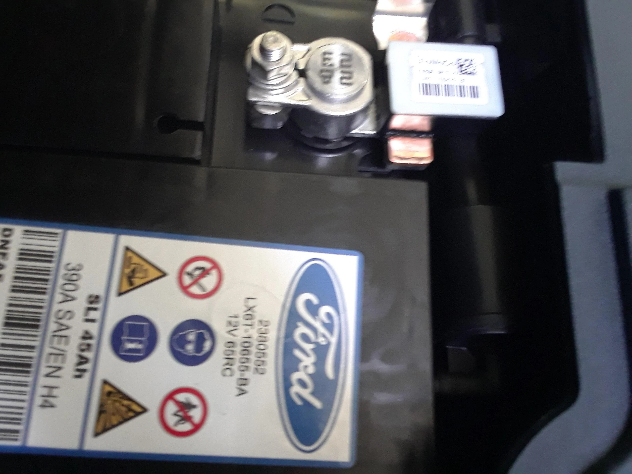

what is the model, group size. I'm looking to find that battery you got on-line. I noticed the existing
12v battery under back seat has a tube coming out of it and then a vent tube is connected to it.
You will need to enlarge pic maybe a bit larger to see it. You can see the tube right of the battery.
So i guess battery you bought had the tube coming out of it.

Did you see the vent type looking tube going into the battery? And the gray sensor going to
the negative terminal. Isn't that the sensor that maybe drawling down power.

I looked at the battery under the seat and saw a tube coming out from it with a rubber vent tube going over the tube coming out the battery. Did the duralast have that tube coming out from it.
See the picture attached. Look to the right of the battery. I don't see batteries with that tube that i have searched on line for. Can you give me a bit of explanation

It had the connection, I just use the existing vent tube.
Did you install the battery yourself?

John as far as vent tube extending out from battery. Do i just give it a gentle turning tug
to release it so i can put it in the other battery?
