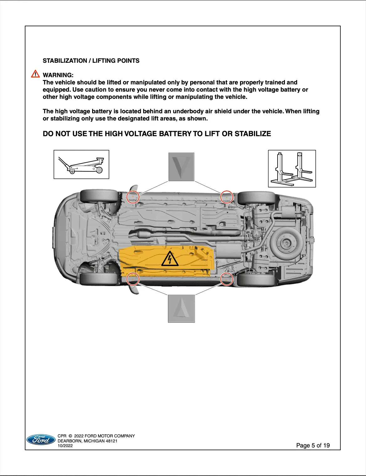

Lithium battery is located under the truck. 12V battery is under the rear seat.
jsus
Dec 20, 2021
2,883
3,883
2022 Ford Escape Hybrid AWD
Specifically, the Lithium-ion HVB is in the floor between the front passenger and rear seats.
