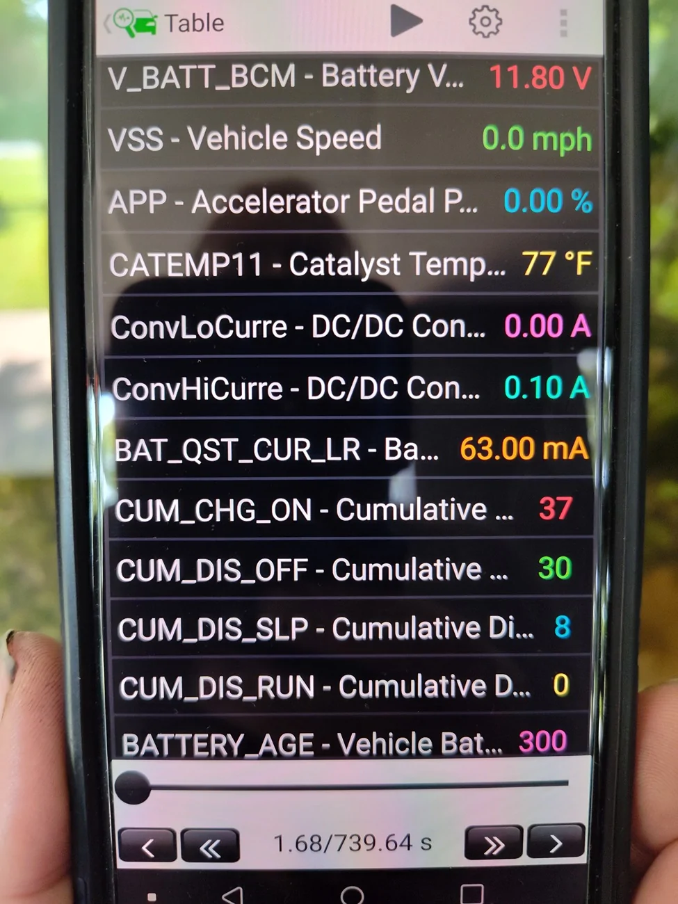

Here's what my BMS system thinks of my battery on Monday when it reached 300 days installed, in max battery save mode due to resting voltage 11.8.
The BMS has logged it's been charged the same amount of Amp hours it's been discharged. (whole figures from rounding likely add up very close)
And I have had 2 self-inflicted bad drains to 35% SOC in there due to doors open/lights on - and it recovered from both of them - to the same undercharged state it was in beforehand.
If there have been battery drains related to ACCM or brakes or other - there is no indication of it because the system has the ability to charge very high and long to recover - to it's programmed strategy of undercharged.
Am I having Zero issues because it still starts the truck?
It ain't going to make it 3 yrs - that's an issue in my book. And no lights for more than mere seconds - that's an issue.
And there have been posters that got your SSM's - and still had the issue THIS thread is talking about.

Regarding what you think my issue is - it's the same issue many see that don't have a bad battery die overnight.
The BMS system using the battery sensor is reading ALL Amp hours going into and out of the battery.
And it sees balance.
If DCDC was undercharging - it would show less charge, more discharge.
And if I had short/partial discharge events from the ACCM or ABS - there would be more discharge then charge. Except if you drive long enough, it can recover.
Now - I do think I have a bad battery sensor and it's getting inaccurate Amps IN/OUT.
But I can't prove it - when I put a multimeter in DC Amp mode inline with the negative cable - the BMS must not see enough resistance or something - it drops to no Amp charge to the battery.
I cannot confirm Amps to see if the battery sensor is correct.
It does report the Volts under the true value, but that's better than reporting a higher than true value at least.
Since you have a long drive into work - you could probably do the above test during a lunch drive borrowing a scanner - you should be about as charged as you'll get.
