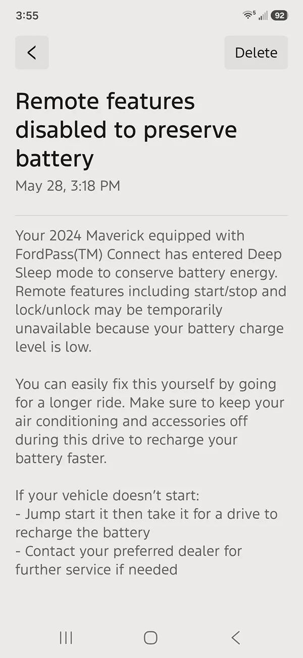

Just when I posted that my 2nd new battery had seemed to be holding up, l got a notice today. Sat for basically 1 day without driving. See the attached message of near death experience. It did start this time.
I'm going to drive cross country today. All to charge the battery as the app advised. LMAO......there goes the gas mileage due to required Ford Charge Driving......FCD requirements, a new Ford term.
PLEASE get the ABS and ACCM updates done and share with us if it worked short and long term. I don't know if anyone has had the most recent updates performed to see if they actually work. Right now we're debating what we think will or won't work

The other parasitic drain, the one that happens as soon as the (mostly? hybrids) vehicle is turned on - causing the DC to DC converter to kick into action!
This parasitic draw is huge! Enough to drop my 2025XL's 70mph gas mileage from the 36 -37mpg I am currently seeing, down to the 30mpg I was getting before the trailer module update!
The trailer update has fixed this huge parasitic draw! Just like the ingenious "headlights on, wipers on, parking lights on, rear seat 120V outlet usage, and hitch brake light on" hack has been shown to circumvented this same parasitic draw!
The TMU came too soon for me to test whether the hitch light etc. would have increased my highway mpg, in addition to normalizing my 12V battery charging!
I hope someone who hasn't had the TMU yet can test that.
How can a parasitic huge drain reduce gas mileage?
Easy, the motor generator has to work at essentially 100% output (for it's given engine speed?) to satisfy the parasitic electrical drain.
Why doesn't the battery get charged?
Likely, the vehicle's electrical systems' "need" has first dibs on the electrical power supplied by the DC to DC converter, so the battery gets starved...Until higher speeds and longer drives allow the motor generator to finally supply enough electrical supply to satisfy both vehicle needs and battery charging!
That's it!
