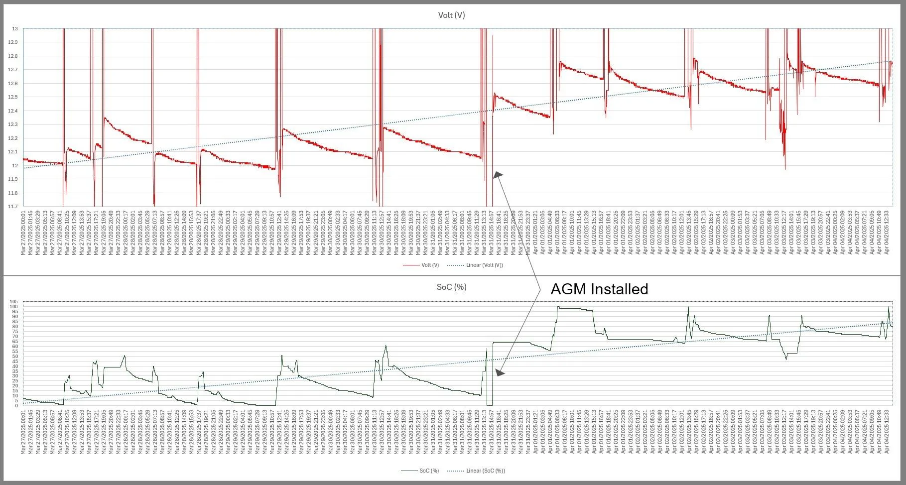

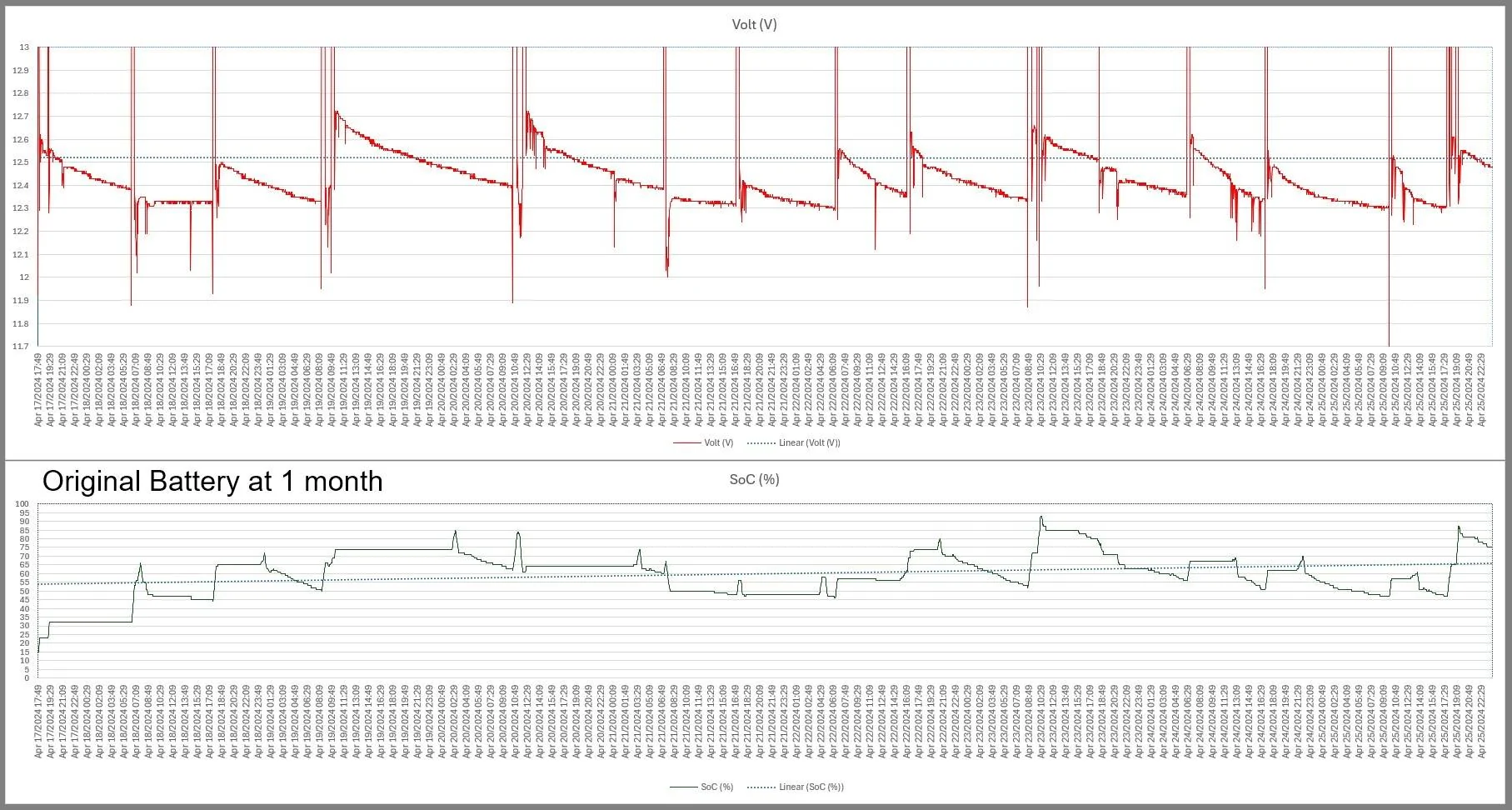

So, at almost the one-year mark I replaced the 12V battery on my own dime. I did take it to Ford to check and after charging it up they told me it was fine. As soon as I parked in the garage after driving it home it went back into deep sleep.
Here are two graphs, one is 1/2 the old battery chugging along beardly alive and the second 1/2 the new AGM. the other graph is the original battery one month after delivery (almost exactly a year ago). The old battery a year ago almost mirrors the new AGM although the average voltage is slightly lower as is the SoC. I guess time will tell if the new AGM holds up better...

Assuming you fully charged your new battery; did you also do a BMS reset and leave it parked & locked for at least 8 hrs?

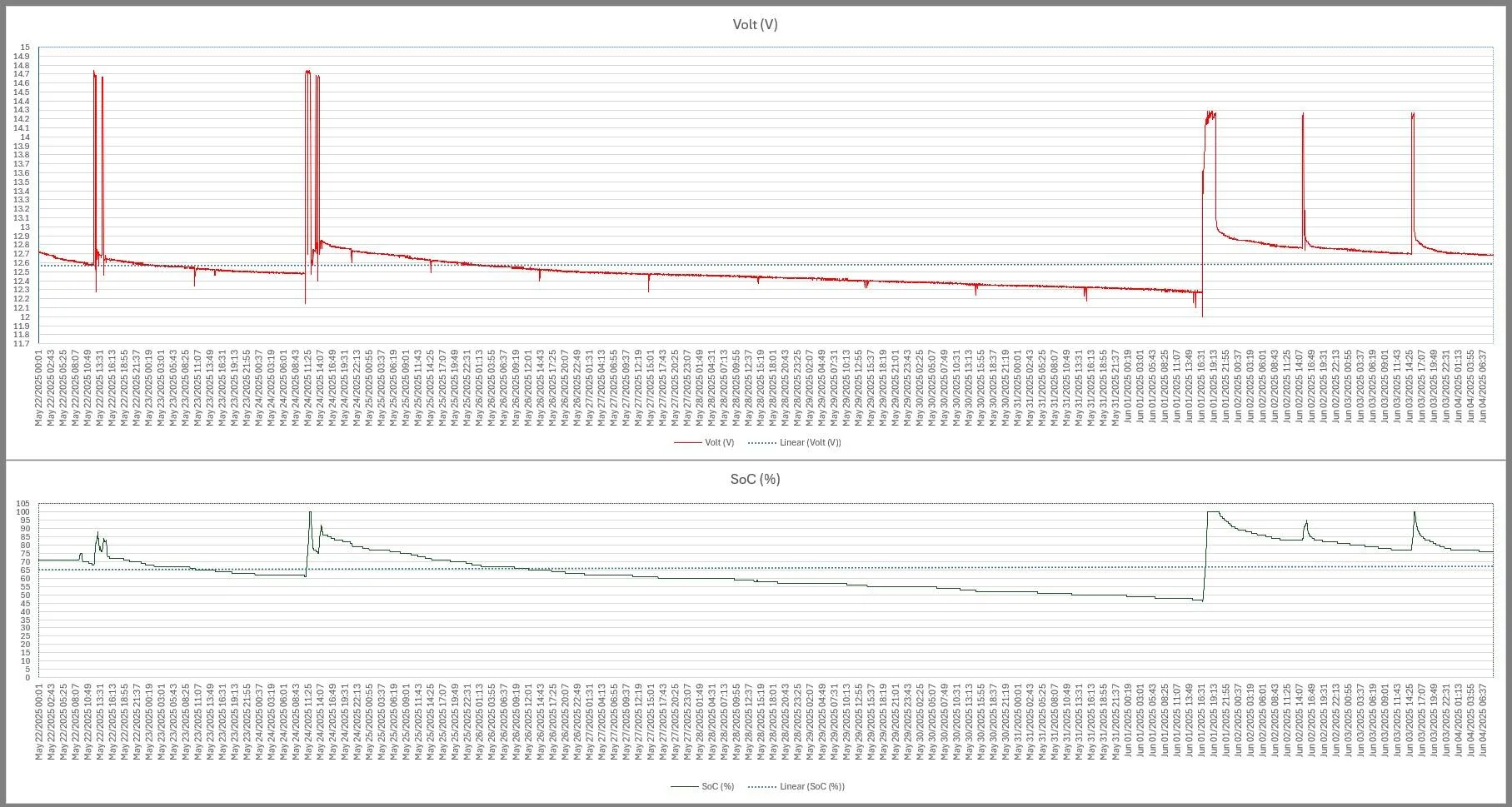

Well, a lot has happened in the past 12 days... The main thing for this topic is I ended up having to suddenly leave my truck unattended for 8 days. During that time, it continued to communicate with the app. When I got home, I almost immediately put it on a maintenance charger. As a reminder I put in a new AGM at the end of March. Here is the data it saved.
I am not allowed to drive at the moment, and whether I ever can drive again is currently in flux at the moment. Right now, it's mostly a waiting game. At some point I may have to start convincing my wife the truck is her best choice of the two vehicles...

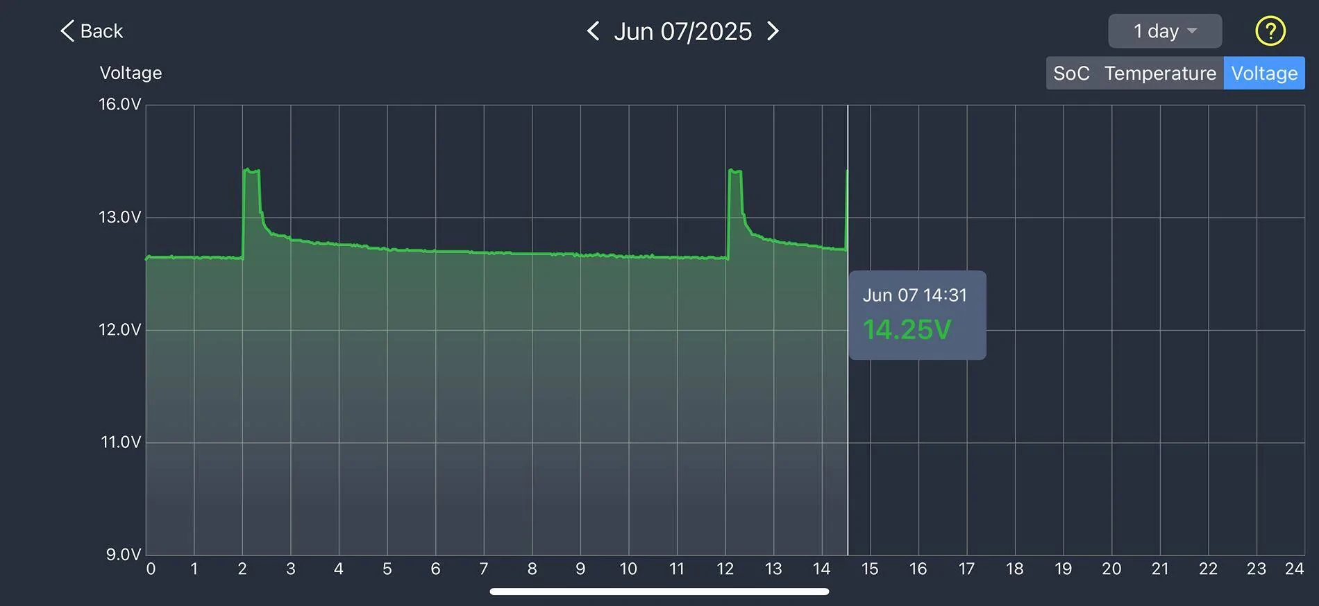

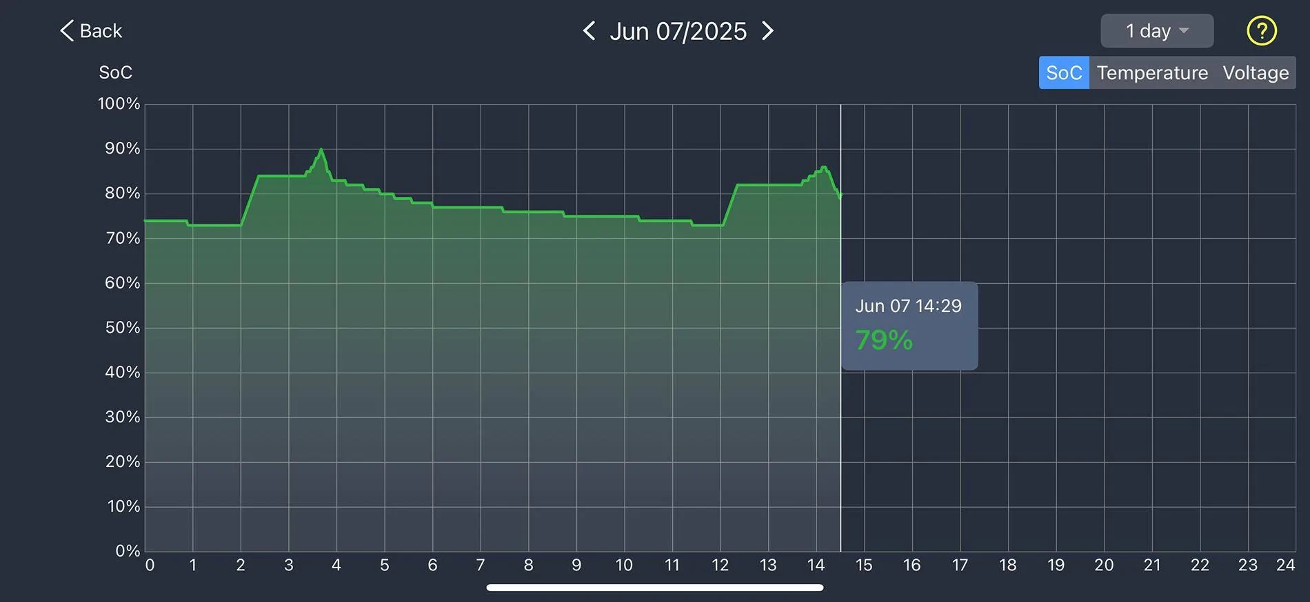

So I was sitting eating lunch and my Ford app popped up the all to familiar “Remote features disabled…” message. I am thinking huh, it’s on a charger. Then I realize it is 2 weeks to the minute since I last drove and parked my truck. Seems it does not care if the battery is fine if the truck is not used for 2 weeks. I don’t remember reading about this anywhere? Also interesting as the charger was working at the time. I will probably open the garage and run it a bit…
