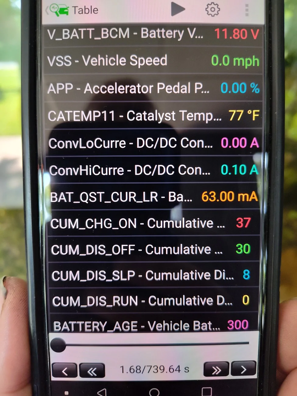

Ford has funny ideas about what a fully charged battery is. They mark 80% as 100%, and it never gets anywhere near 100% ever. That's why EFL batteries are only lasting 1 year and AGM only 2 years instead of the expected 5 to 8 years.
If you don't believe it, disconnect the battery after a long drive with the lights on and measure the battery with a known-good meter after the normal 12hr soak. Its not 13.2V or 13.4V like it should be, its only 12.1V to 12.4V.
85% on SLA batteries.
Seems 92% on AGM.
With no programming change required!
80% on SLA is when the float charge starts, close to 1/2 Amp.
87% on AGM I recall it being noted.
Of course - once it's lost it - throw that 80/87% out the window - the goal has changed.
Never mind full change, whatever it takes to keep it at a happy 11.8 V it seems for me!
This was 51% SOC after having 54% last night on park.
300 day battery. And it reached this low actually logging it thinks almost equal charging to discharge Ah's seen. Which I guess makes sense, if a fully charged battery sat for 300 days no connections - it might drop to 11.8 V. (come on BMS - do some Management and charge more for the self-discharge that occurs)

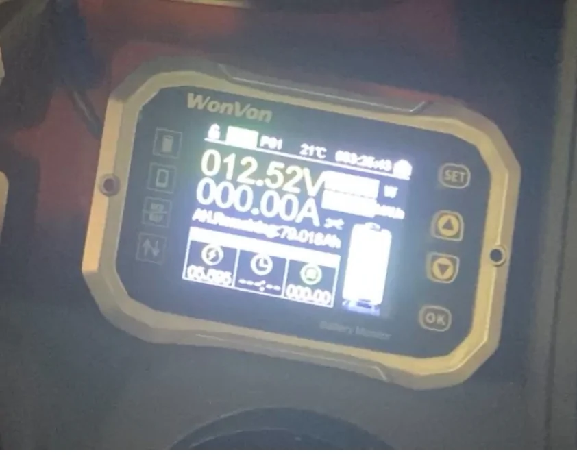

That looks like way too much work, I have a easier way.
I just look through the window.
And by the way, the WonVon unit is powered from a separate battery.
Good day
Nice indicator, and it shows amps as well! I have been looking for one like that but no luck so far.
Just a note, when you can see the voltage after the truck is shut off, you aren't getting a true reading as to the battery actual charge level.
It is showing the voltage with a small load applied.
To get the true voltage reading on the battery you need to wait for the 90 minutes to pass, and all power demands are removed...and then wait a bit more for the battery to "relax".
I do the same thing as you of course (my indicator sucks...it only shows me voltage ;-), I just peek through the side window to see what the voltage reading is.
Of course, the most accurate place to read the battery is right at the battery, but if you can compare the 2 readings (boost points under the hood vs the battery itself) and remember the difference you are golden!
All this is work of course, and if you aren't having any 12 volt battery or charge issues, why would you do all this, eh?
Would love to see details on how that was installed - it comes with it's own shut. How do you keep it's (auxiliary) battery charged? Where in the truck did you mount the display?
There is another battery under the seat, and a smart battery charger plugged into the 115v outlet.
The display is in front of the shifting knob.
What about the shunt? Is it between the BMS sensor and ground or connected to ground after the BMS sensor?
