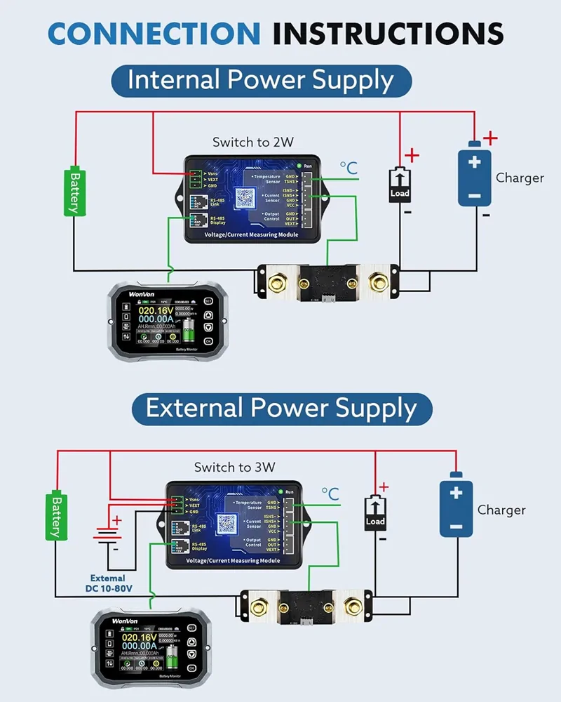

Would love to see details on how that was installed - it comes with it's own shut. How do you keep it's (auxiliary) battery charged? Where in the truck did you mount the display?
I assume it is plugged into the dash PowerPoint and has a separate battery to power it's display and other needs. It could charge it's battery when the buss exceeds more than 13 or some voltage.

Since the description includes an external battery I'm going by the Amazon listing for it which has pic related. I'm just wondering where the shunt is installed for the Maverick setup.
