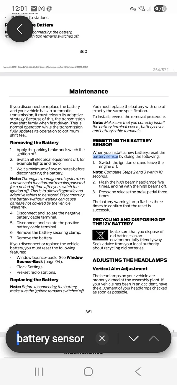

Good day @Suzukiridr14
Don't forget to do the complete new battery installed reset of your truck!
And also, before any battery change, fully charge the new battery with a smart and AGM appropriate charger with 4-5 amps capacity! Then do complete battery sensor reset procedure.
I am pretty sure you are all up to date on what to do when you change the battery in your truck, but there are so may others who may not have read their manual, and may just do as they did in the G-O-D and throw in a new battery.
This page will get anyone looking to the right area in the manual when changing your battery.
Cheers
Andy

May I suggest what I would do/am doing (as I have a camper van that can eat batteries).
Get the new battery, charge that with an AGM appropriate charger before putting it in the truck.
Carry out a new battery installed in truck procedure as per the manuals direction...BMS battery, relearn etc includes flashing the headlights and everything.
If possible, after that when you aren't using it, throw your AGM smart charger on it...I do this with my camper van as well. I set the charger to the side as I leave and when I get home, on the charger goes.
Life is to short and sweet to fight with depleted batteries, and they are too expensive to keep changing them in 18 months!
