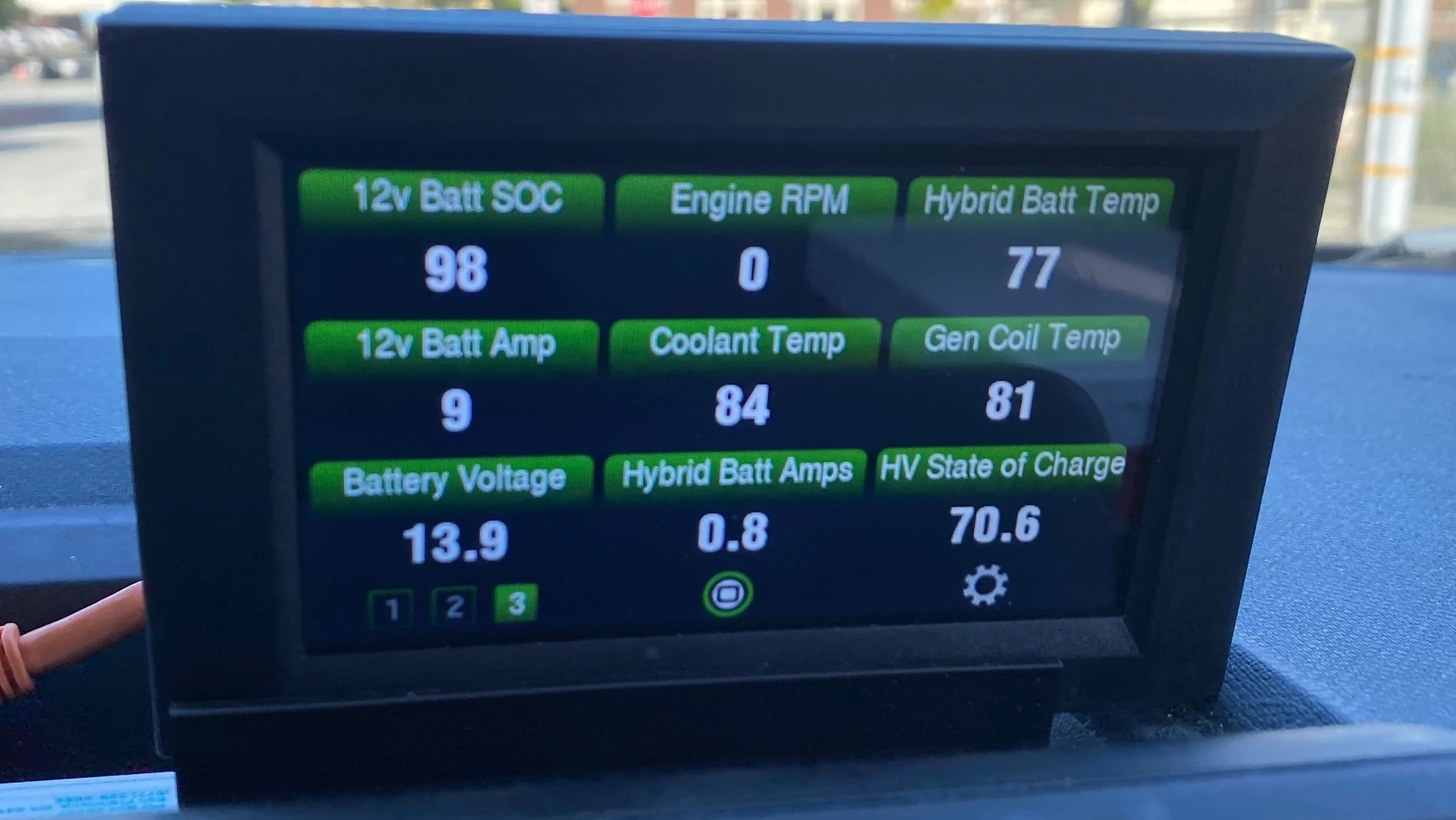

I am getting evidence the charging is modified by ambient temperature. Maybe temperature inside the cab since the 12v battery is in the cab of the hybrids.
10 days in a row, A.M. commute in the 50°Fs. Charging at 14.7 to 14.8 volts.
9 days in a row, P.M. commute in the 70's. (Cab in the 90's to low 100's).
Charging at 14.3 to 14.4 volts.
Today, P.M. commute in the 80's. (Cab while parked 110°Fs).
Charging at 13.9 to 14.0 volts.
(Note coolant matches ambient before starting, 84°F.)
Trailer lamp attachment used all days.
( In lieu of headlamps )
Observed as well under the normal routine.
Really drops fast to low amps when below 40-30 F in cab. Actually, kept a remote thermo under there once - cab warming up don't help much under there at all.
I could never find a PID for 12VB temp, though I'm sure the sensor has one.
I though it was double sad - bad impact to battery when cold anyway, and now less charging amps done, and usually less trips by me. Though longer drives for camping - knew that had to help.
My cumulative figures charge vs discharge is always worse off discharge after winter.
That's nice to see with your method it's still inspired to charge higher amps to get back to 100% SOC.
And at less than about 50+/- you will see 15+ volts. Voltage increase to supply current needed for possible expected needs.
