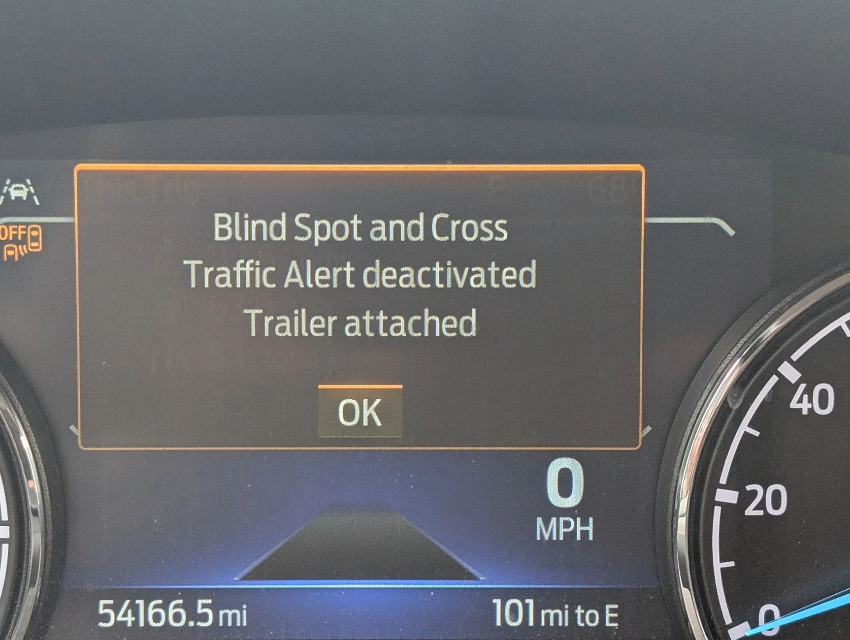

Well I was going to try the brake light in the hitch attachment. Got it in today, but on the first drive I noticed I get the message " blind spot and cross traffic alert deactivated trailer attached."
That's not going to work for me. Is there a way to disable that? Or I guess I should say, enable that with the hitch light in.
In 2025+ yes.
22-24 no.
