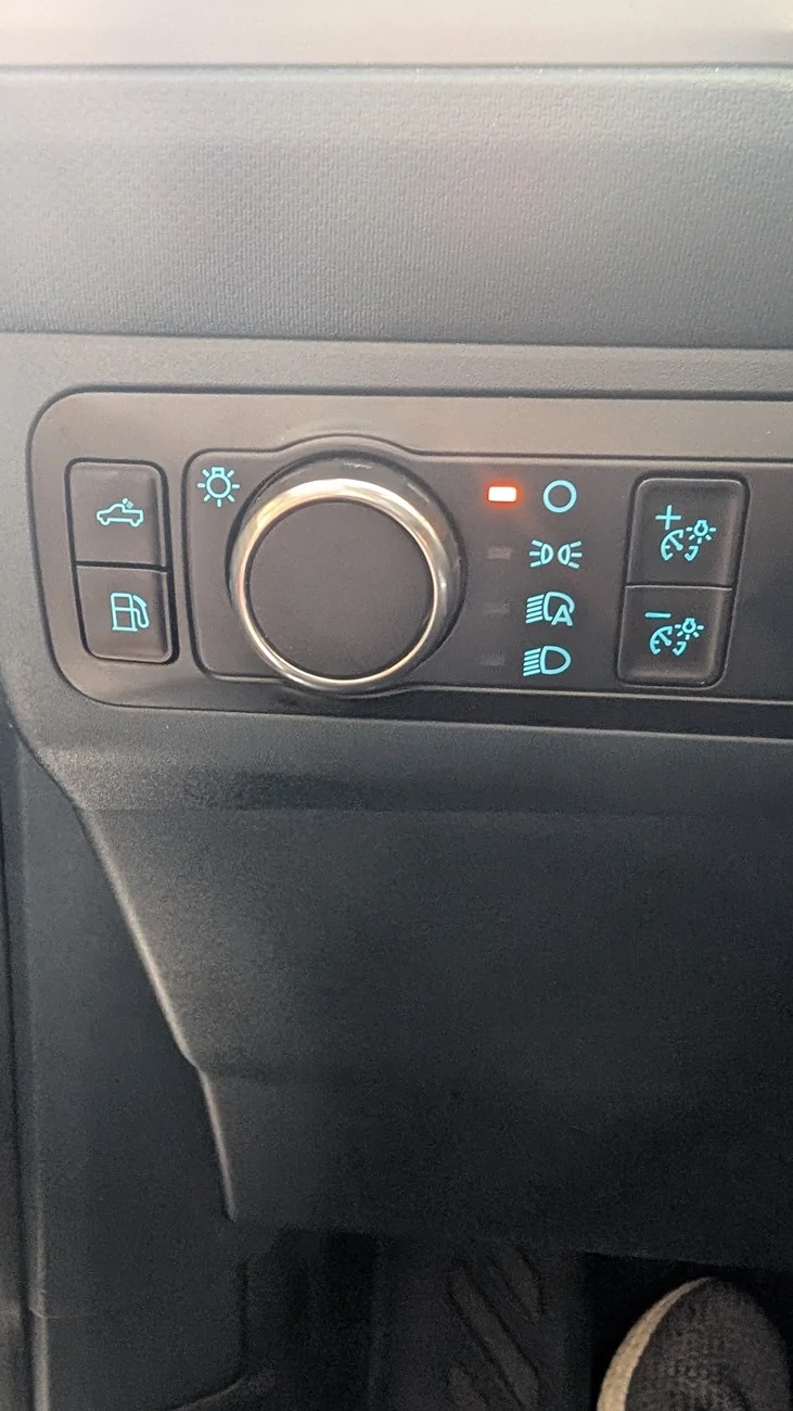

The computer needs to see one or more of Headlamps on, Parking Lamps on; or Trailer lamps on.
That simple. Weird. But simple.

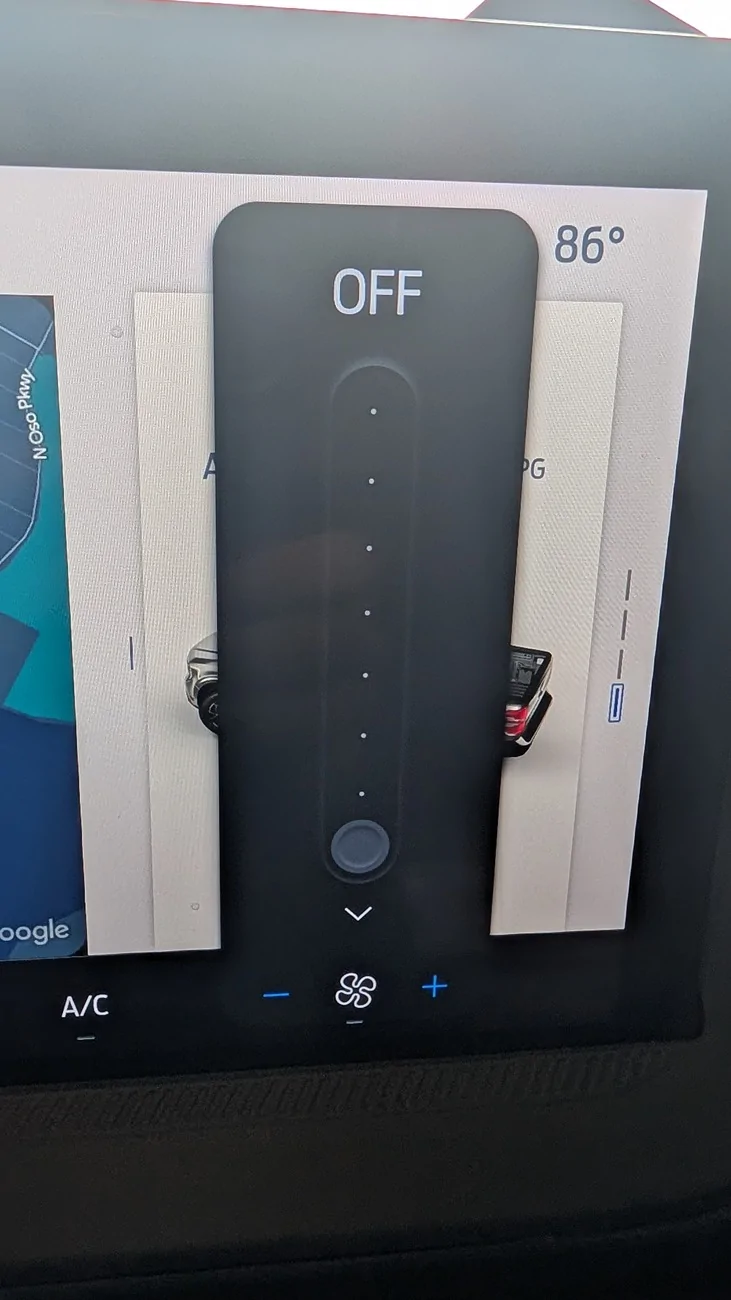

Or fan speed 6 or 7.

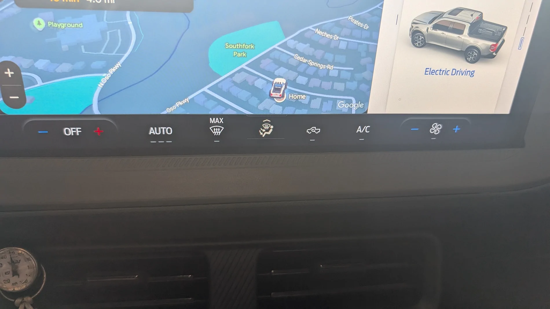

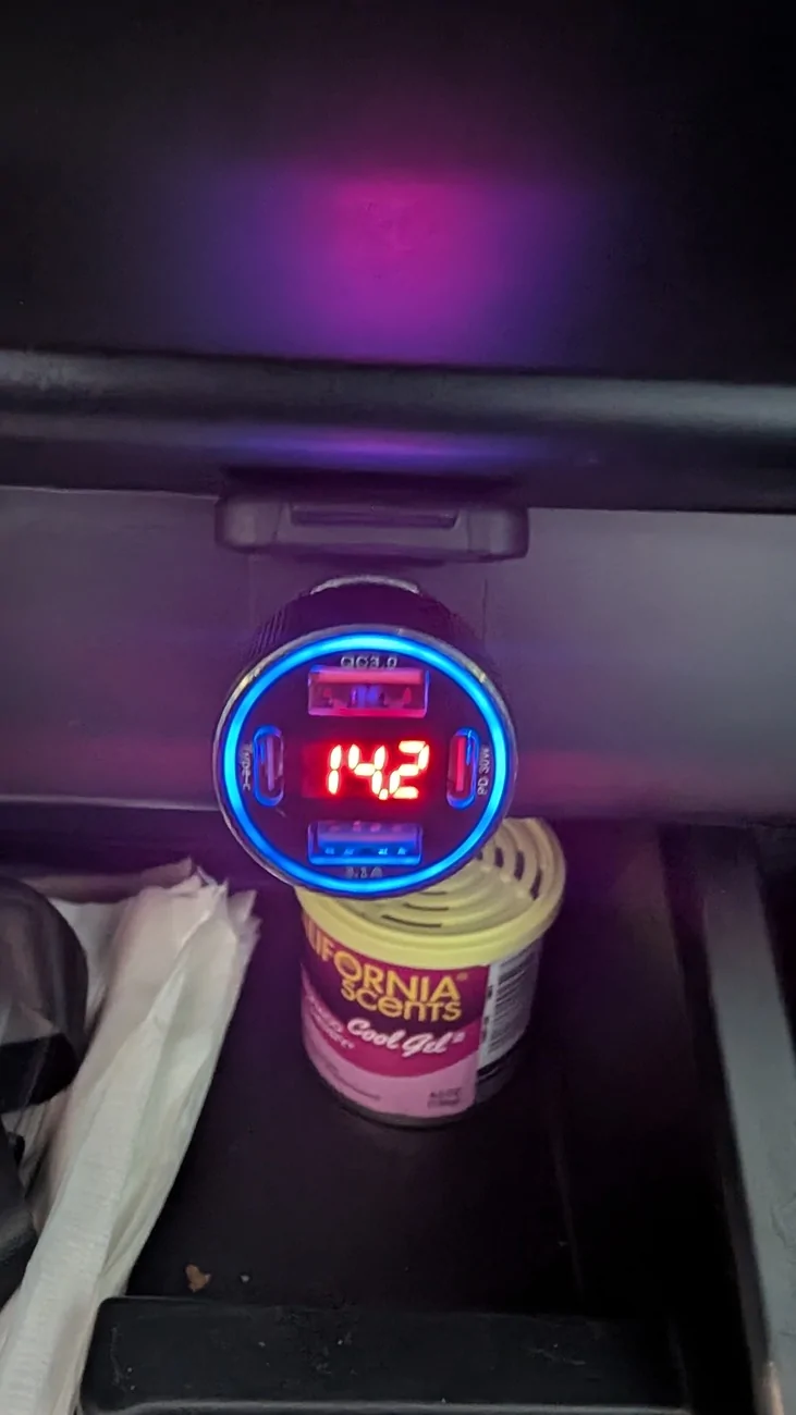

Ok another question, I have a phone charger with volt meter on it. I turned the ac off no headlights on only drl, no trailer attached. The volt meter reads 14.3 which would mean it's charging the 12v battery. when truck is off it reads 12.5 which means it's not being charged. 2025 here though so maybe it's been changed? 🤷🏻‍♂️ Also my truck has had an the software upgrades that supposedly affect the sleep mode battery stuff.

South Texas ac always set to 60-69 degrees so it's blowing 6 or 7 a lot

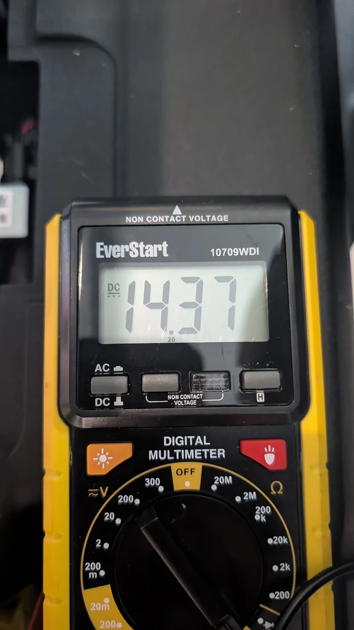

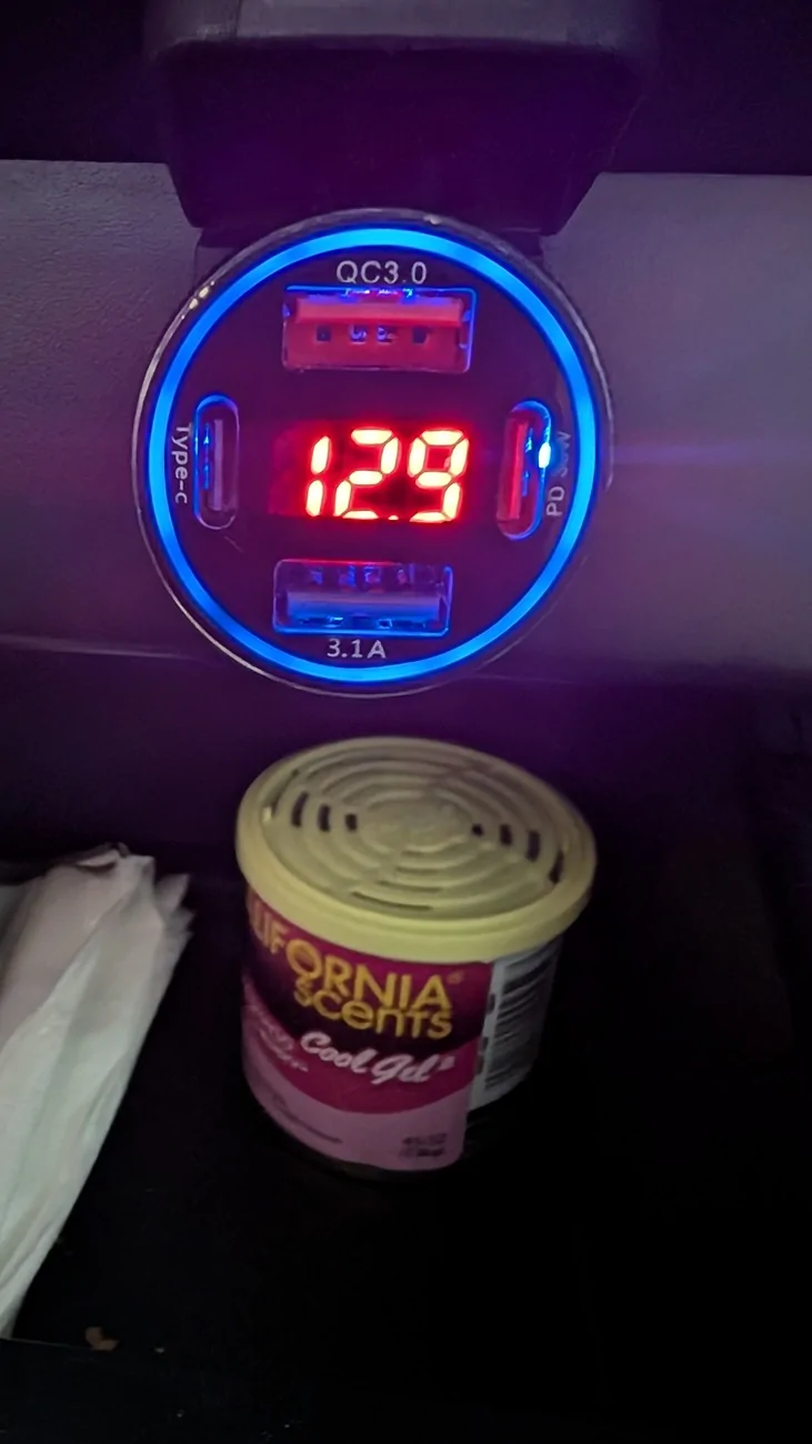

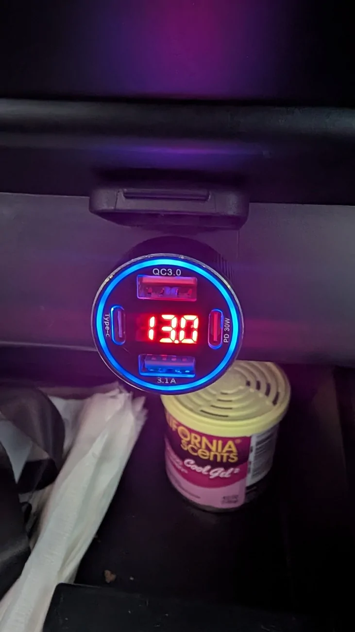

OK well I am curious if Ford has done some sort of software upgrade to fix this on the 25+ and here are my reasons for that. I had all software updates done (12 total a month after getting the truck in April of 25, the truck was built in Jan of 25) including the ACCM for the a/c that is supposedly a fix lol. I also have an AGM cause it's a 25 so it came with one.
At rest I am 12.9 volts
With key in the on position (not running) I am at 13.0 volts
With the Truck on (no lights on, no radio on, no A/C on, nothing connected to trailer light plug) 14.2 volts

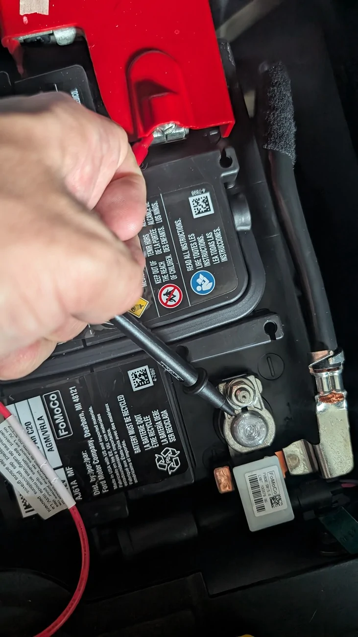

Voltmeter connected directly to the 12v battery shows 14.37 volts which would indicate it's being charged at the current time.
I don't have the same program that the mechanic has, so I can't seem to find a way to verify what state of charge my 12v is in at the moment. (Does anyone know if Car Scanner Pro will show the 12v state of charge?)
