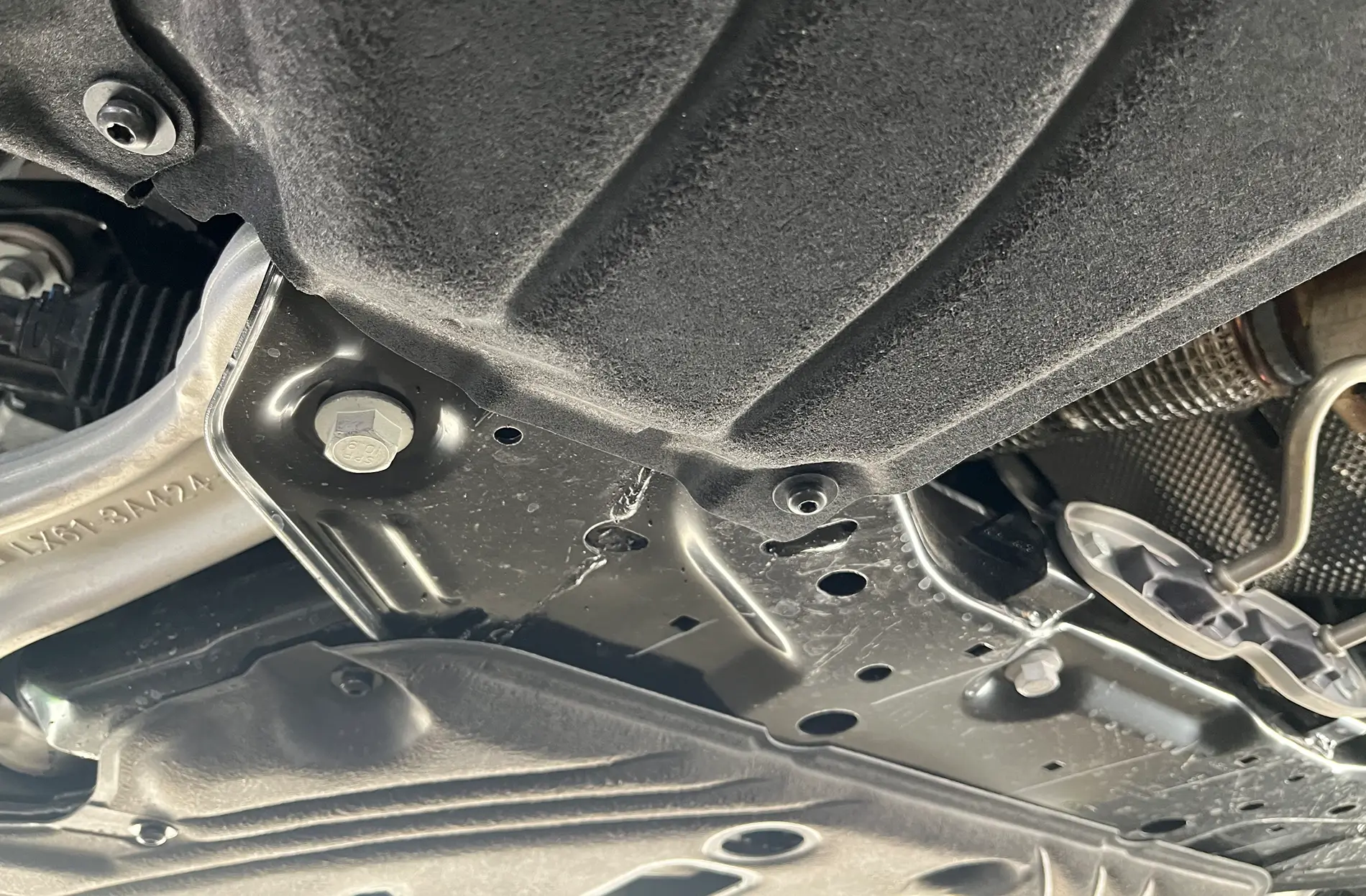

My 23 XLT Hybrid has a C-channel bolted on the cross member that my 23 XLT ECO didn't have.
23 Hybrid:

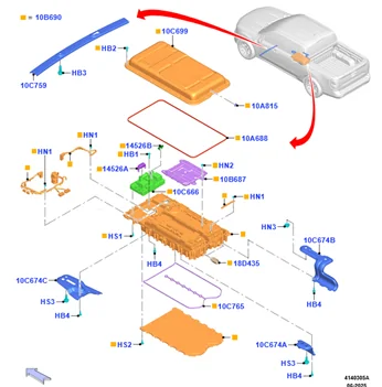

Edit:
Parts shows it's Shield for HVB Pack. Same PN as Escape's shield.
Parts > Electrical > Battery and Related Components
https://www.ford.com/product/battery-tray-brace-p4000139332
Drive Motor Battery Pack Bracket Tray Brace High Voltage - Front
SKU: LX6Z10A666H

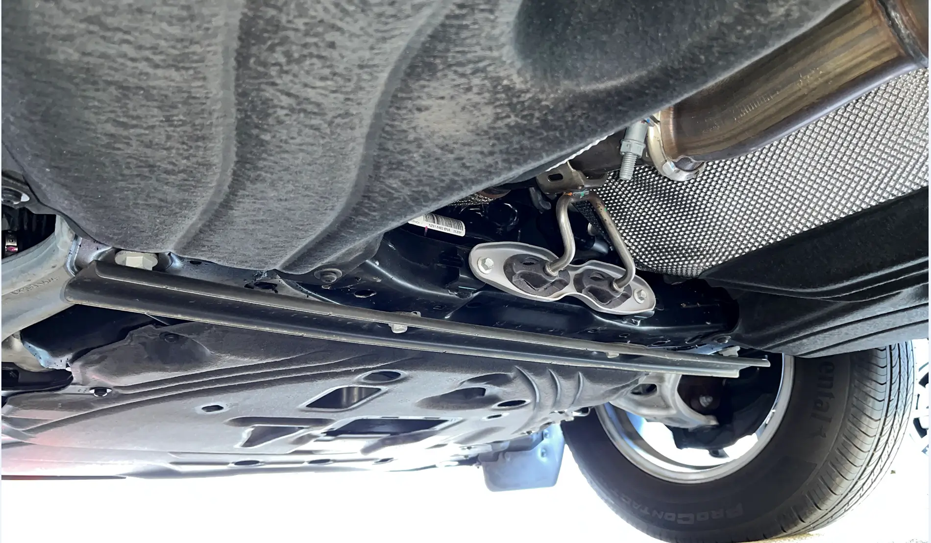

23 ECO:
Ford Maverick How to lift truck using floor jack (not using pinch welds) 1768577384038-u9

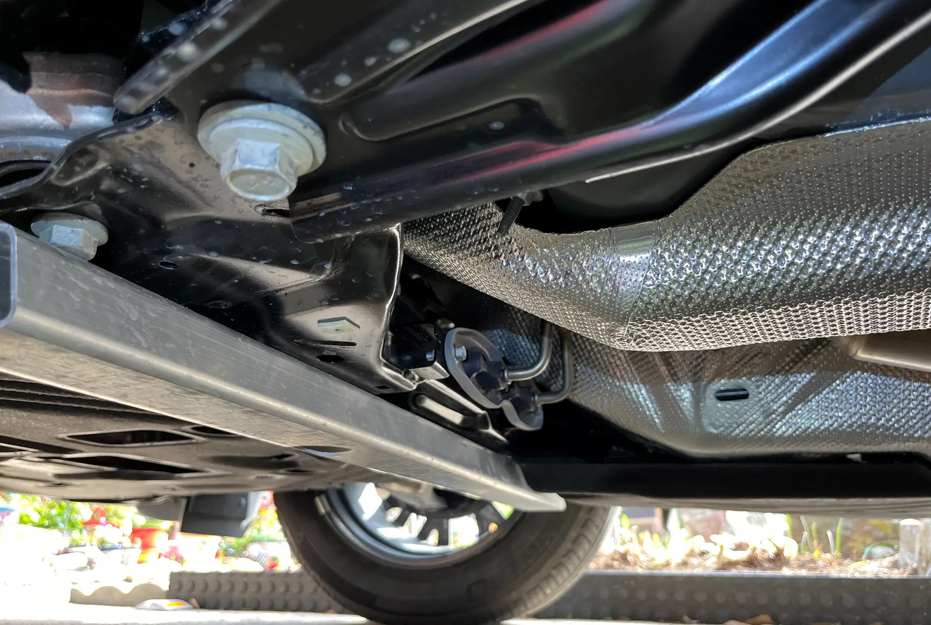

While putting my winter wheels on the passenger rear. I noticed a flat metal part of the subframe that seems pretty strong. It is near the rocker panel jacking point. I did not look at the drivers side. I really don't like jacking up on the rocker panels. Always worry about bending the lip especially if the vehicle or jack moves. Eventually when rust forms inside the rocker it will just crush while lifting. I always use a floor jack with wheels. Mavericks have so much underbody panels its hard to see where you can put the jack. Don't want to crush them. Most other vehicles you can jack under the rear end or the rear spring seat. Maverick coil area is not flat. Sloped so it will slip of the jack. There has to be a strong area by the front subframe but it is covered up. Don't like factory jacks because they don't have a wide stable base to support the weight of the vehicle and are slow to raise up plus a pain to get out and put back when finished using. I took 2 pieces of 2x6 and cut slots lengthwise to place under the pinch welds while using my floor jack. Made them long enough to have more support for the rockers. Had to widen the slots by the drain holes to avoid crushing them.
