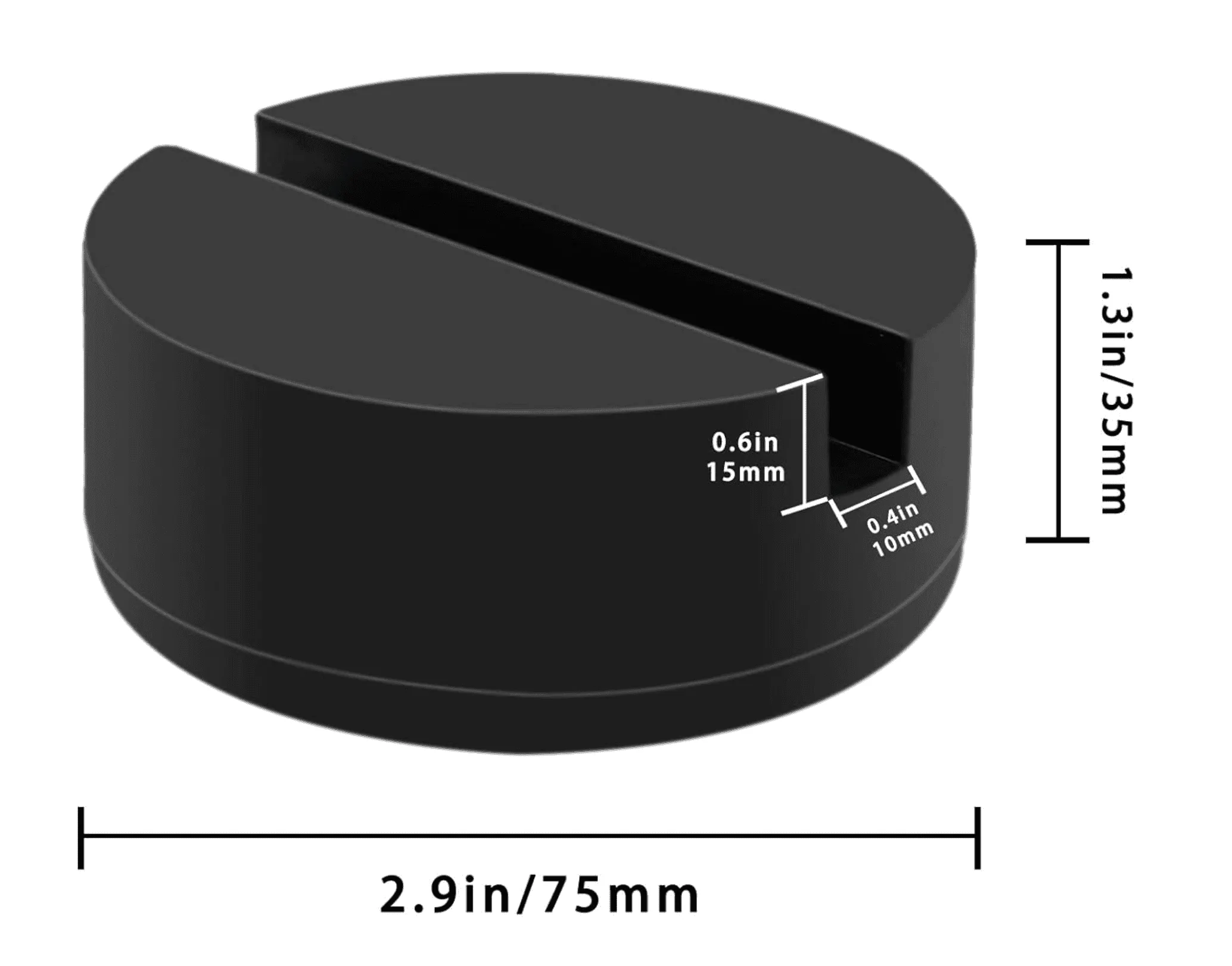

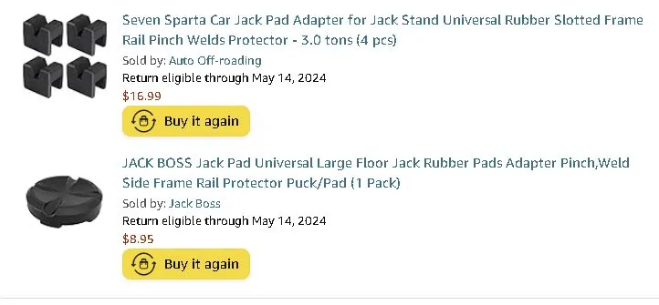

I got these jack pads with a groove cut in them from amazon to straddle the pinch weld. They're cheap and I'm too lazy to go buy hockey pucks and cut channels in them.

Please tell me if you have the information. What is the width of those slots on your pads in order to fit the pinch welds? Thank you

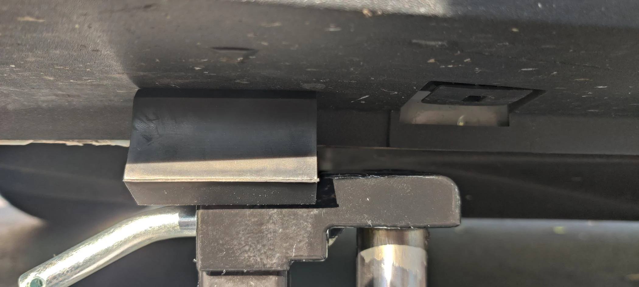

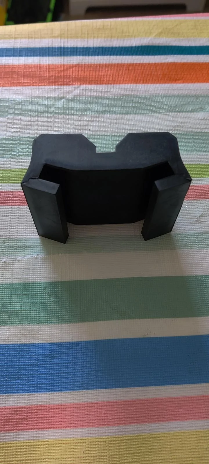

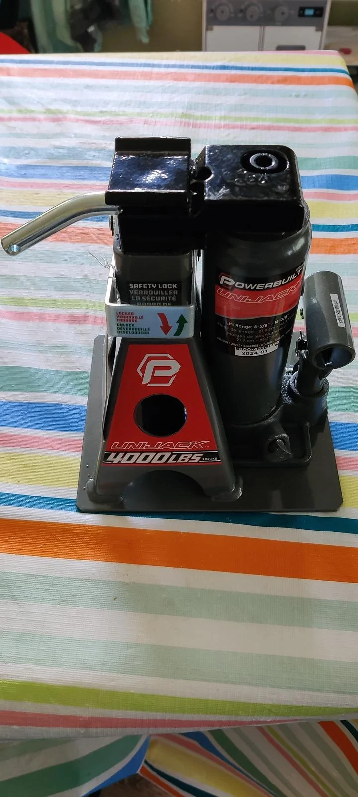

Alright, got fed up with my current jack and jack stands not playing nice with the narrow pinch welds. I got two of the powerbuilt unijacks 2ton. I wanted the 3ton but it's too tall to fit under the truck. Summit racing has the best price at $55 each. Snagged two and got free shipping. And plus powerbuilt has their own rubber puck made for it!!!! Grabbed two of those for $10 each at Amazon. Now doing tire rotations is a BREEZE.

Also bought a set of the Unijacks when I got the Mav. Definitely the easiest approach I've found to lifting and securing a vehicle. If you are as fond of your convenience as I am I highly recommend you pick some up.
