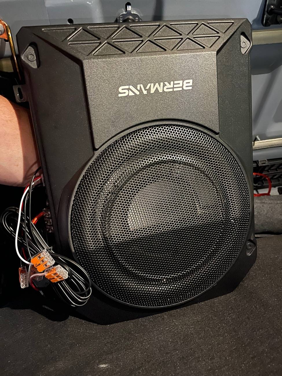

burtbrn
burton
Nov 2, 2024
festus mo
24 maverick xlt
So I tapped my rear speakers the other day for a powered sub install and the sub isn’t powering on and I’m only getting 22 mili volts at my taps. What am I doing wrong?
What amp are you using?

So it’s a cheap powered sub I got off a friend. It says it’s made by bermans. The install instructions say it will work off high level inputs and what I’ve read online the high level inputs should be around 12vdc but I’m only reading 22mvdc.

So it’s a cheap powered sub I got off a friend. It says it’s made by brenner. The install instructions say it will work off high level inputs and what I’ve read online the high level inputs should be around 12vdc but I’m only reading 22mvdc.
Can you post a picture of it as well as a model number for reference?

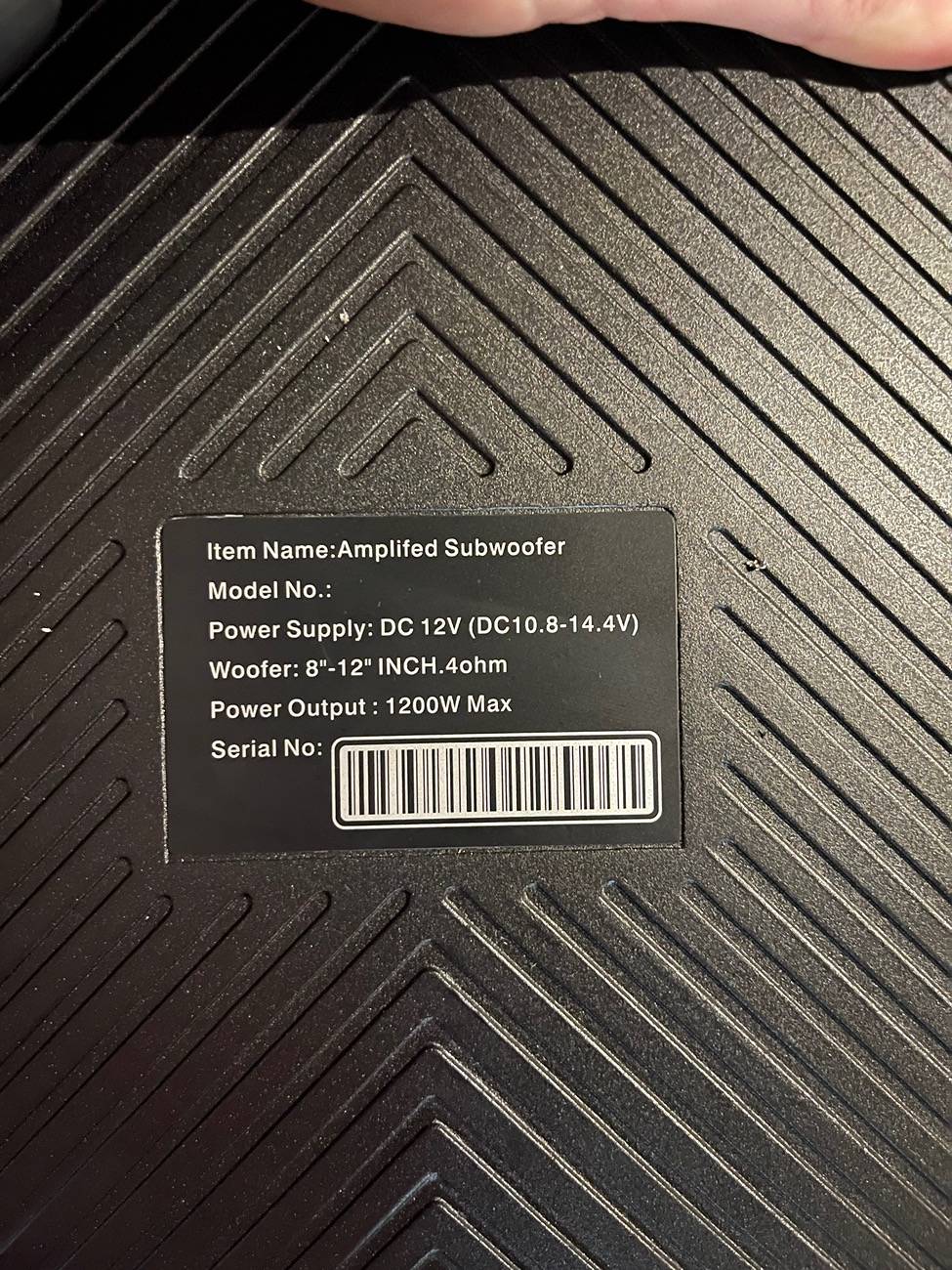

burtbrn
burton
Nov 2, 2024
festus mo
24 maverick xlt
This is the sub. I’ve really got no info on it other than what you see there.

@burtbrn
That should work as long as it powers up and gets the high input signal. To ensure you tapped off the right wires you can hook up the taps to the +/- of any old cheap speaker to verify you have sound. The high level amplifier should come right on as soon as it detects a voltage input. Also make sure the sound profile from the head unit is set to All Seats and not Driver Only. Keep us posted
Since you say it's not turning on, and if everything is wired properly having your power wire from the battery your ground to the chassis and then your speaker taps going from the rear speakers to the speaker inputs on the sub amp. I would check the fuses on it and make sure they're not blown.
Since there's no model number or any real info to go by for that AIO. Also is there a switch somewhere to select for the trigger or high level inputs for turning it on?
Also can you post a full shot of the side inputs and outputs, of what you have connected?
