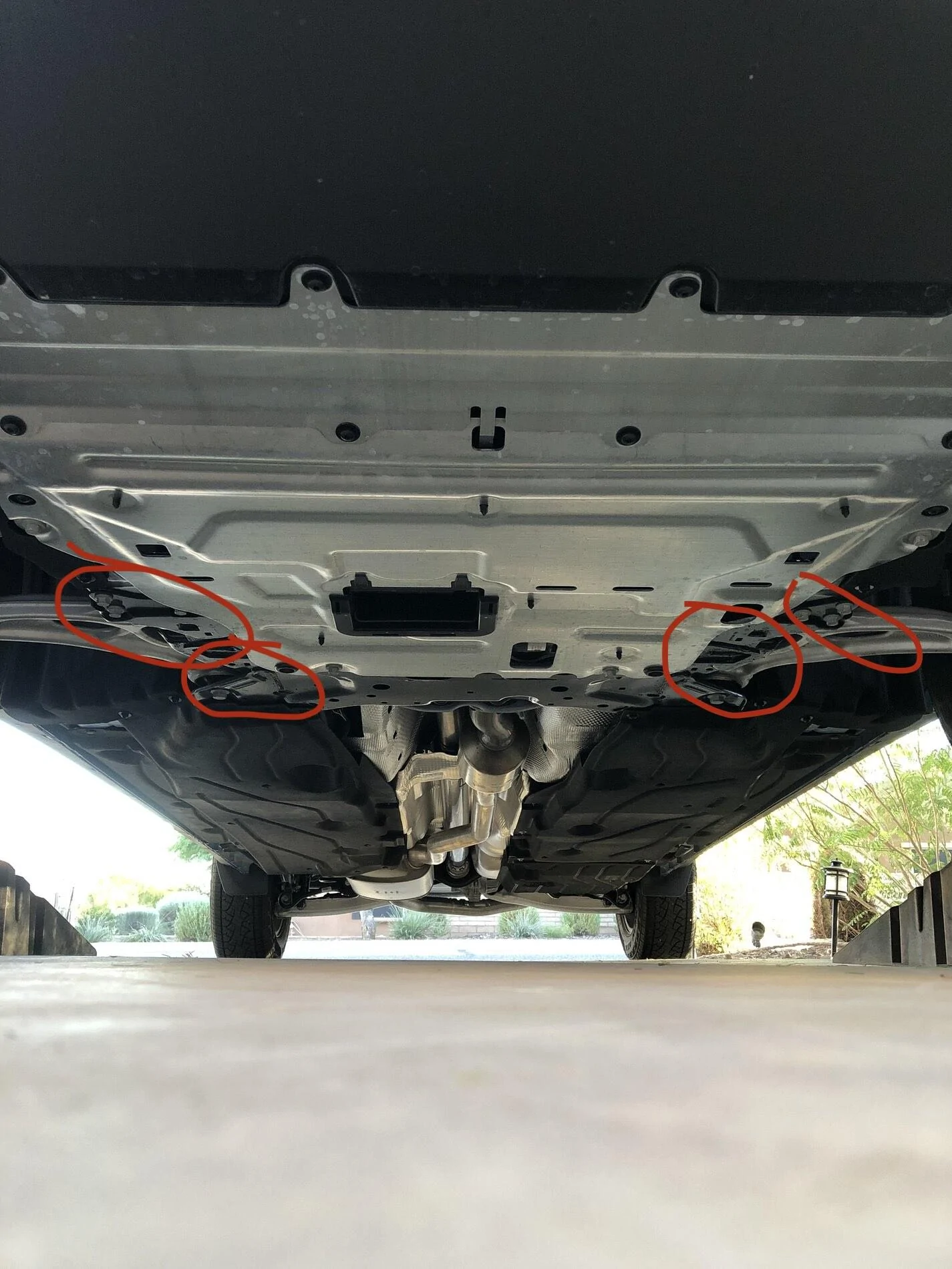

On the underside there are spots I circled in red that should hold a jack stand if I use the pinch weld to jack the truck up. I just don't know which spots will work.

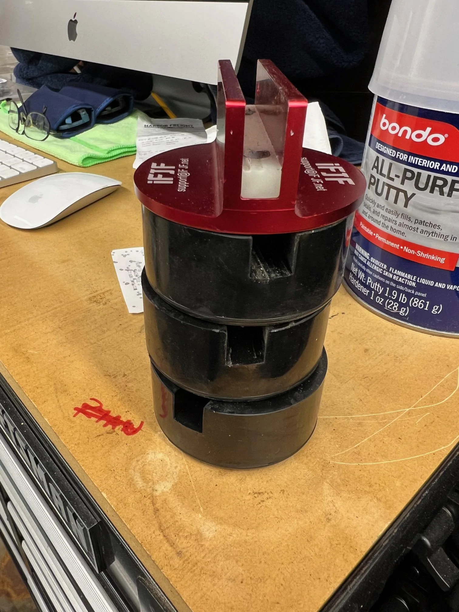

Since I change my own oil I purchased some hockey puck looking hard plastic pieces on Amazon that sit on my floor jack. These have slots cut in them to accommodate the pinch weld. I bought these for my Transit Connect but I’m sure they would work for the maverick. I’m a January order so it will be quite a while before I get to use them on my Maverick.
I have actual hockey pucks that I cut slots in with a circular saw 😁

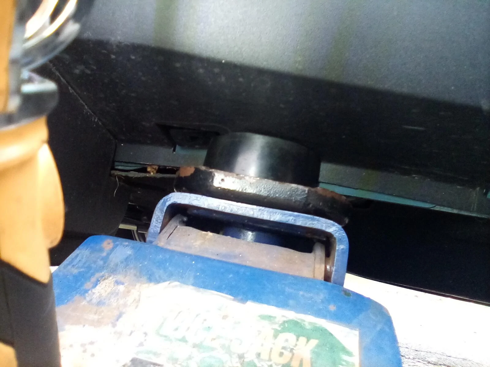

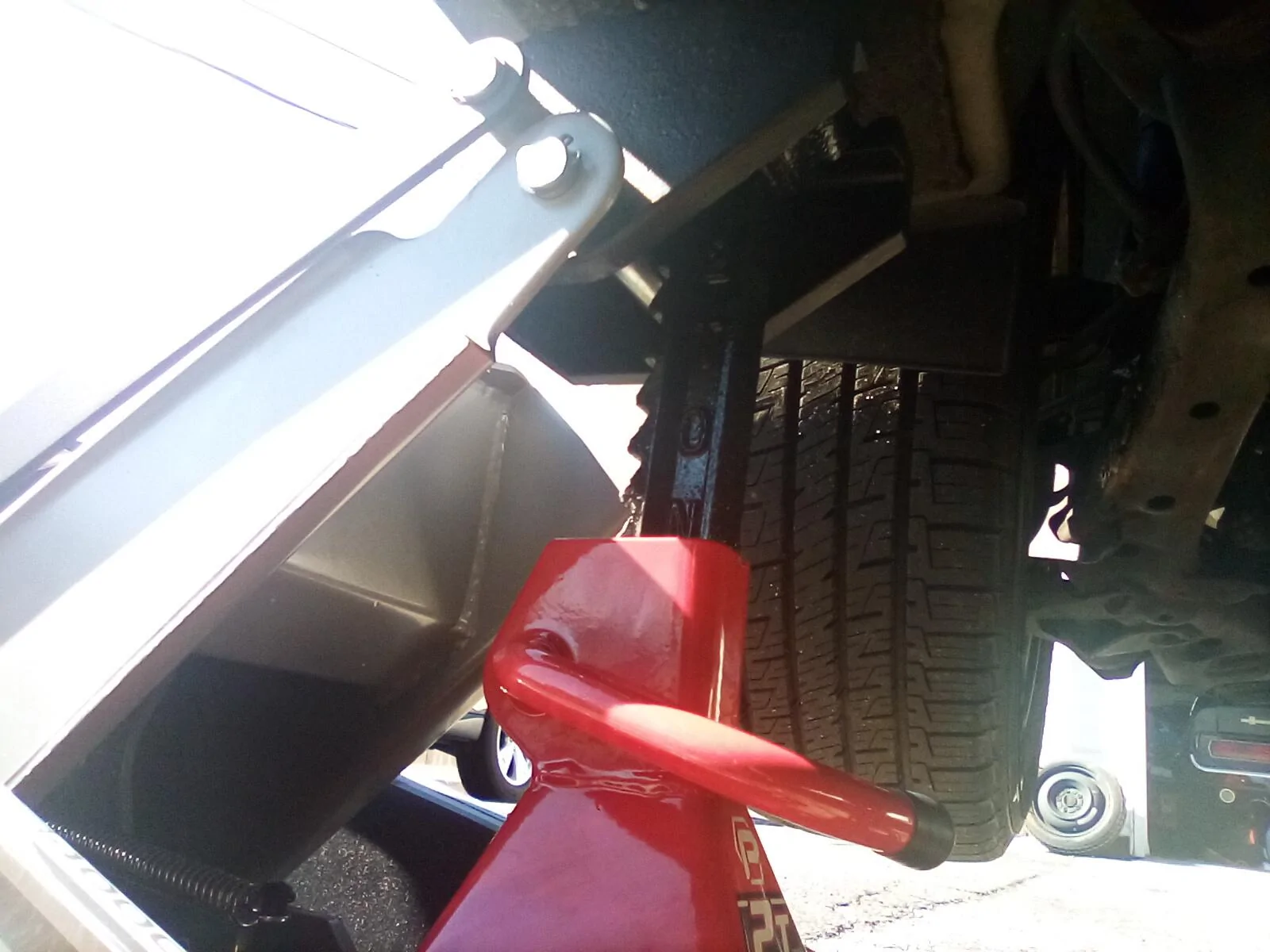

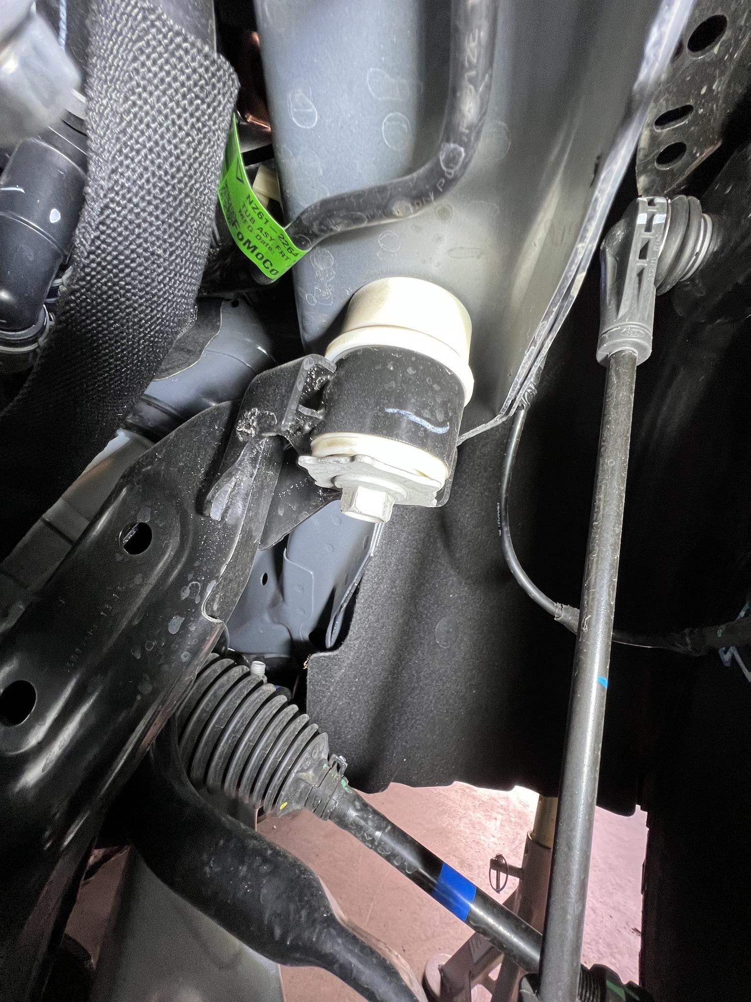

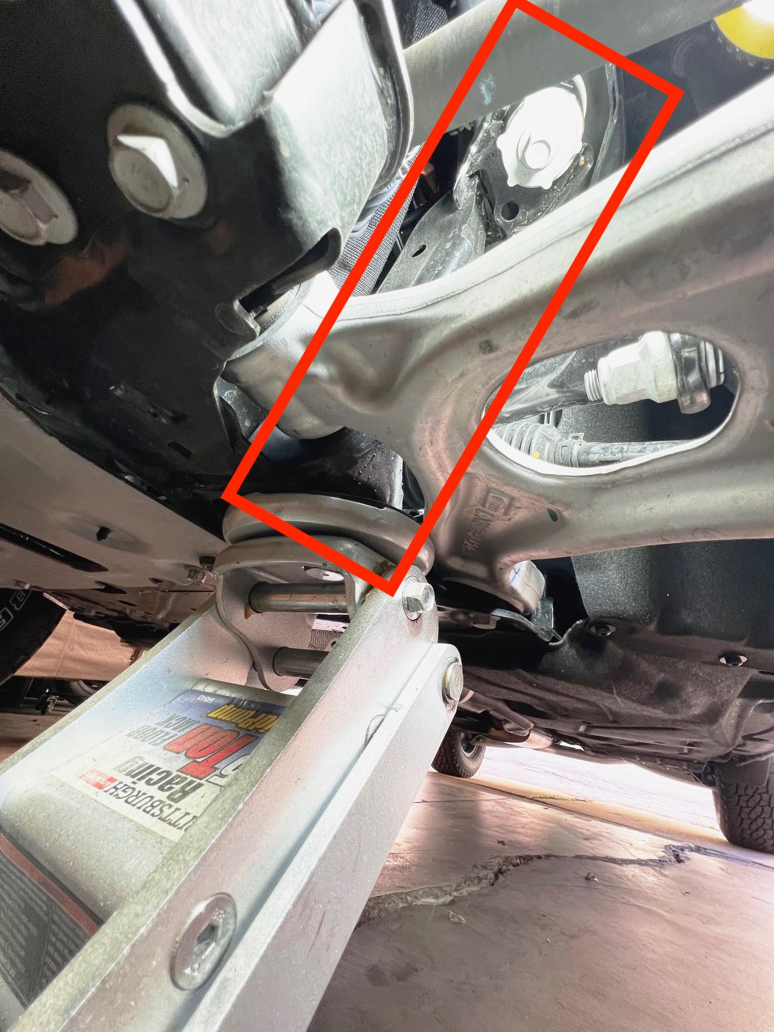

I've jacked up the truck a few ways. First way is jacking up the front, by putting the jack pad under the main bolt were the front lower control arm meets the subframe/ crossmember.
Ford Maverick how to jack truck to put it on jack stands. Untitled_Artwork 4
This contact point is the bottom of a thick boxed tube that ascends and bolts directly into the sub-floor of the car. It carries the entire dynamic weight of the truck during driving, so it'll have no problem bearing the weight when the car is static. See red box of second photo.

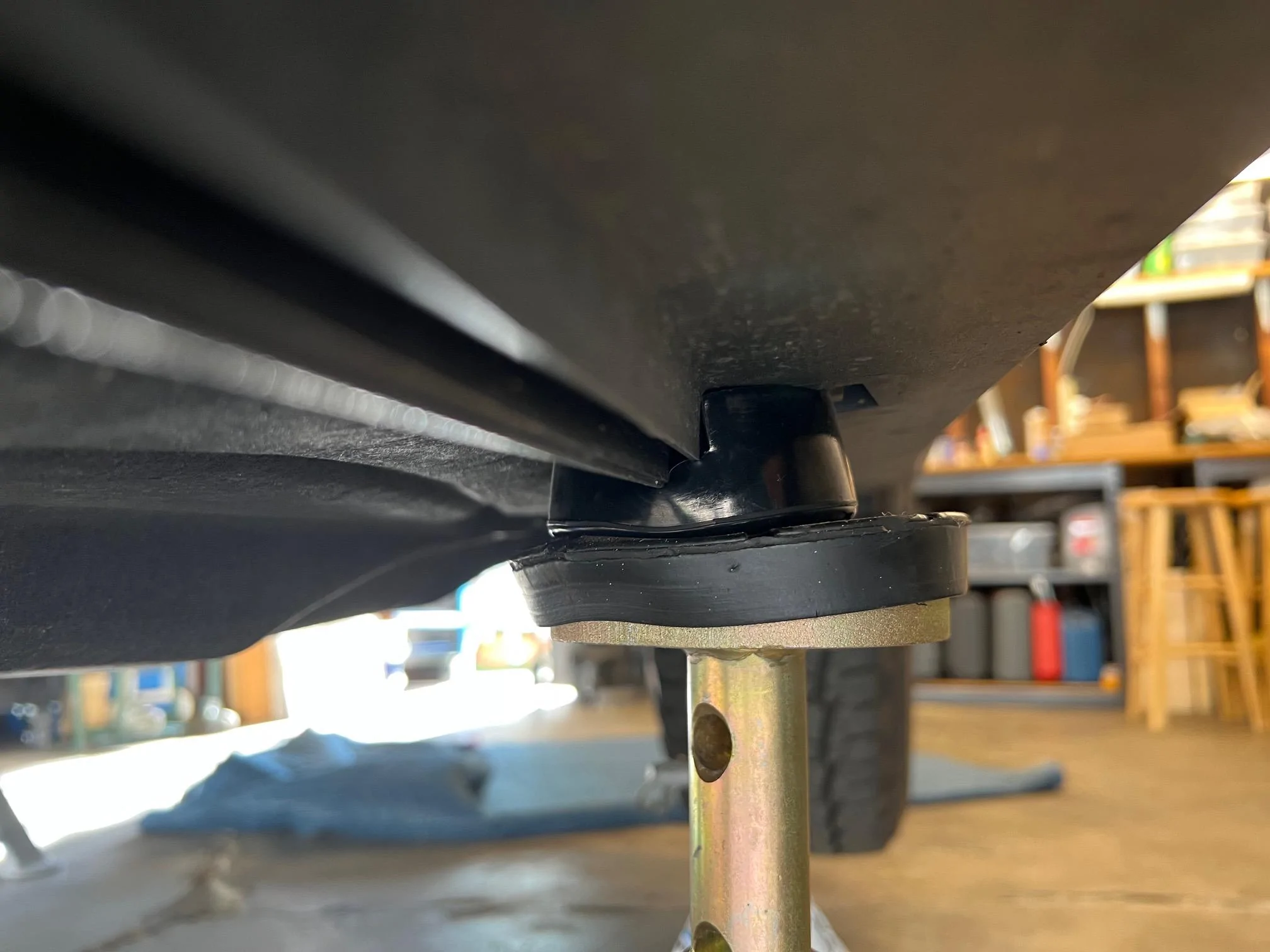

Ford Maverick how to jack truck to put it on jack stands. Untitled_Artwork 2

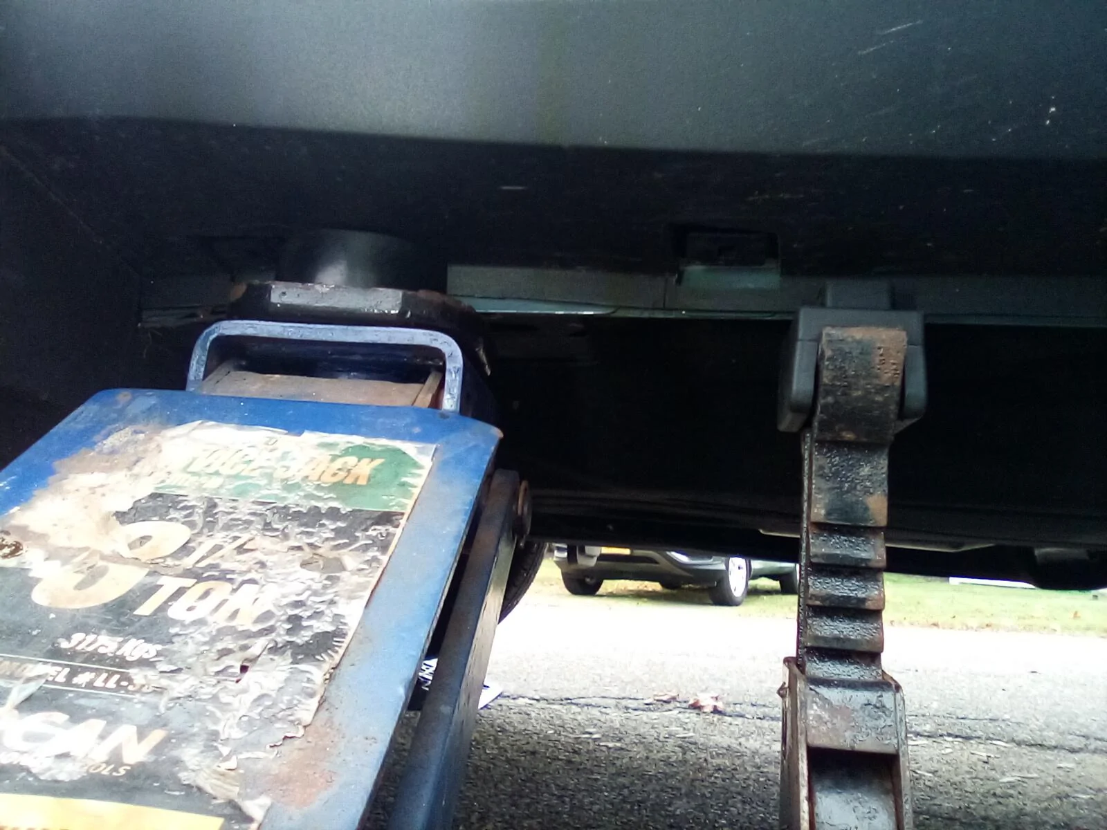

I got these jack pads with a groove cut in them from amazon to straddle the pinch weld. They're cheap and I'm too lazy to go buy hockey pucks and cut channels in them.
I've found these jack stands to be very sturdy and well constructed.
Ford Maverick how to jack truck to put it on jack stands. Untitled_Artwork 3

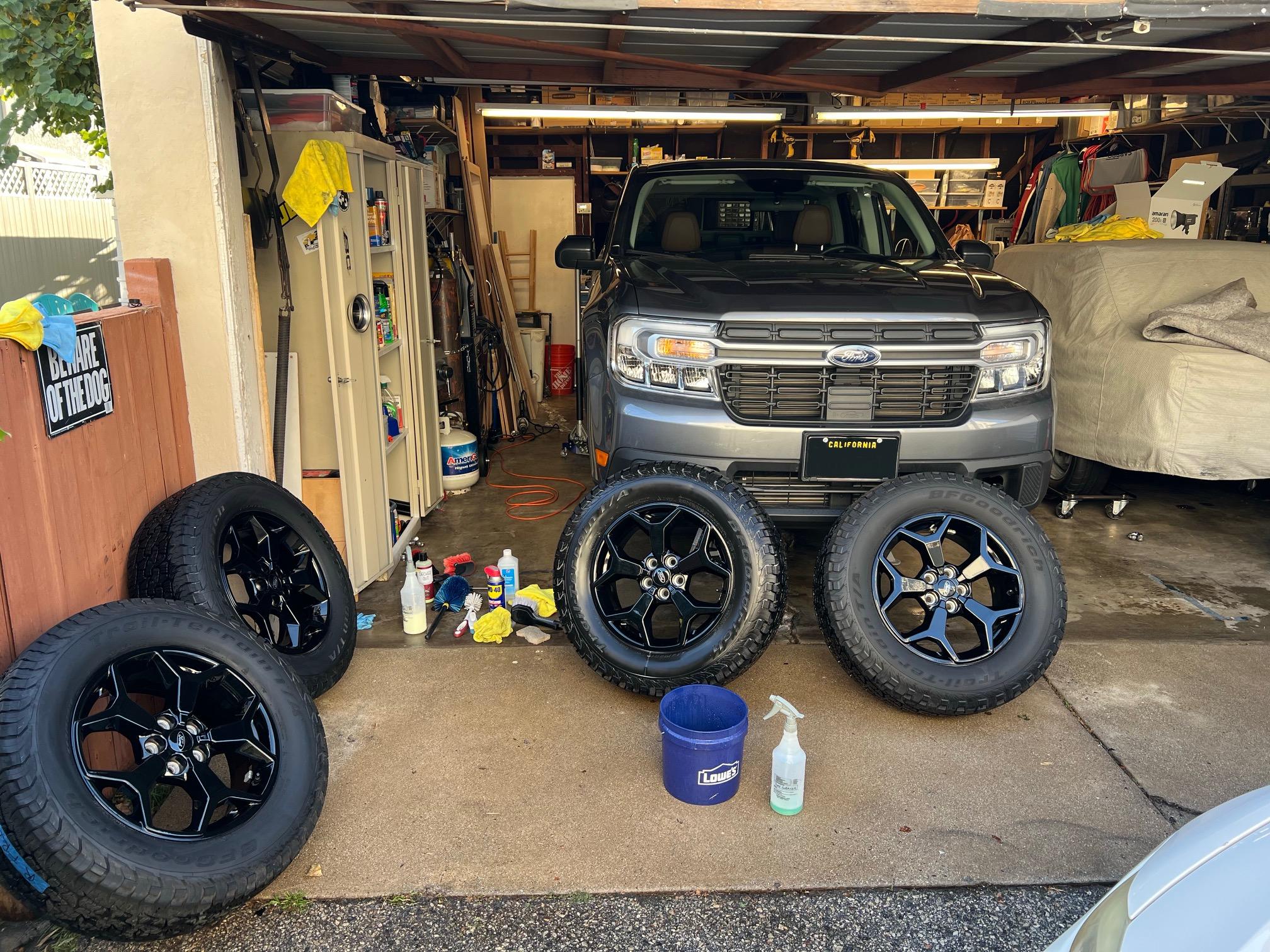

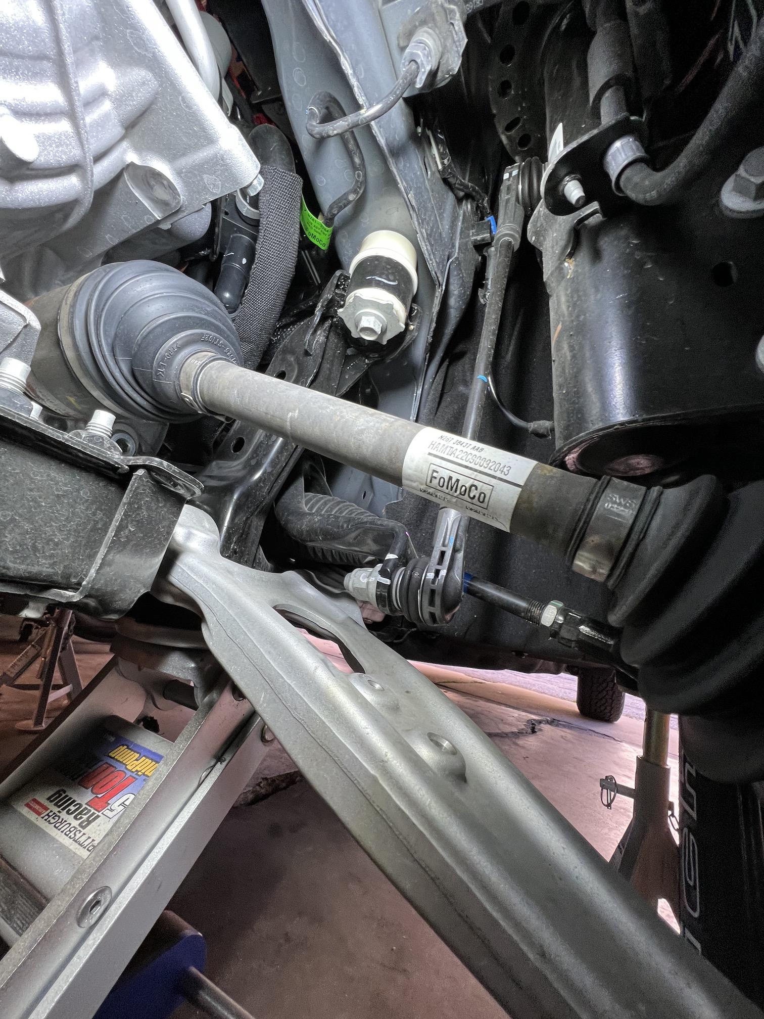

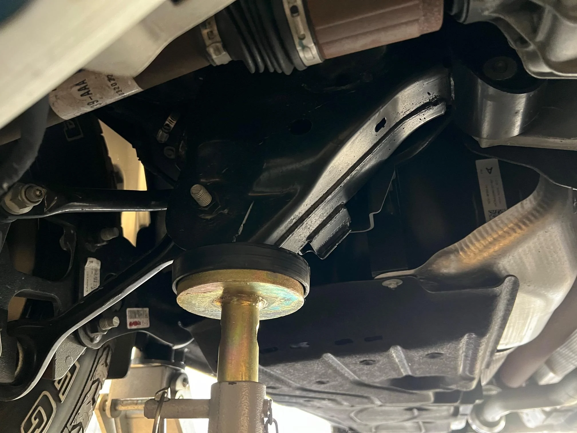

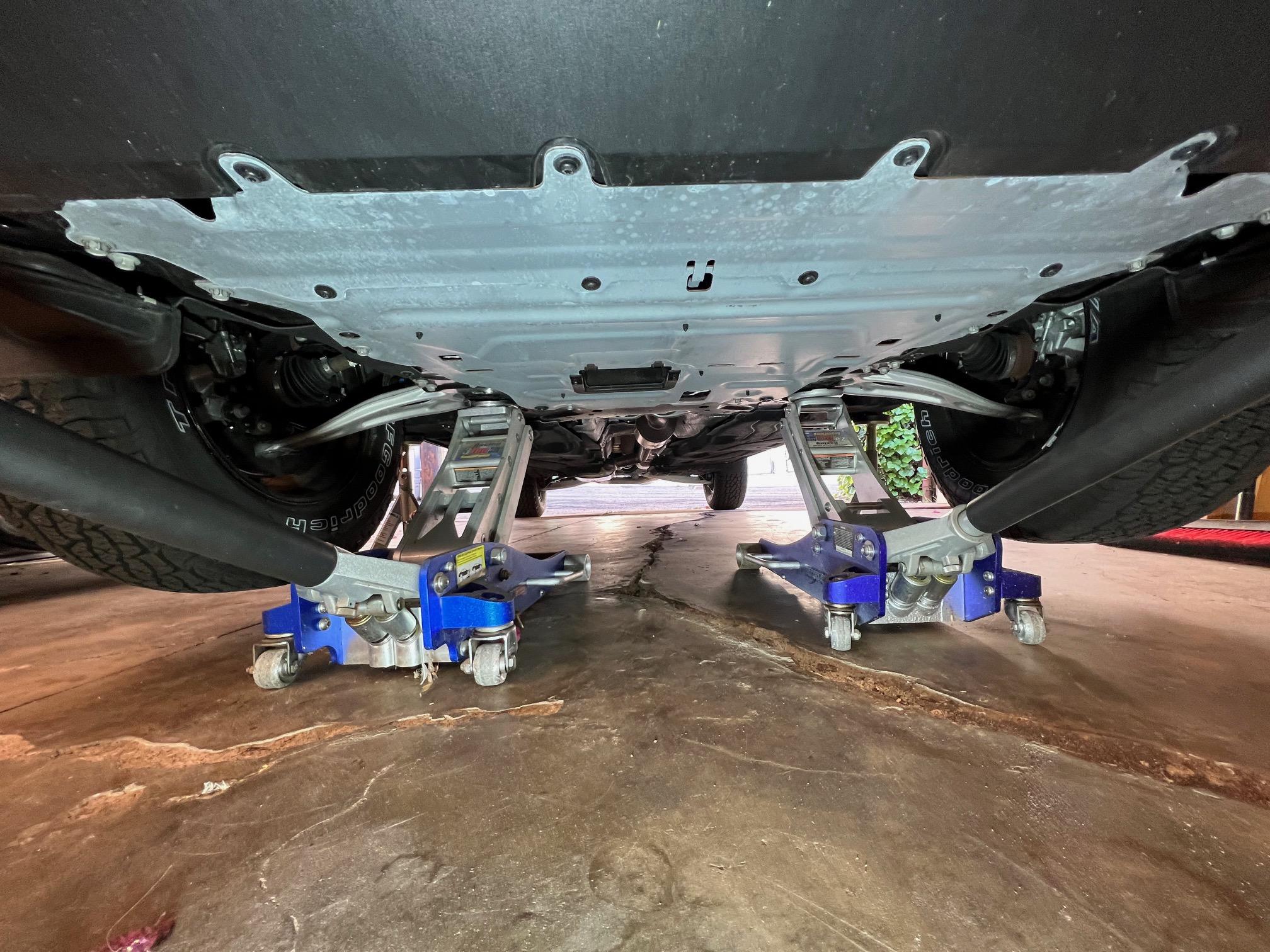

Here's how I raised the truck yesterday to rotate my tires and ceramic coat the wheels:
-Jacked up front of truck at factory pinch weld lift points, using slotted rubber pucks.
-Placed front jack stands under front main bolt where lower control arm meets subframe (same spot as in previous method).
-Lowered the truck onto jack stands and then moved jack to rear factory lift points using rubber pucks.
-Raised truck and placed jack stands under rear boxed subframe. VERY strong.

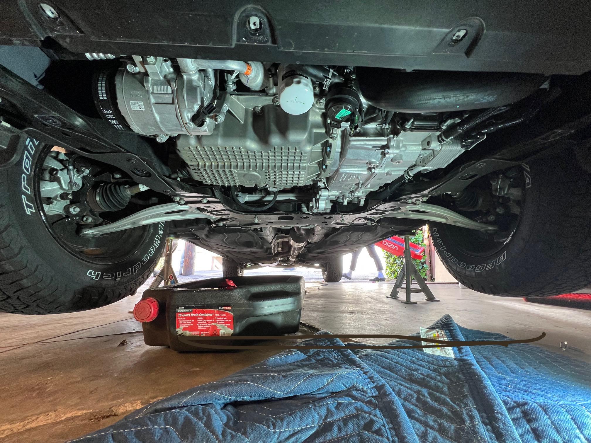

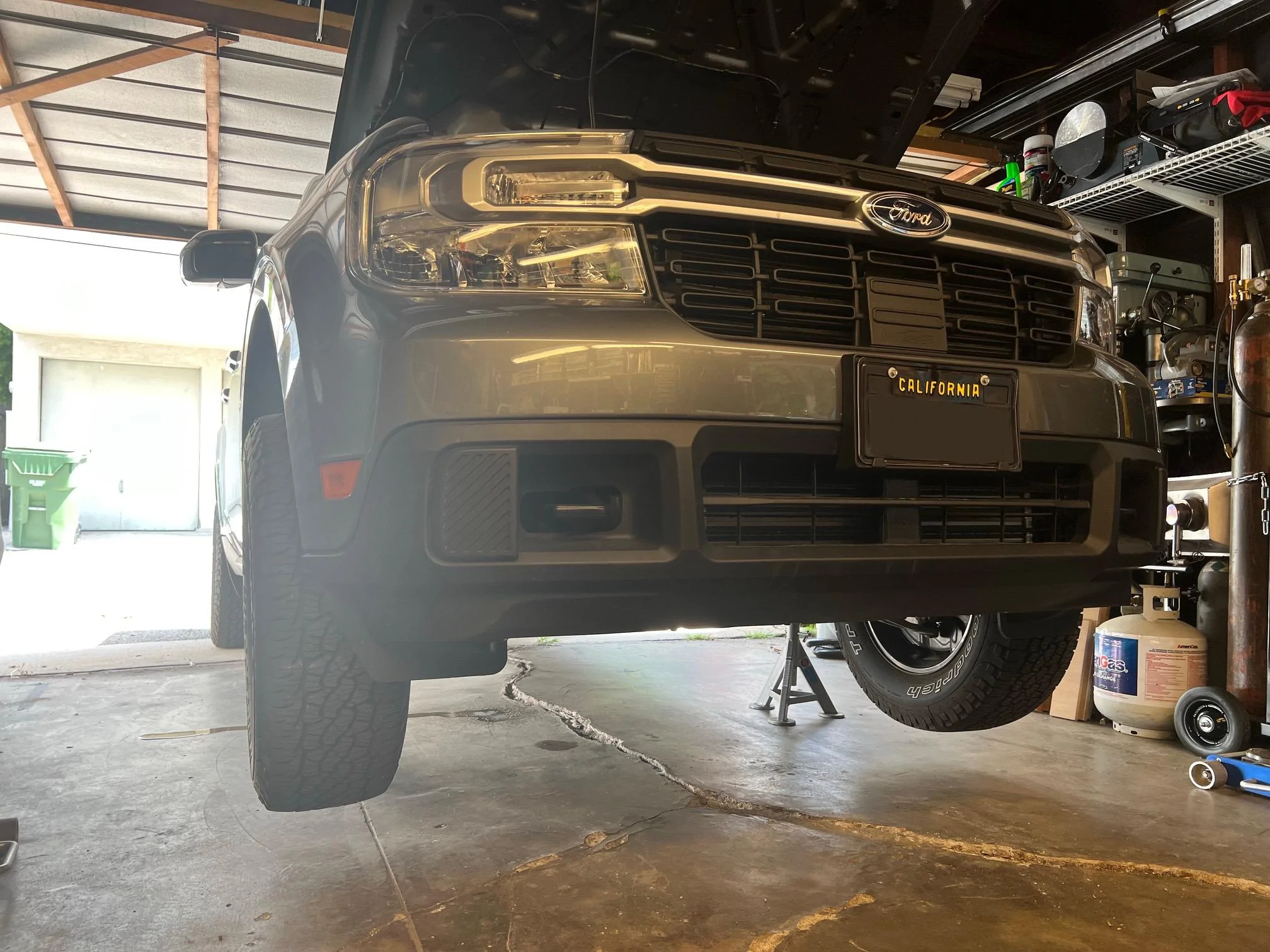

Ford Maverick how to jack truck to put it on jack stands. IMG_0168
If it's not in the way.of the work i'm doing, I like to leave a jack under a lift point, as a safety. There's a second jack on the other side in the same position. A family friend who worked on cars for 40 years was crushed to death when he removed a drive line and forgot set the parking brake and chalk the tires. Bad way to go. So these days I figure it's no sweat to be mindful and try to idiot proof a situation.

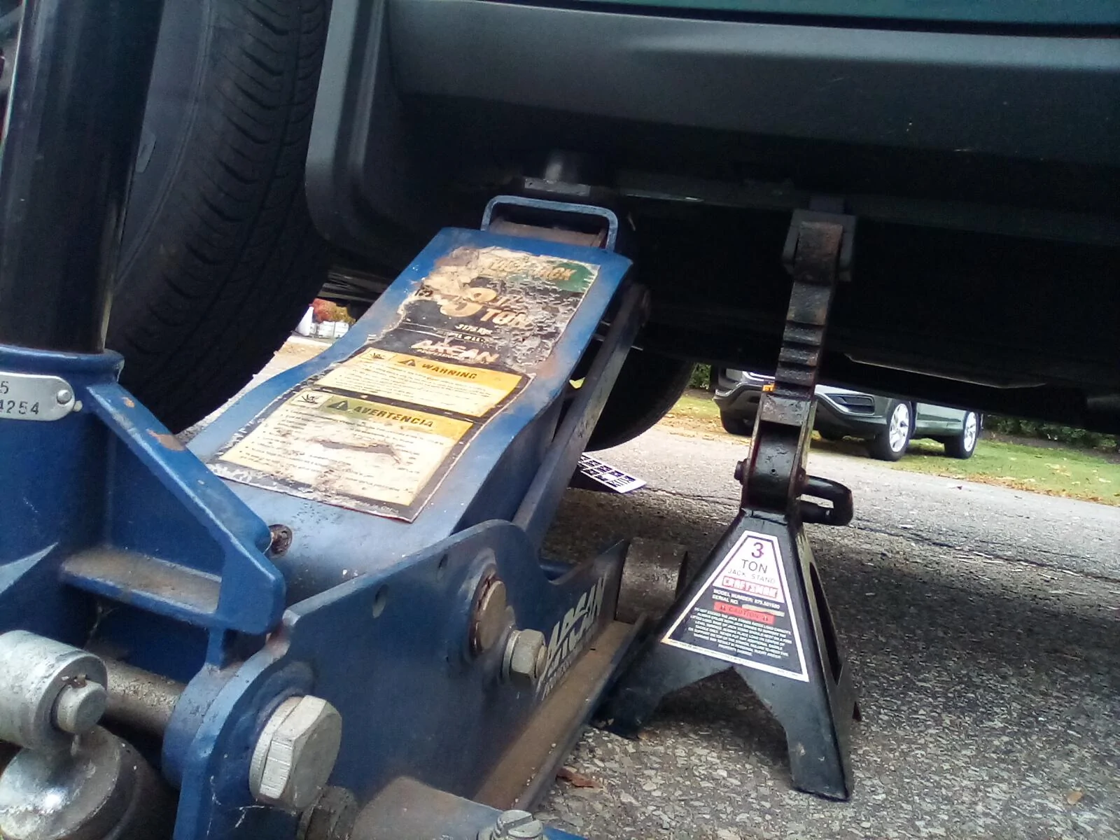

Ford Maverick how to jack truck to put it on jack stands. IMG_0173
Lower truck onto rear jack stands, give the car a really hard shake test, and then make your wheels shine.

good idea about the paints. i looked at jack points that are found with the arrows. interesting,
the arrows point directly to the 2 layers of pinch weld, instead of the 3 layers of pinch metal that is about a 1/2 inch away from where arrow points at, which is the 2 layers of pinch weld.
wouldn't it be better to jack at the 3 layers?
Only ford knows for sure. I guess it depends on what the jack points are attached to? I am using the one closest to the arrow.

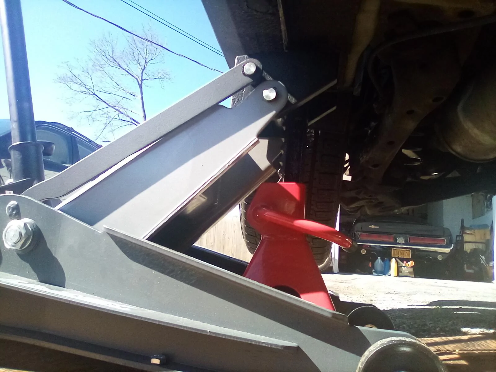

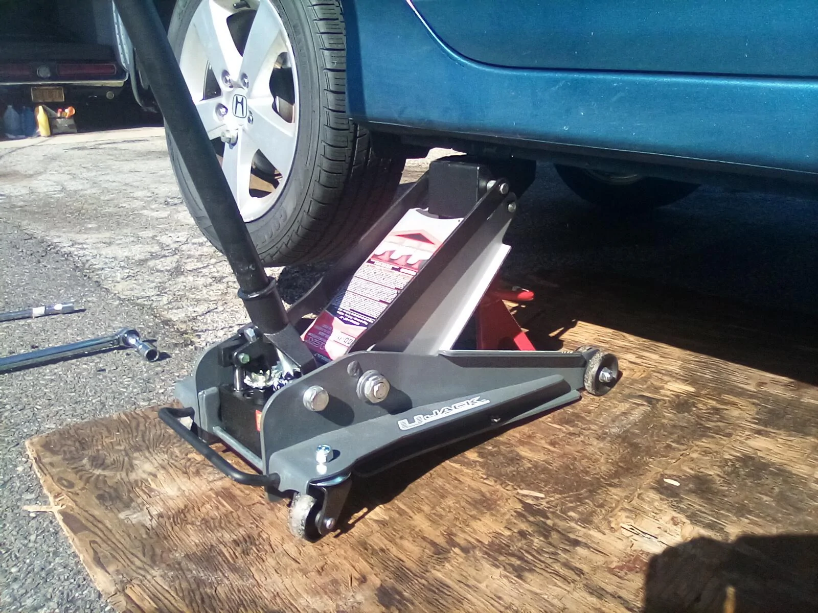

I understand that there are jack point on the pinch welds, but when I rotate tires I like to pick up my vehicles and put them on jack stands. Also I like to use jack stands when changing oil since I don't have ramps.
Where can I put a jack under the truck to get it up in the air so I can put jack stand on the pinch welds? Or do I have this backwards and I need to jack by the pinch welds and place the jack stands somewhere else?
Pics would be nice if someone can.
Also I was wondering if I could use this jack spreader from Harbor Freight. I was thinking I could put it just back far enough in the from to get a jack stand on the from pinch weld and jack the whole side up. I figure since the back is so light and the weight would be spread out it should be OK. Then I could put jack stands in front and back on one side. The do the same for the other side. Thoughts?

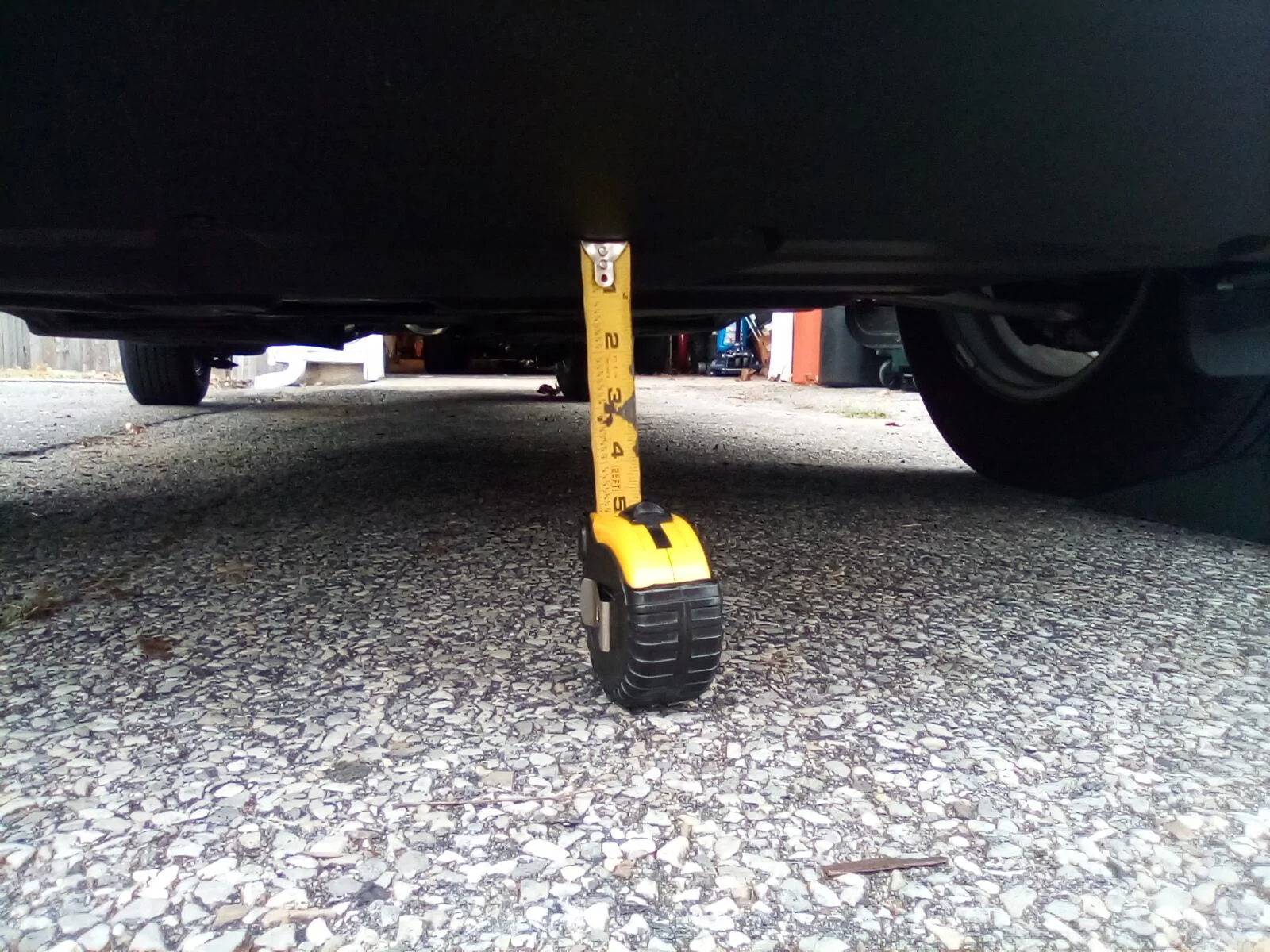

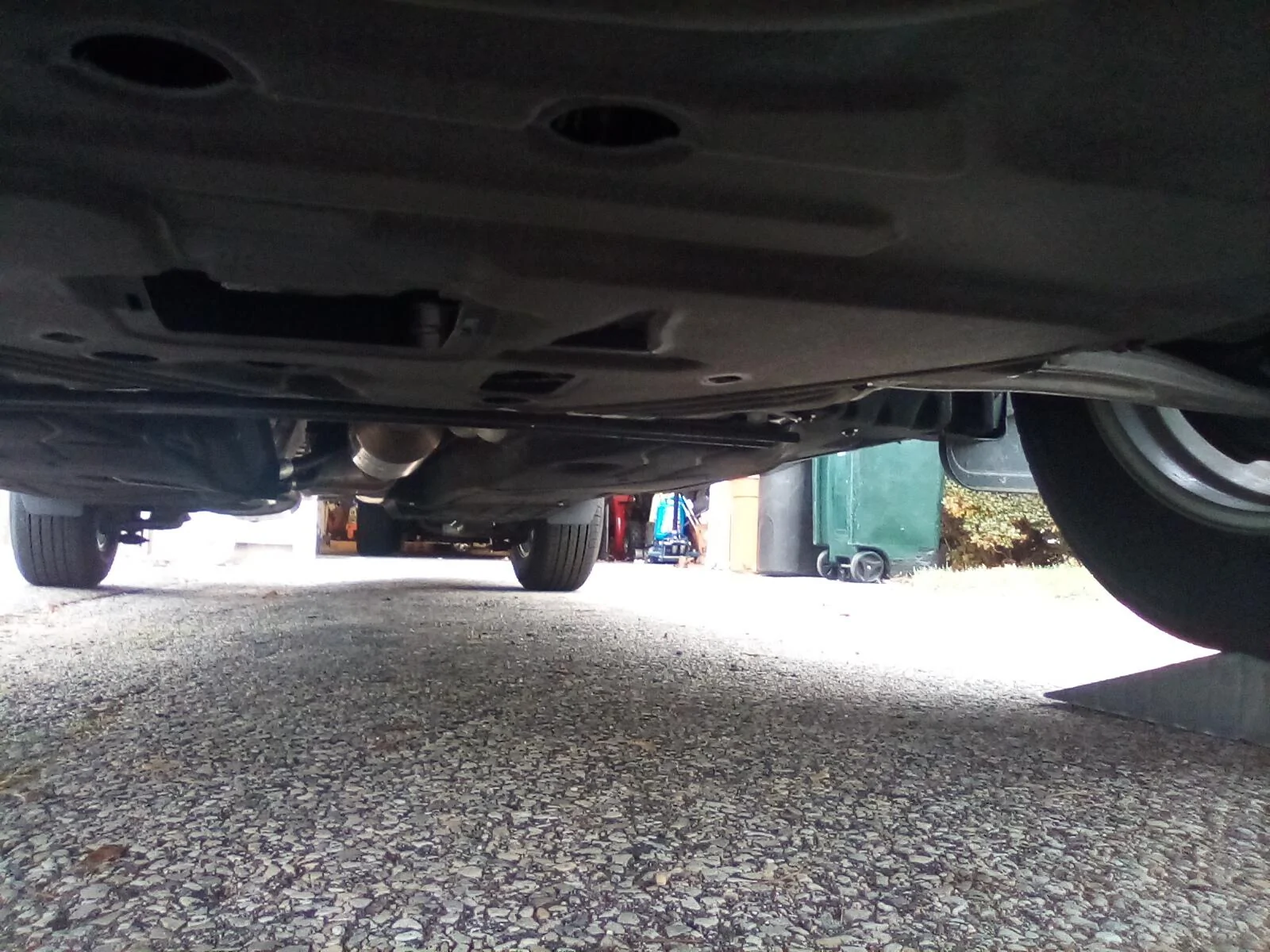

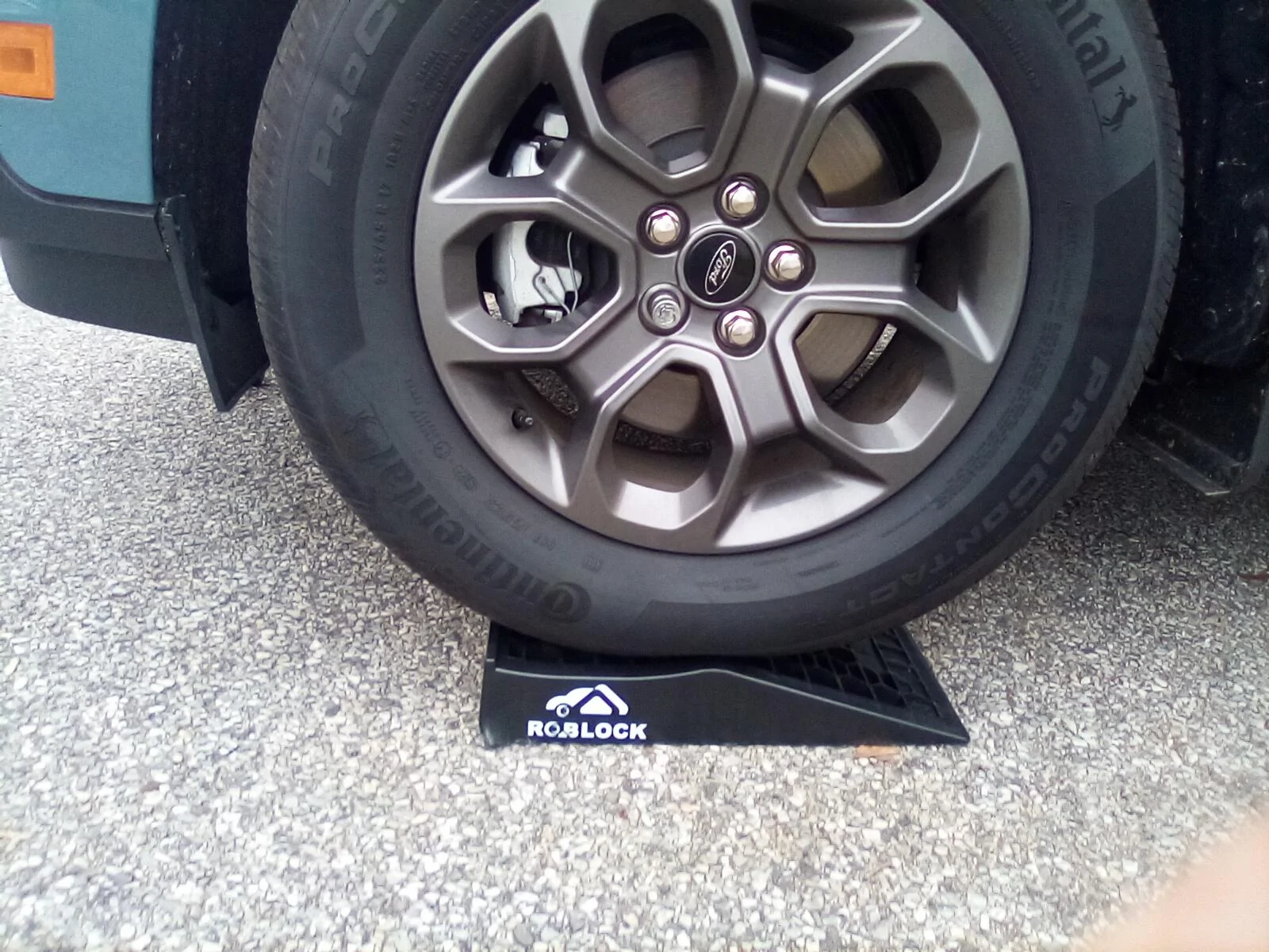

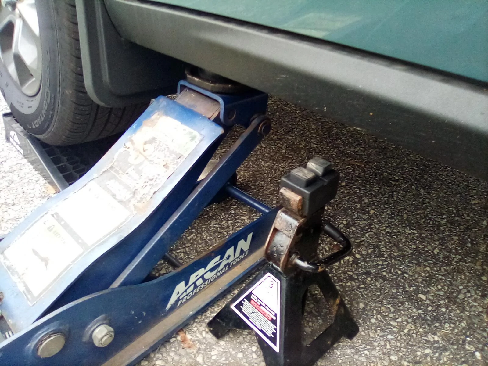

I bought these 3" ramps but also tried floor jack and jack stand on pinch weld today. Ramps will give me enough room to get under there but it is a little tight. Floor jack with jack stand next to it should work ok.

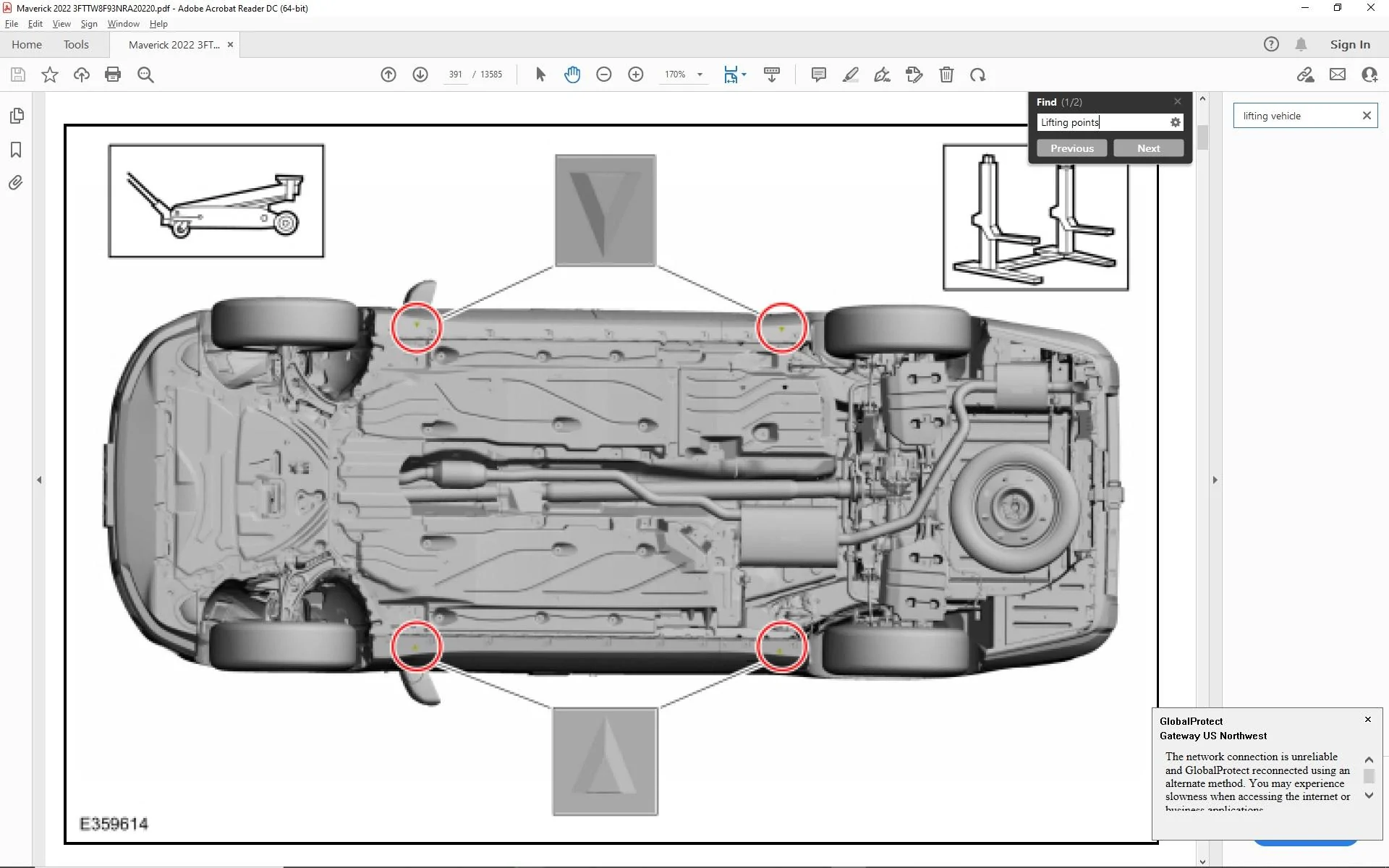

I have attached an image from the service manual from Ford

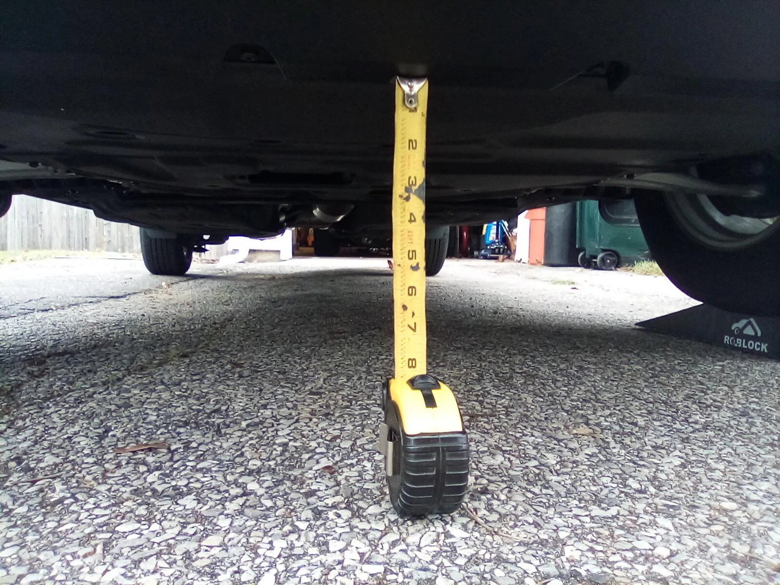

Do you know if there is any where in the center of the truck, maybe 5 or 6 inches from the bumper inward to lift the truck up for a hybrid. I did this several times on dodge grand caravan and engine was heavier.
