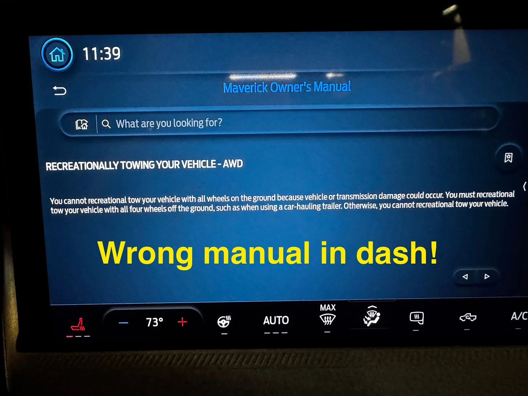

LOL... oh shucks. Well, I'm the one with the wrong Maverick manual loaded to my dash display computer... which tell me my 2025 Hybrid AWD must NOT be neutral towed! But I imagine the pinch weld info you describe is the same in the outdated manual in my dash. Or I have found the right manual on my Ford page, so I could read it on my computer.
Thanks for evaporating that silly dream of 4' long jacking flexibility. Ha
