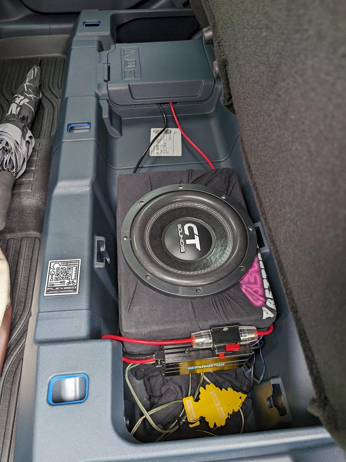

2023 Maverick XLT - BAP and LUX package

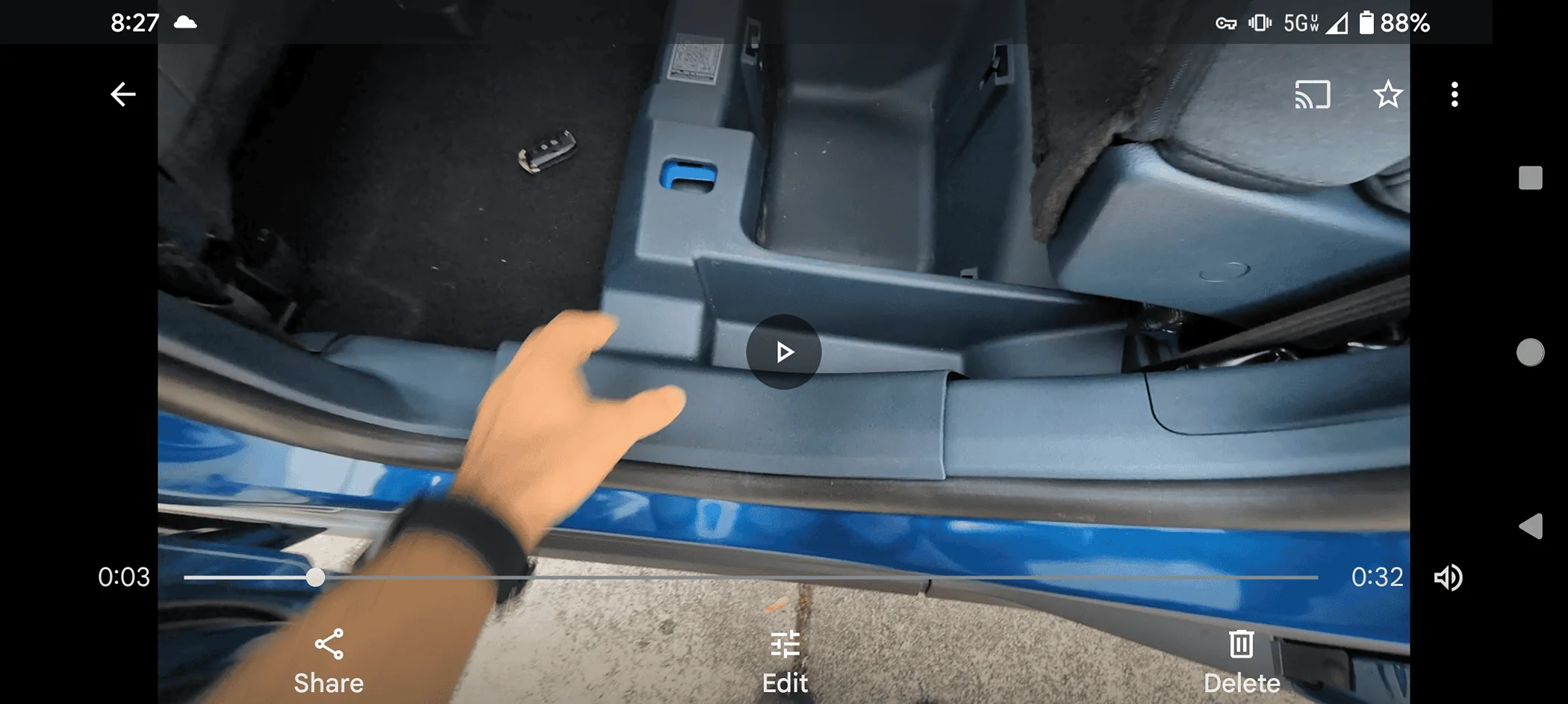

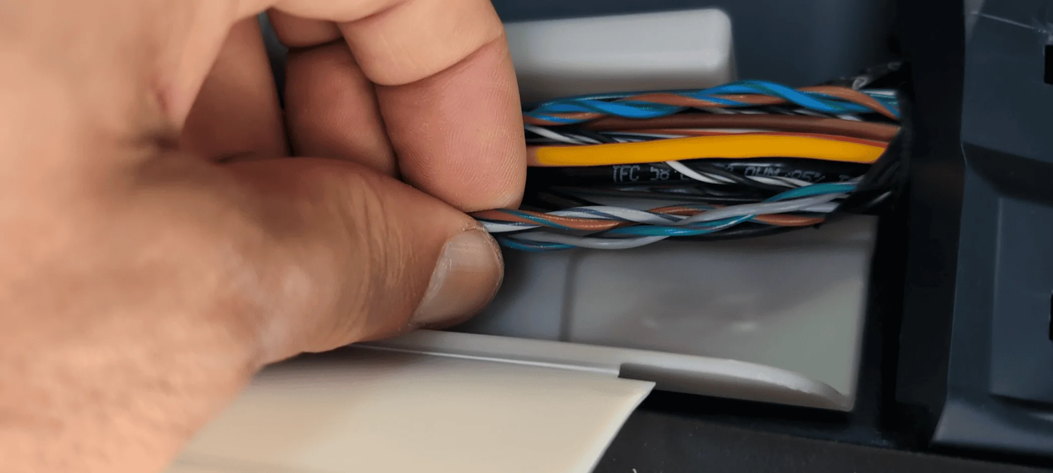

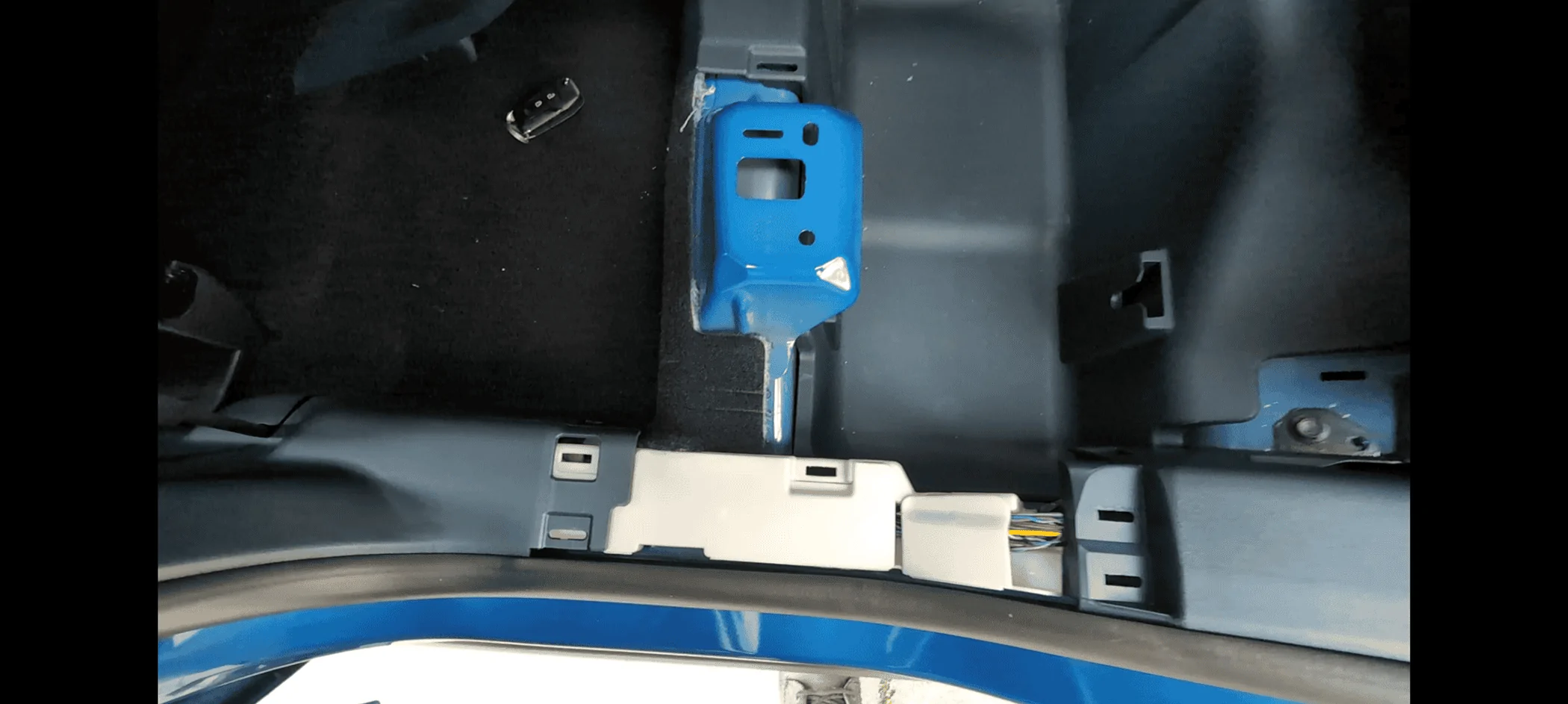

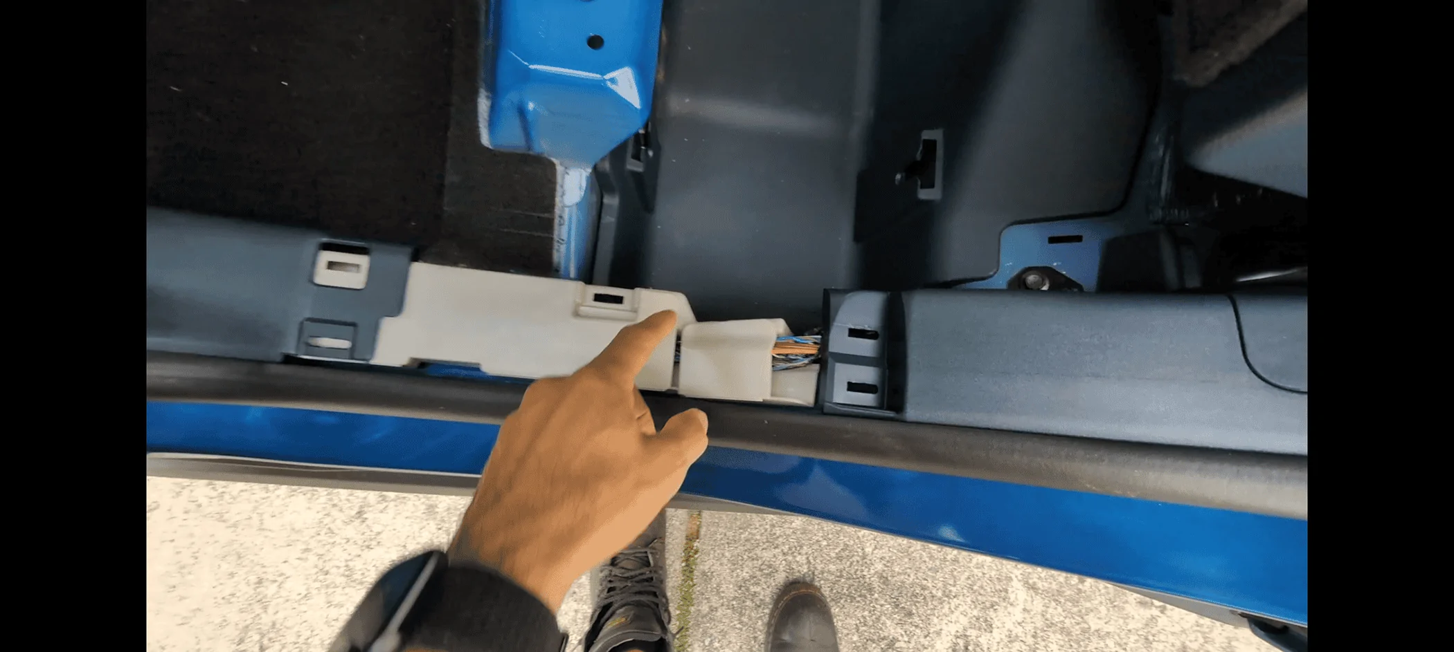

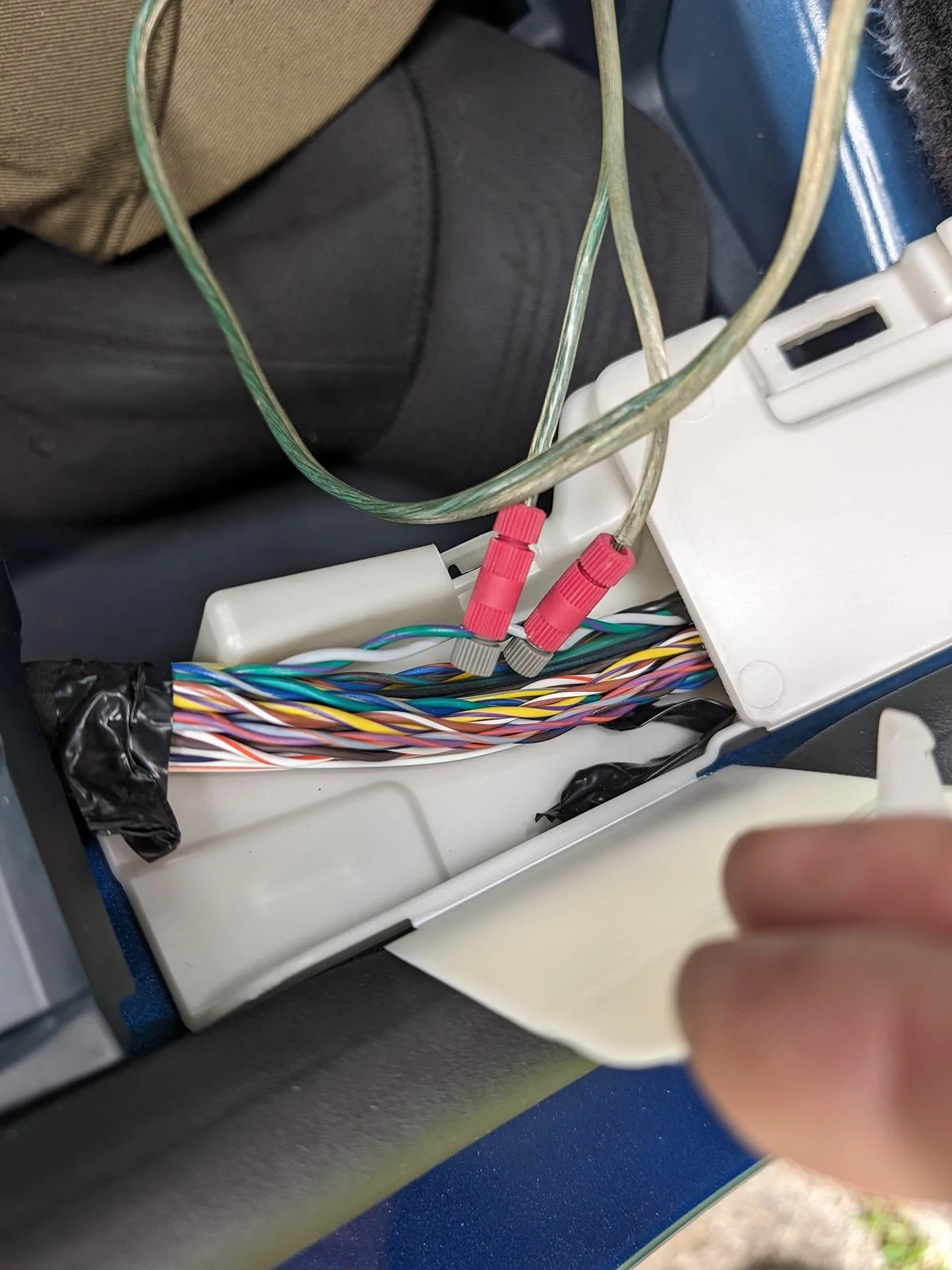

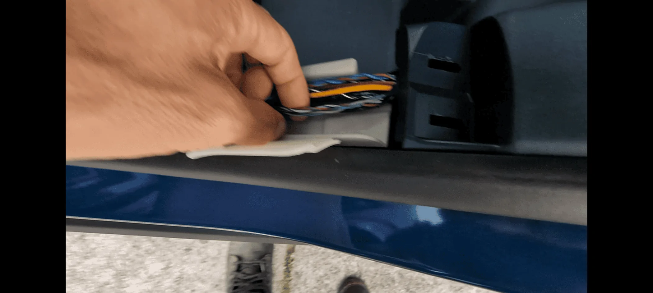

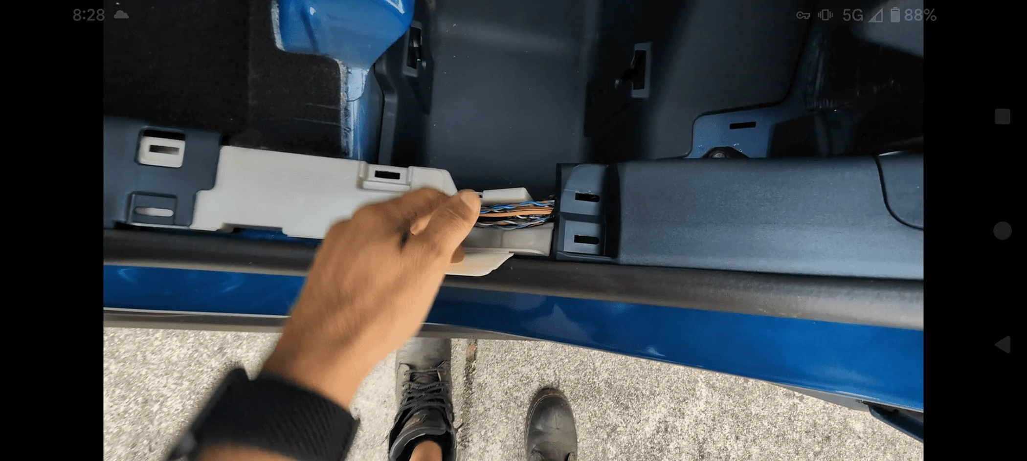

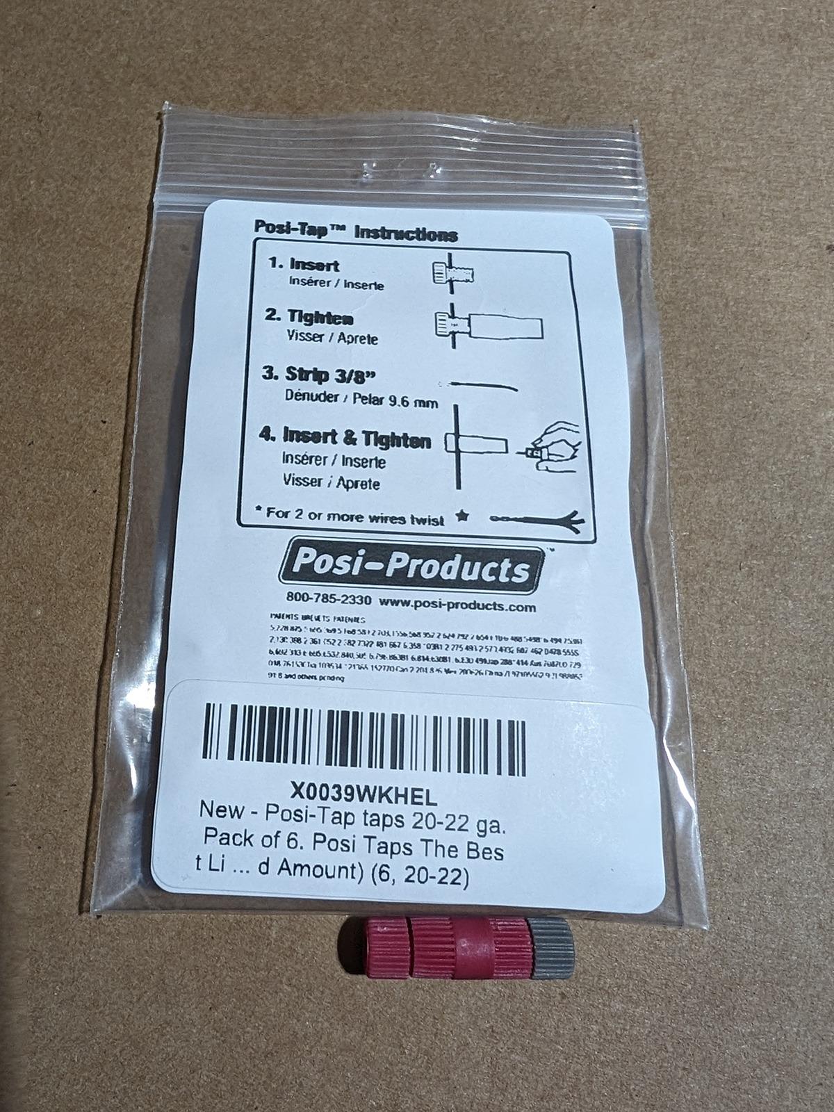

Occupancy mode needs to be set at "all" ? No sound came out but it powered on tapping into rear seat wires - 2 calls to crutchfield until I changed back to all

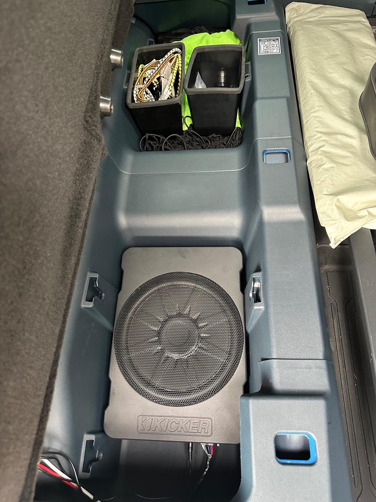

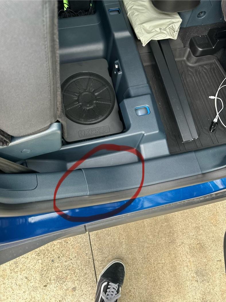

Ford Maverick Subwoofer install using rear speaker wires, no cutting or speaker panel removal occupancy setting--all seats
