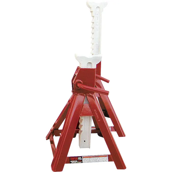

IDK how helpful this will be, but on our Badlands I use a 2' long PT 2x6 between the floor jack and the skid plate to raise the front end. Then I place 2 large axle stands with pinch weld blocks at the front lift points.
I feel perfectly safe with those axle stands. They are made in the USA and meant for much larger vehicles. Similar to these:

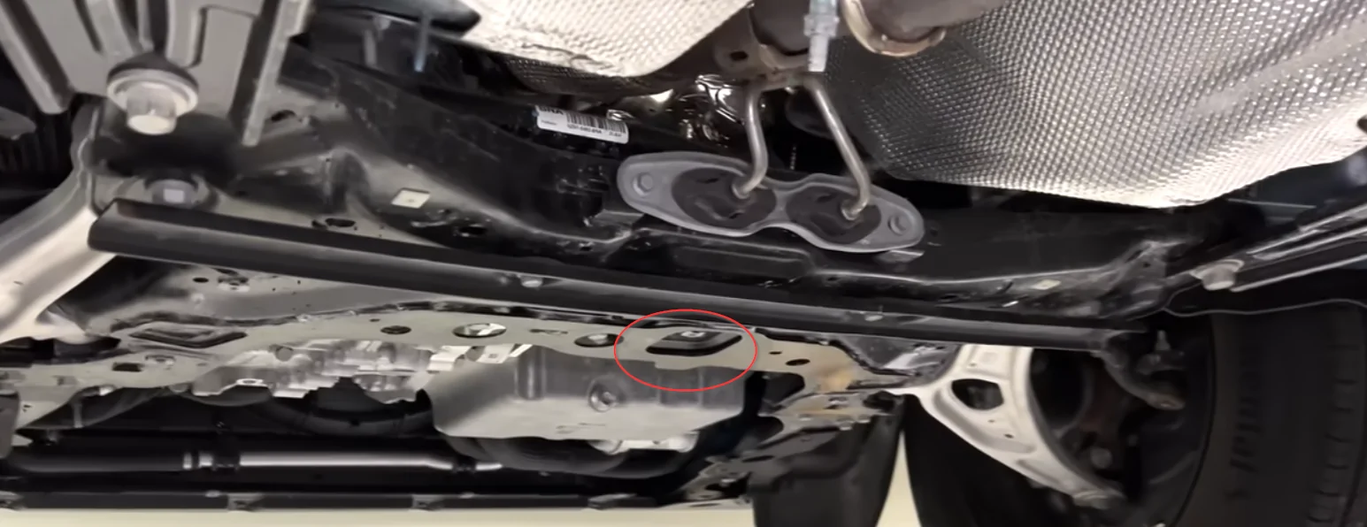

I just did an oil change and tire rotation on my Maverick. To get the front up, I had to jack it 2x, to get the 2 jackstands under the pinch welds. Then I had to lift it 2x again to get the jackstands out.
When I was under the truck, I had wish that Ford would have added something close to the motor mount on the subframe to support central jack point. Picture:

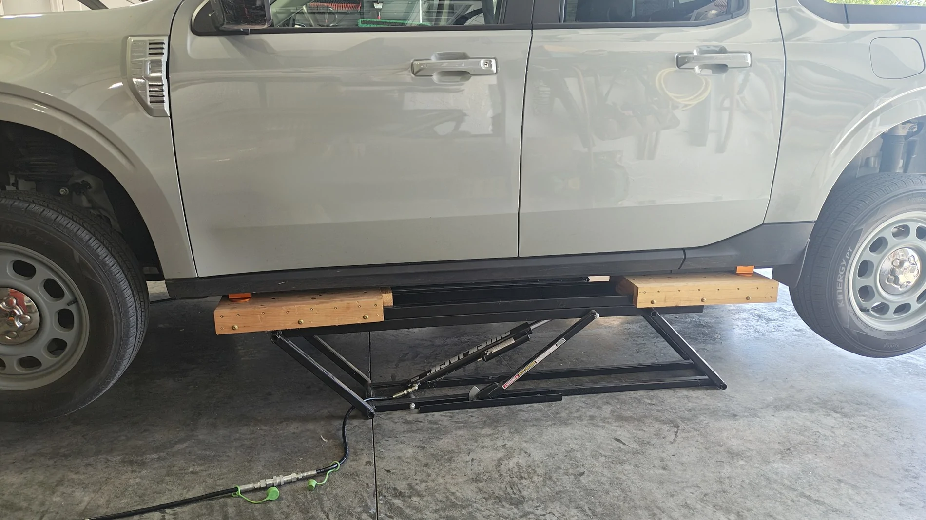

This is the way. Well, my way anyway . . .

Nice.
Whats the price point on that thing?
And where do you store them when they're not in use?

It depends on the QuickJack model: https://www.quickjack.com/
I've had mine for several years, the version in the photo is the BL-5000SLX I bought to work on a vintage sports car. Due to the Maverick pinch weld jack point locations, I added modified accessory SLX frame extensions that I use with magnetic pinch weld jack pads.
