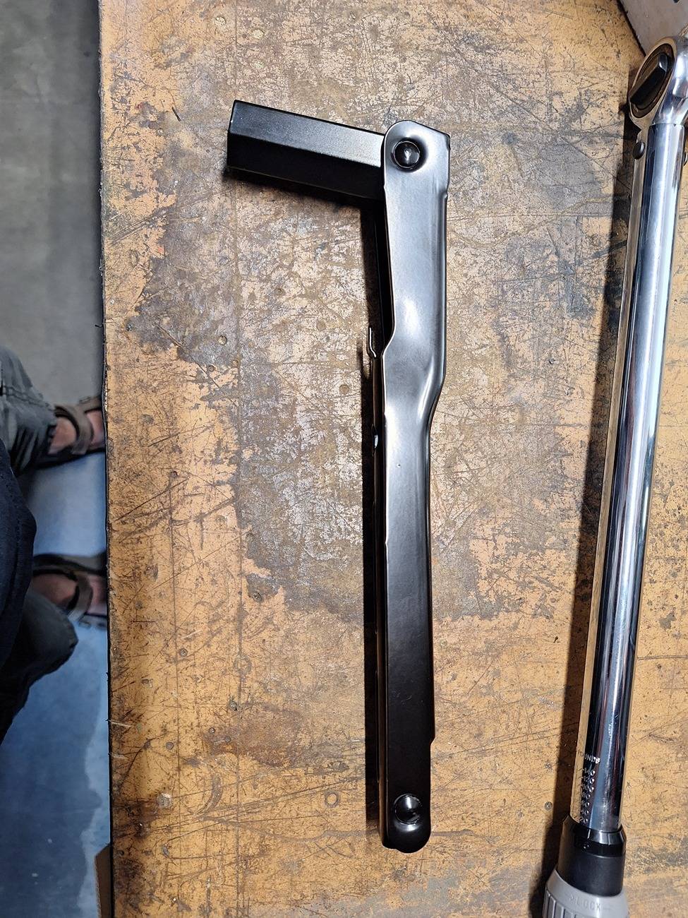

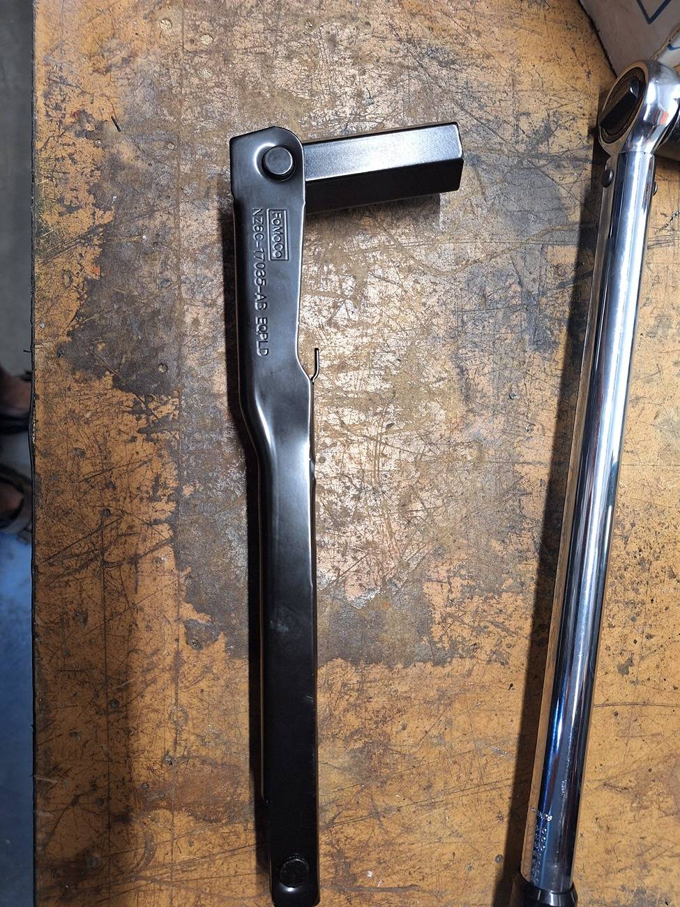

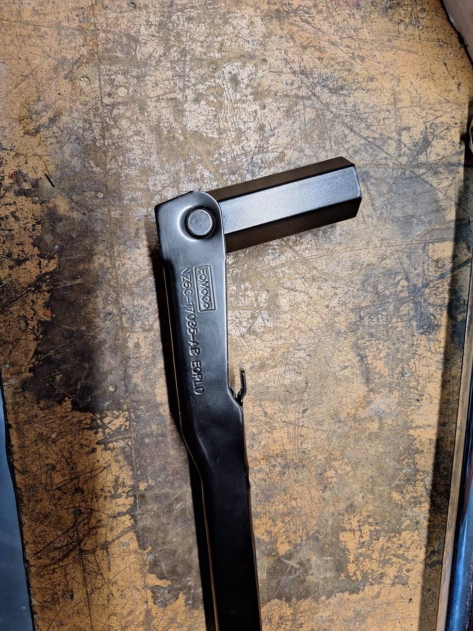

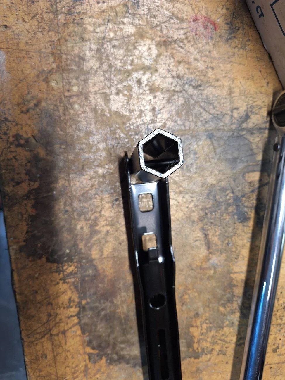

I decided to test my Ford lug wrench again. This time I torqued the lug nuts to 120 lbs. (148 is too much). The factory torque on my wheels was approximately 80 lbs. I removed and replaced 5 lug nuts using the Ford lug wrench. Attached are pics of the wrench after the test. As you can see it is undamaged. I wonder if Ford upgraded the lug wrench at some point. Maybe 148 lbs is the breaking point.

Thank you for the pictures.
So handy nowadays, literally everybody has a camera in their pocket.
Glad to see the stock lug wrench handled the job it was intended for.👍

I actually ditched the jack handle and jack since I replaced both but kept the rod that lowers the spare.. in all fairness it only looked mildly tweaked when not in use after twice attempting to use it. It was while torqing on lug nuts the degree of twist got scary. Look, if anyone is happy after attempting to use it, good on ya. I just encourage everyone to at least try it before needing it in an emergency

You have great shots of the jack handle. The socket part was plenty strong enough, the problem was where that part is riveted to the upper arm. That upper arm is what started bending severely. The socket part is plenty strong. It held securely to the lug nut.
