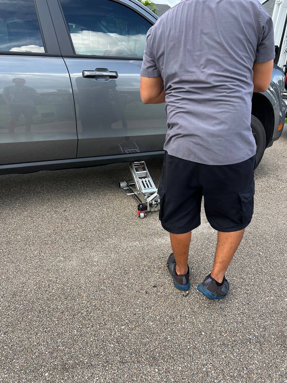

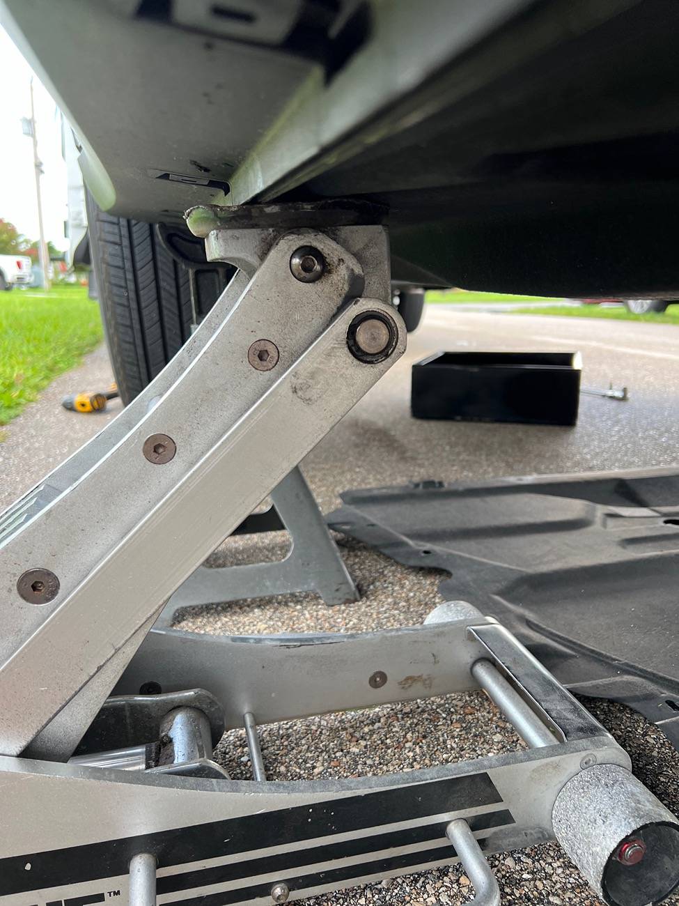

Did mobile oil change, this is where the tech jacked the truck at
Ford Maverick Floor Jack & Jack Stand(s) at Pinch Welds IMG_1432
Ford Maverick Floor Jack & Jack Stand(s) at Pinch Welds IMG_1423
