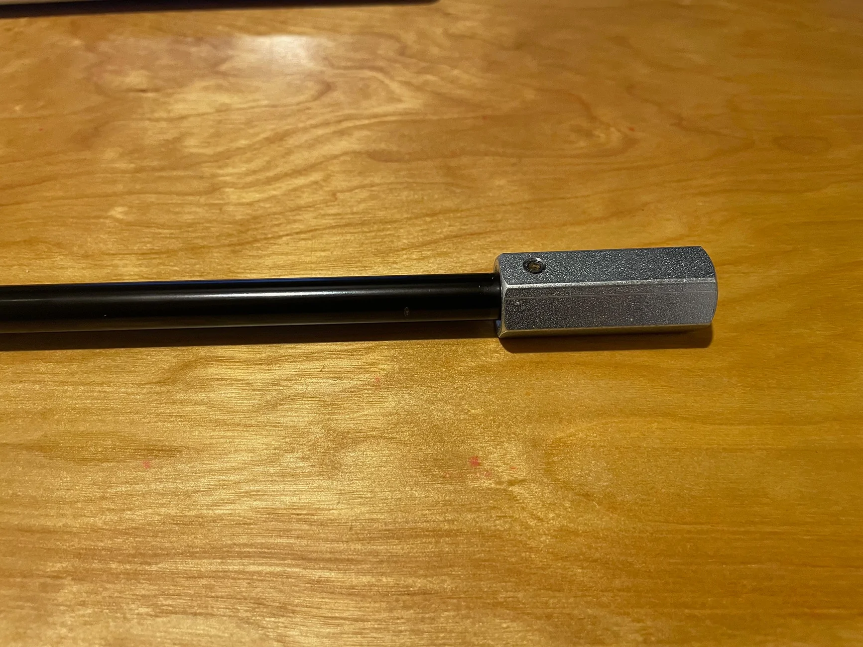

I found a suitable alternative in the Steelman #96095 Standard 12mm Square Head Spare Tire Tool, available at Amazon. This tool is reasonably well made of welded mild steel but needed a tweak to be perfect for the Maverick. It's made for full-size trucks and is 10" longer than the Maverick requires. It also has a 7/8" hex drive nut, slightly larger than the 21 mm lug nuts on the Maverick. I made two mods, but either would have sufficed on its own. I machined the nut down to a 21 mm hex, and also bent that extra 10" into a hand crank (with a MAPP gas torch). In retrospect, I could have simply cut off the nut since the Maverick's cable winch should never need more torque than the crank could provide. It works very well, and clears the trailer receiver by about an inch and a half.
Murphy's Law should now ensure that if I carry this, I will never, ever get a flat. :fingerscrossed:
Thank you for posting this, I stole your idea,,,,,
Cut 7" off the length, and found a threaded coupling w/a 13/16" hex (same as the lug nuts). Now I can use my impact or a lug wrench to lower/raise the spare. Time to toss it behind the rear seat.

I believe everyone who drives a car should be able to change a tire if needed. I made a dry run under ideal conditions in my driveway and found the experience worthwhile. One of my discoveries was that you can only lower the spare when the tailgate is CLOSED (and preferably no trailer is attached) so don't pick up any nails with a load of 4x8 plywood. 🤬 Another epiphany was that I really don't want to have to dig out Ford's emergency tools from behind the seat when I'm doing routine maintenance and want to lower the spare.
