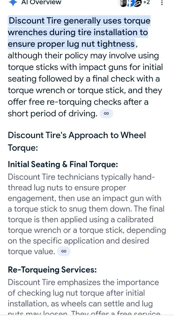

Thanks to all for the heads up about the lug wrench and jack. Heading out on a couple of road trips shortly. Just came back from Discount Tire with a new set of Defender 2's and I'm sure those boys put the lugs on to stay.
Glen Baker LLC
May 29, 2024
8,989
16,399
Central Nevada & Utah
Maverick XLT Hybrid
Discount Tire will look up the torque specs for your vehicle and finish by hand torquing them to spec. Which will probably be 140 ft pounds.
