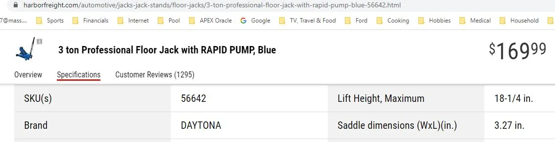

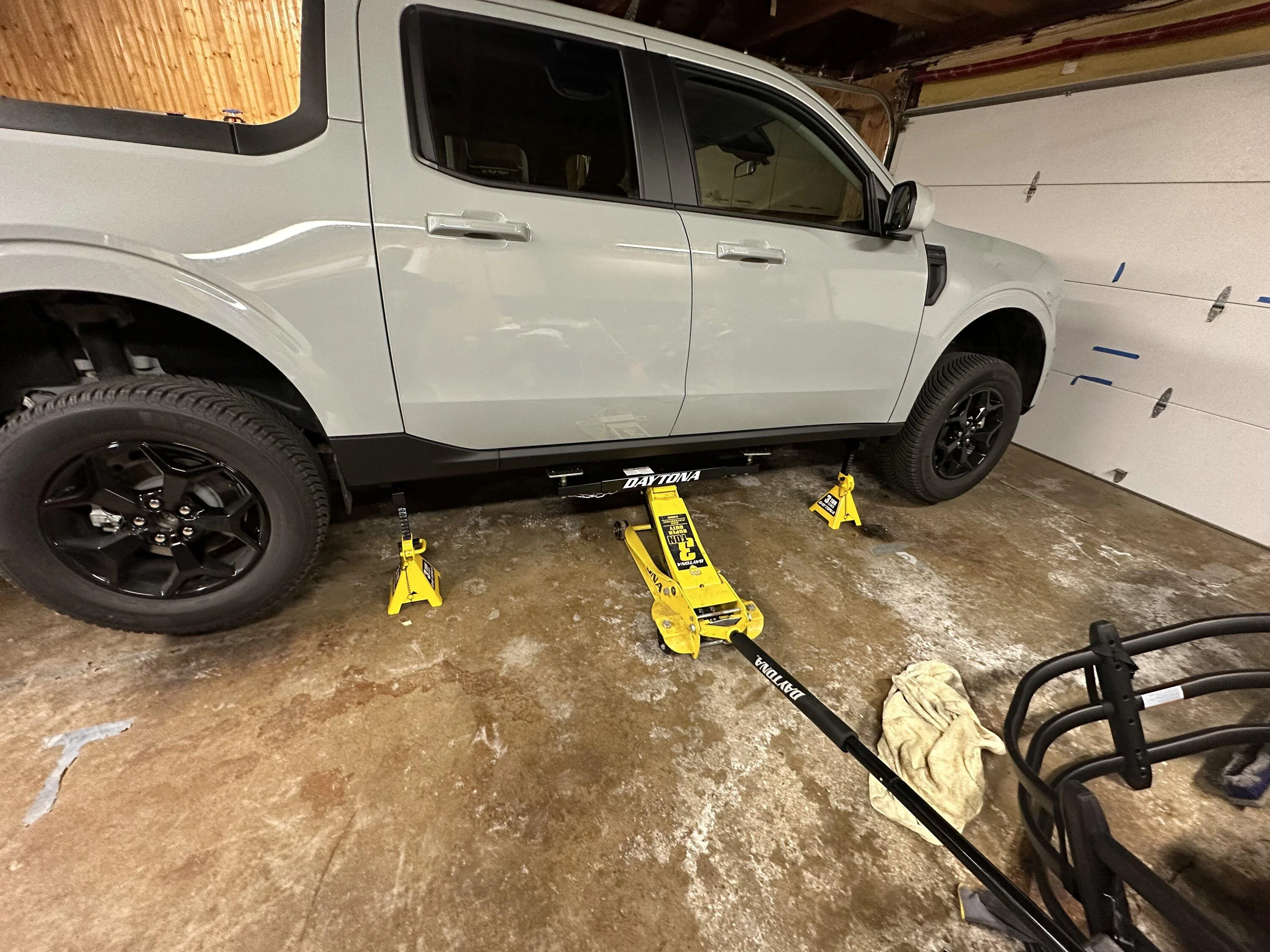

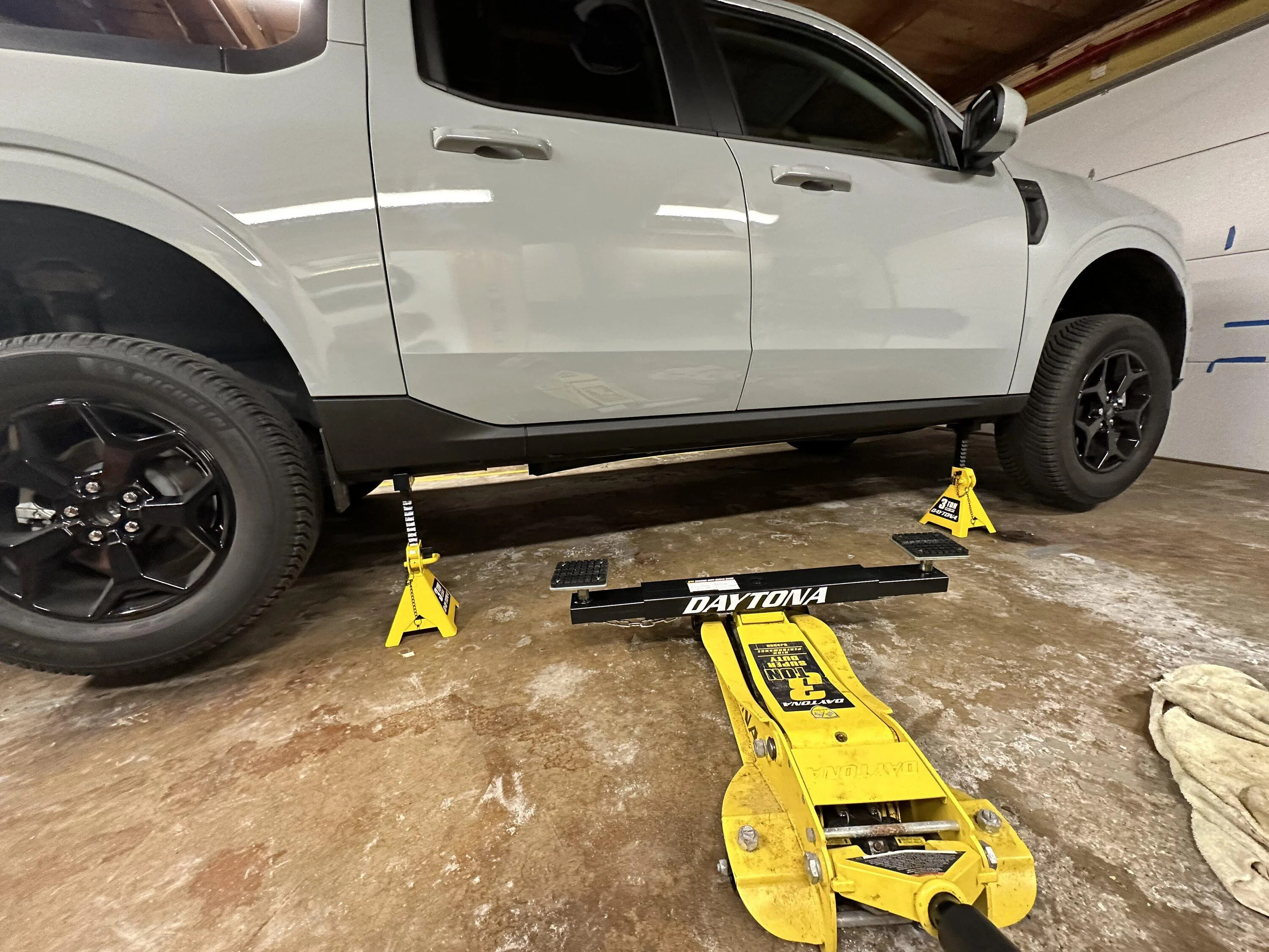

I wanted to get this but learned the floor jack needs a 1-1/8 “ diameter saddle stud. Jegs own floor jacks do not have this. Saw the next post with the Daytona cross beam and bam, works great!
Noticed one lift put a grove on the beam pad. Going to shift it towards the front where more weight is. If that does not help get some pinch weld pucks.
Oh, for whoever was debating on the smaller tonnage jack I would not recommend. not saying it can't be done, just with precision control and the extra ton capacity made this a breeze

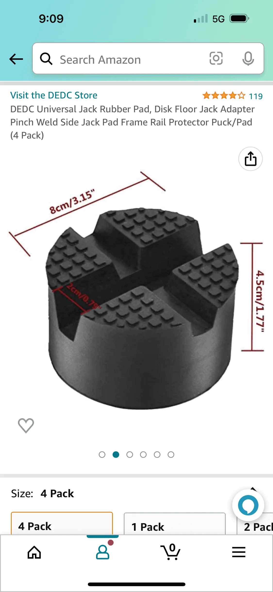

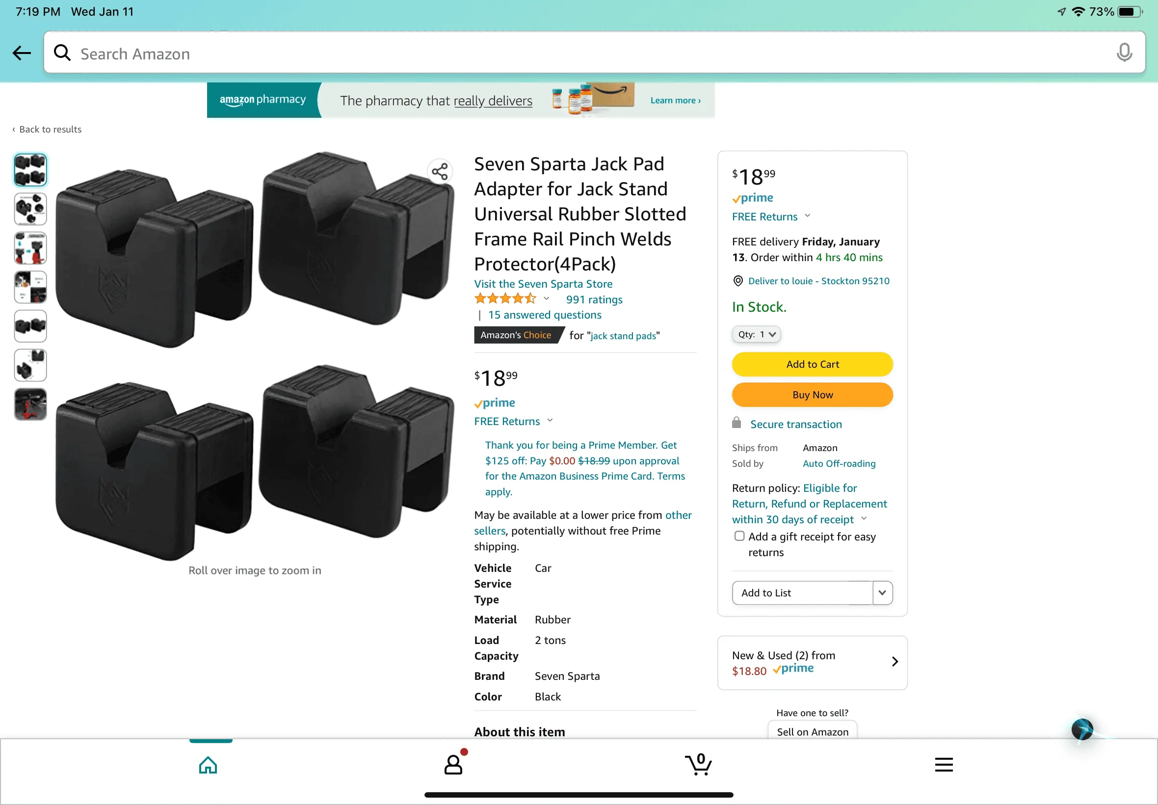

Here’s what i use

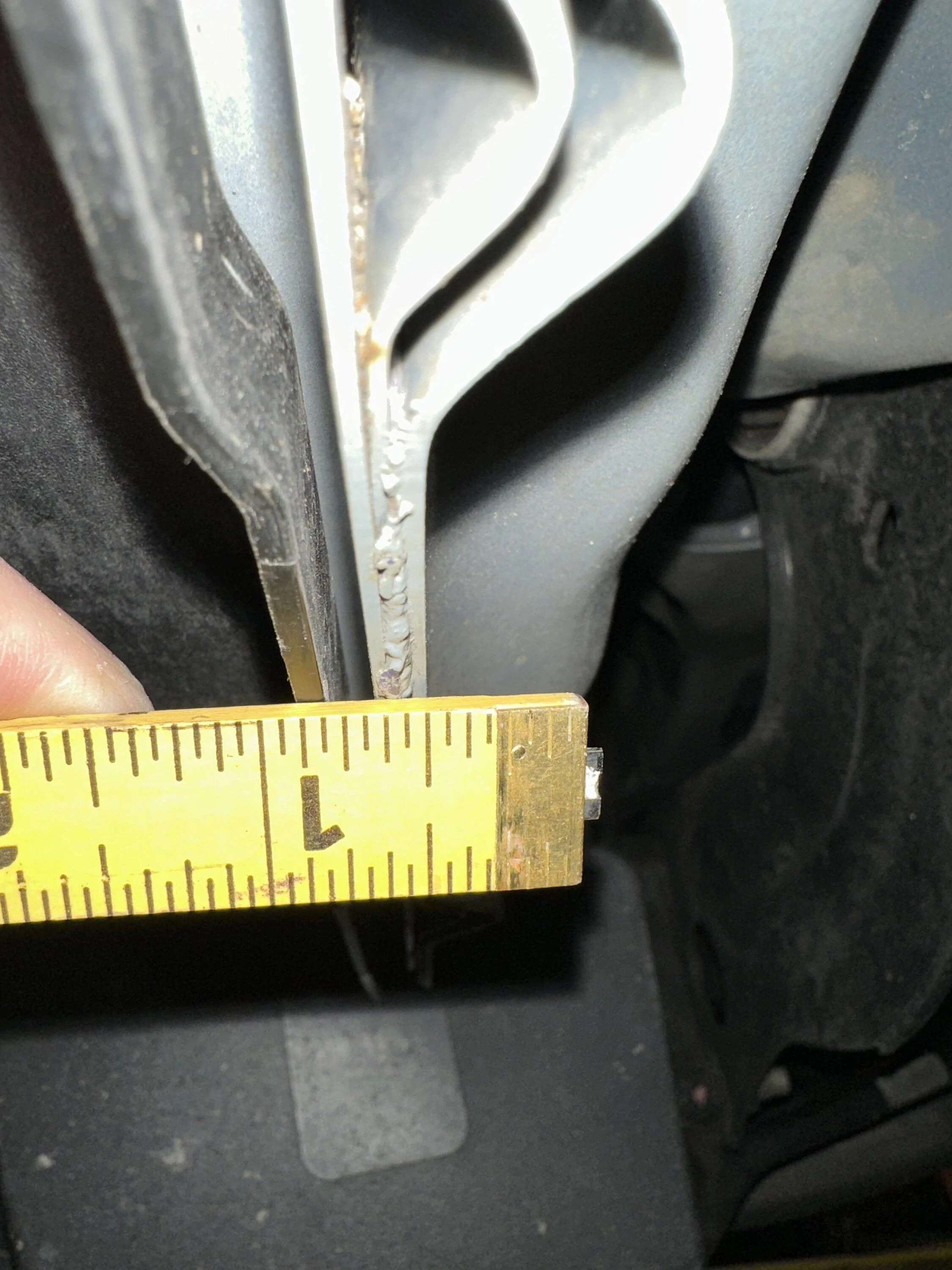

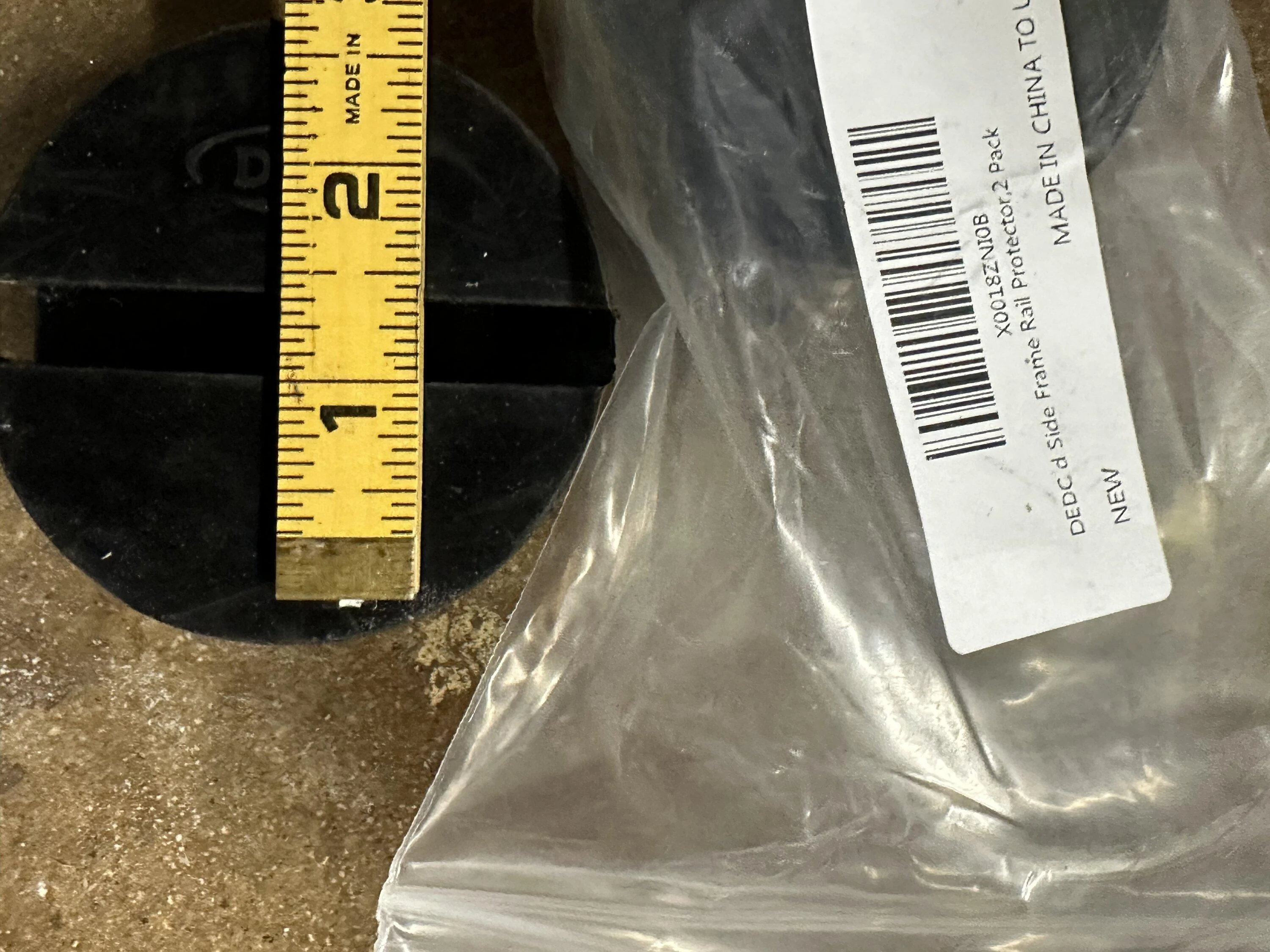

I bought almost the same ones. Jack stand ones were loose on my stands. The floor Jack one won’t fit over the pinch weld because the black plastic trim. The pinch and plastic at the designated area is 7/16”. Other spots for the floor Jack are 5/8”. The adapters on Amazon the one I bought said 1/2” for the grove. They lied. Maybe 3/8” in china =1/2? Either way, didn’t fit because of fords plastic shield
Give me a minute to think about this before you return them, we live near each other. I have to look at making a jig & using my router or table saw and widen the opening. How deep is the slot, what is the OD of the puck?

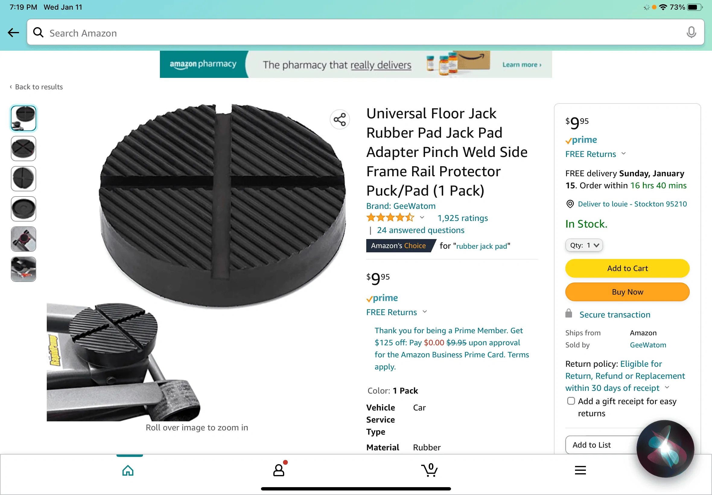

HRG
Thank you. I found this and ordered it late last night. Claims to be .79” so should be good for a half inch
OK, let us know how those fit. I measured my floor jack this morning, I have the 1-1/8" hole for the centering post on the crossbeam.

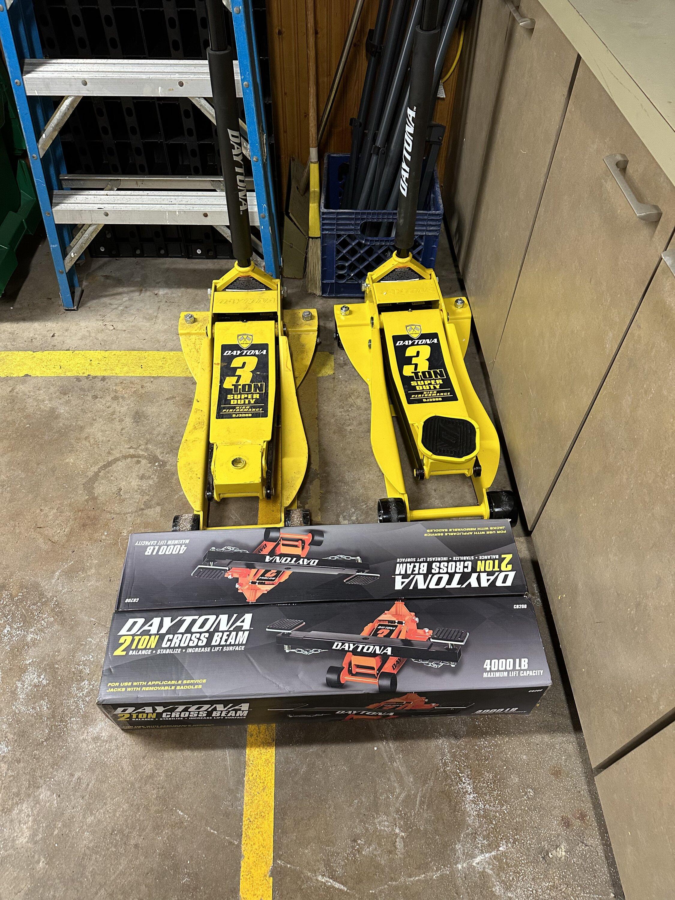

Just a warning for those that may want the Daytona crossbeam lift. I liked it so much and always wanted another jack so went and bought another!
Ford Maverick Floor Jack & Jack Stand(s) at Pinch Welds 993115E3-0EF1-453F-96E7-F4A76D45121B
They work great! The warning?
1st one I bought was good, had the jack for years already.
2nd jack is fine but the crossbeam bolt had bad threads. So did the 3rd. Next run I bought my jack to harbor freight and 4th bolt was bad. 5th one worked like a champ!
Get that one home and the damn crossbeam weld was cocked and made it impossible to thread in the bolt!
Brought the jack back again and the 6th one had a bad bolt.
Lucky number 7! Yep, found two good complete cross beams out of 7;)
They are out there but just letting y’all know ya might have to search awhile and bring your jack with you to save time!
Had I known I would have kept the Jegs and bought a jack to match it.

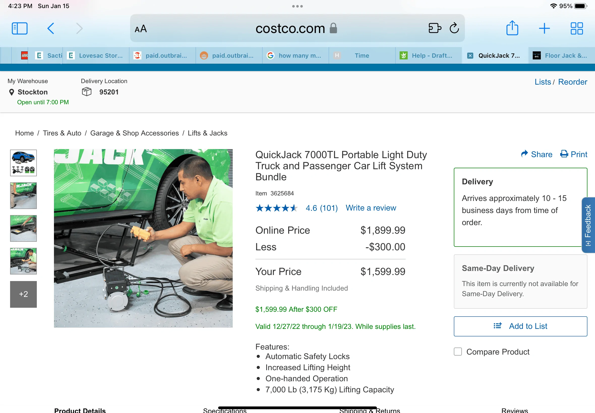

I just order this, I’ll give it a try and if it doesn’t work back it goes
@Wnbasac any update on how you like the QuickJack 7000's? Do they fit your CRV as well?
