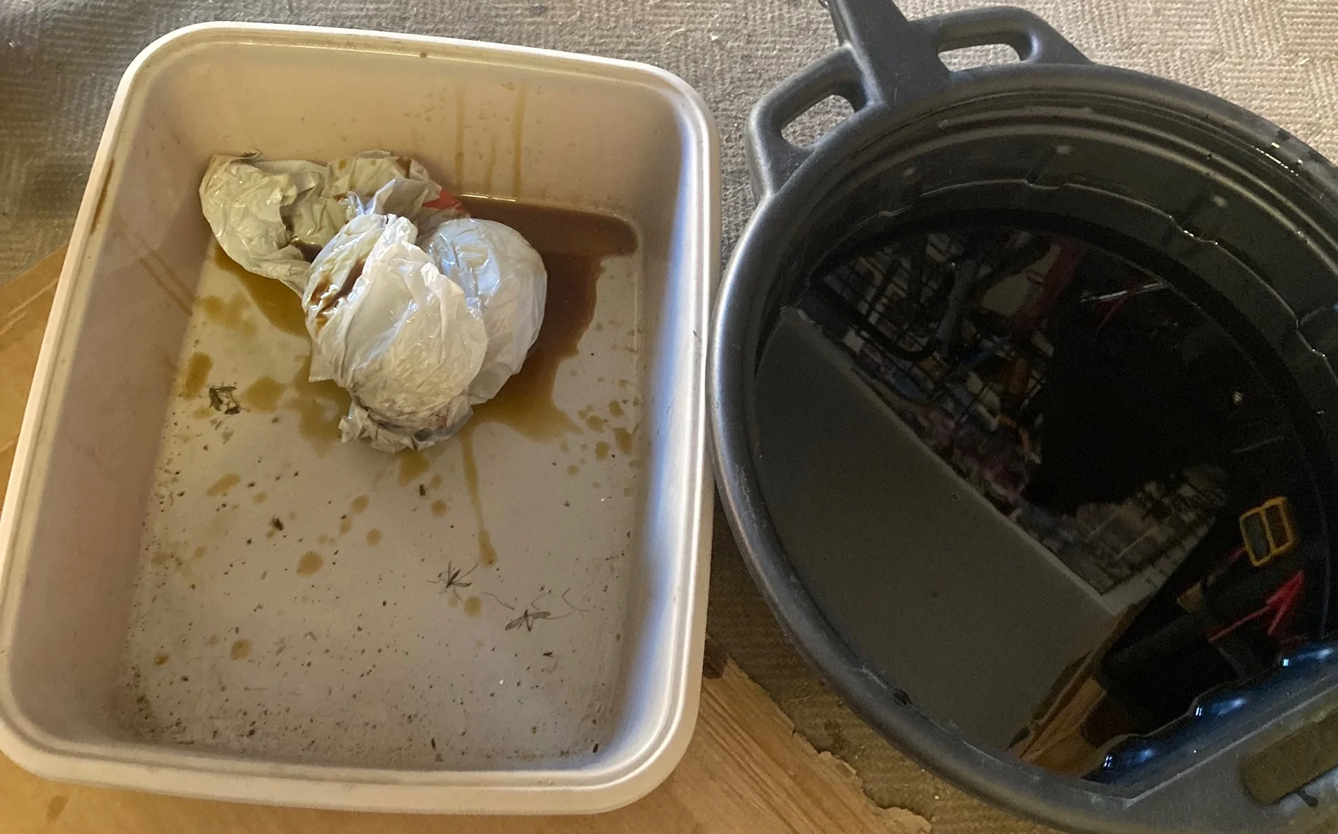

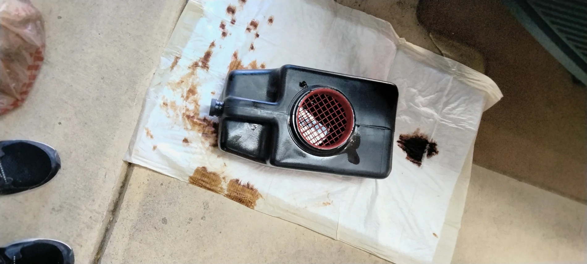

I can never do an oil change and keep things absolutely clean.
I started using puppy pads underneath the drain pan.
Now, I just use Walmart underpads. They're absorbent and they are better than newspaper. Probably cheaper than newspapers nowadays.

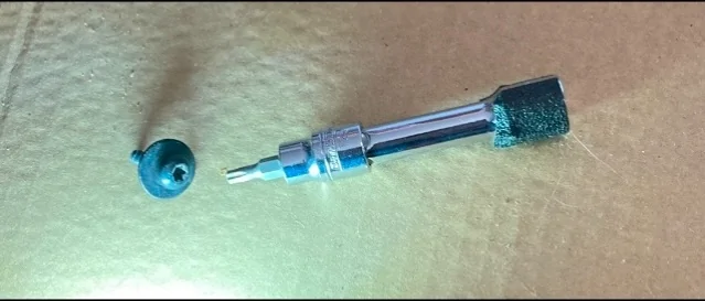

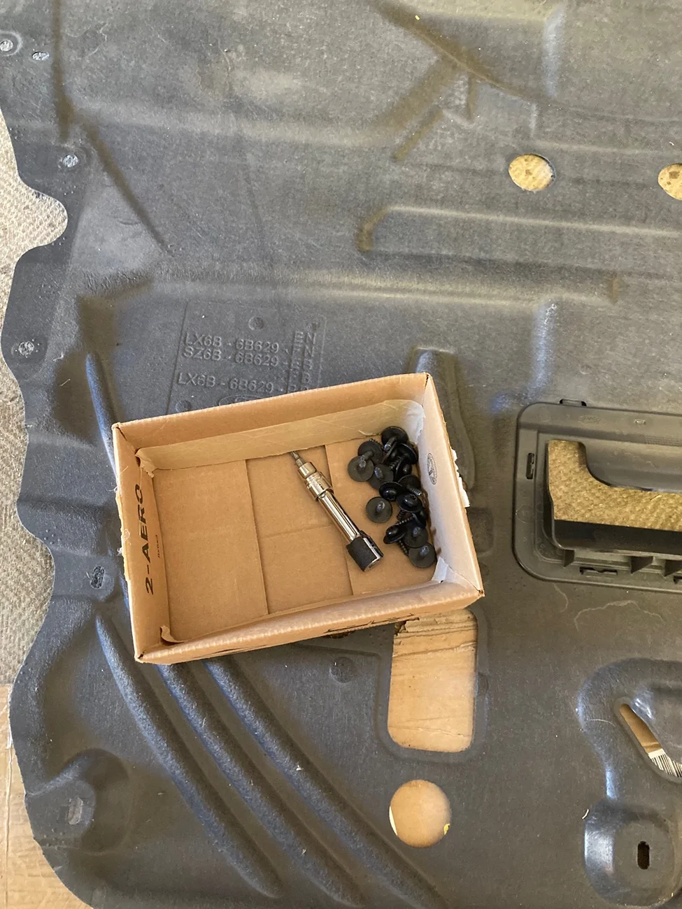

During my first change, I made this little bit/extender tool to easily remove & replace the 15 cover bolts. I firmly hand tighten my filter (18 or so ft/lbs) so I won’t need a removal tool unless I’v gotten weaker. Did use a tool to remove the OEM on first change though. Was probably around 20ft/lbs tight…
I just put the T30 bit in my battery-operated electric drill.
Good luck.
Never even thought of using that. Great idea. I usually just put a piece of cardboard under there, then the catch pan on top of it.

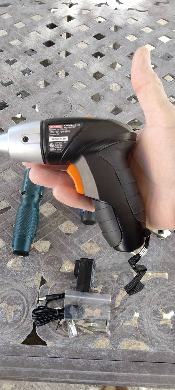

After my first oil change. I knew I had to find something small and powered to handle the 15 screws that hold on the splash pan in place.
I found this one at harbor freight for $10. Probably cheaper on Amazon.
The only thing I use it for is oil changes. I charge it the night before.
It worked great.
