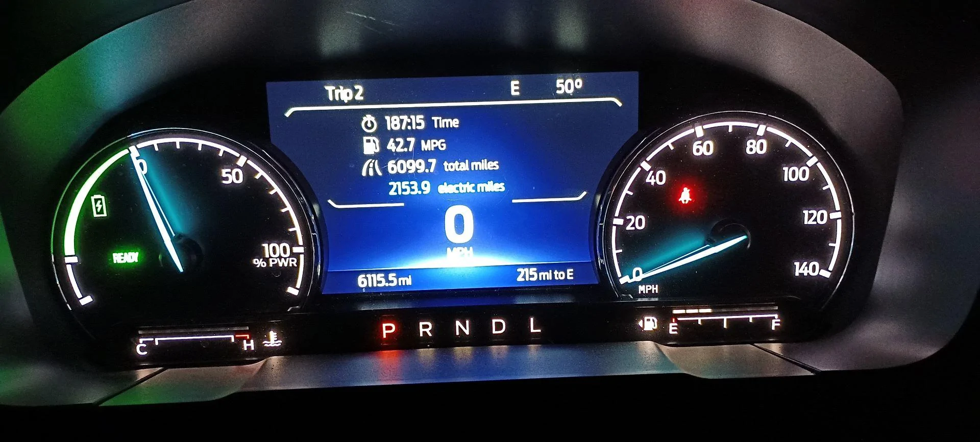

The small factory filter on the Hybrid seems more robust than the Motorcraft FL-910S, hell a Mobile 1 extended filter looks and feels better made, but oh gotta do what Ford says or they'll void your warranty. I'm doing my first oil change today at 5800 miles and the oil was dark coming out. I do mostly rural /suburb driving, but did go on 2 long trips in the past 2 months, Chicago to Nashville and Chicago to Virginia so I'm not waiting on the app. every 5000 is my goal.

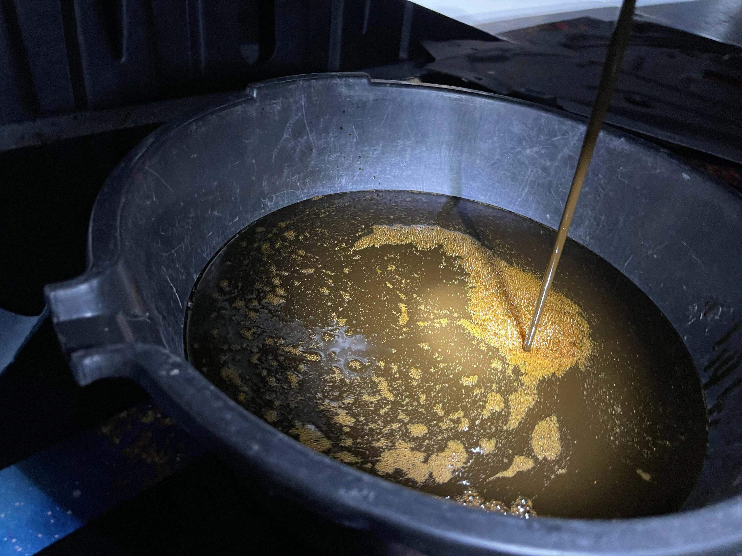

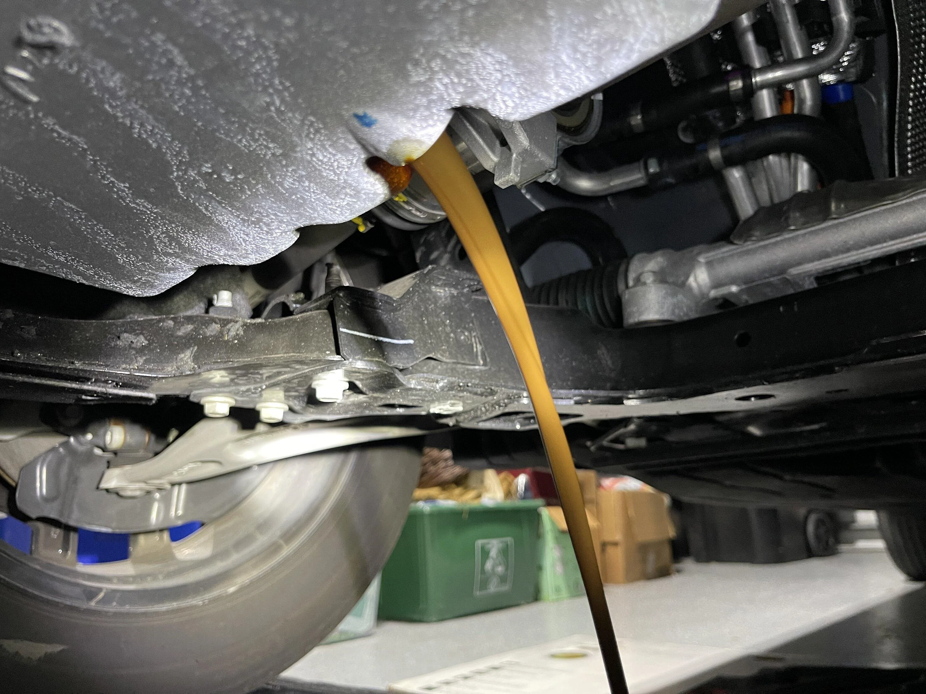

Just changed mine for the first time at 10,500 miles. Vehicle stated 25% oil life remaining, but I didn’t like the idea of letting it go past 10k since that’s what Ford recommends in the manual.
I do mostly highway /city driving. Hot Florida summer, but keeping it usually no higher than 70mph on the highway, and 45-50 around town.
it was quite easy to change the oil on ramps, far more accessible than most other vehicles I’ve changed oil on.
One thing of note: I will be changing my oil much earlier than 10k miles since the oil came out with a very dirty consistency.
Chocolate milk anyone? Mine was dark at 6000 miles. I don't care what the computer says, 6 Months or 5000 miles for me. $30 at home full synth oil changes are too easy.
