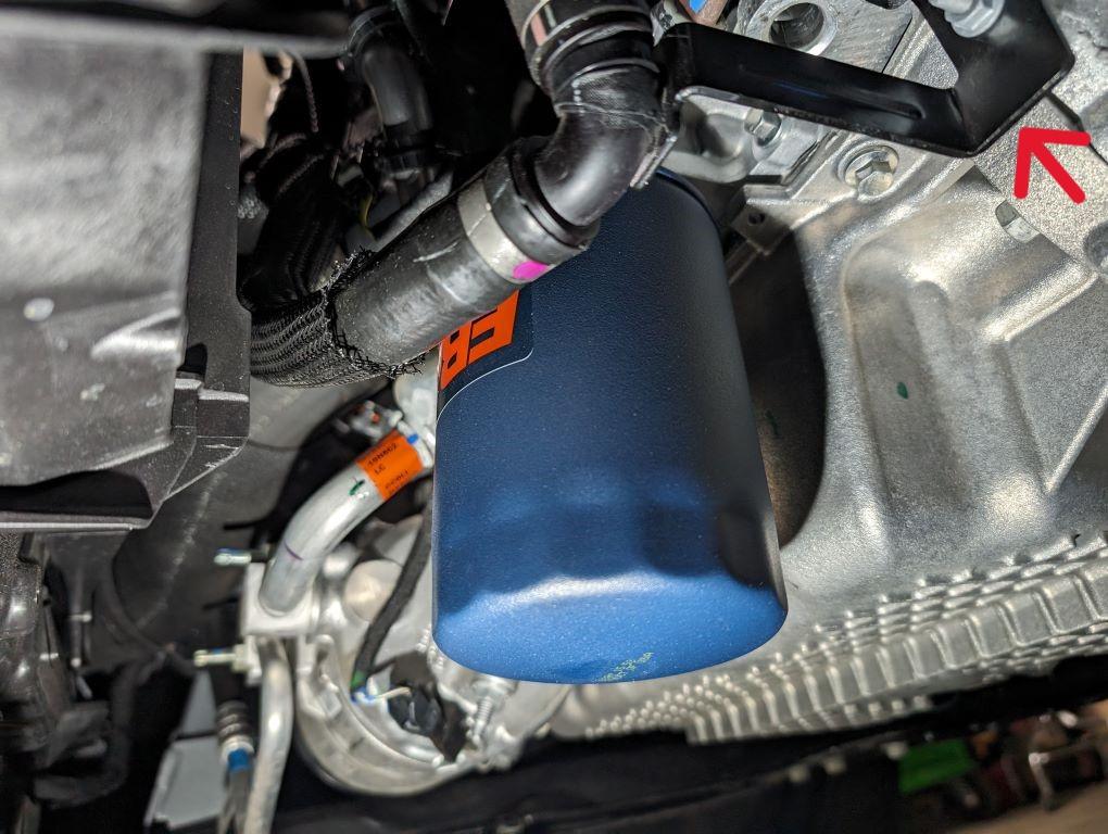

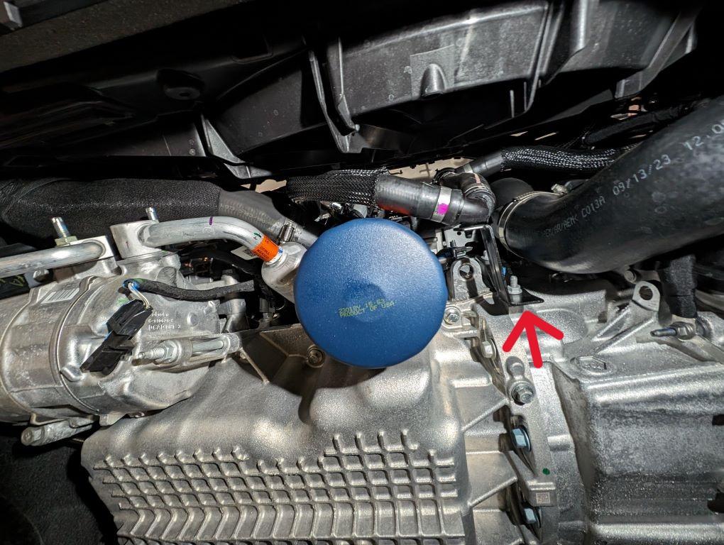

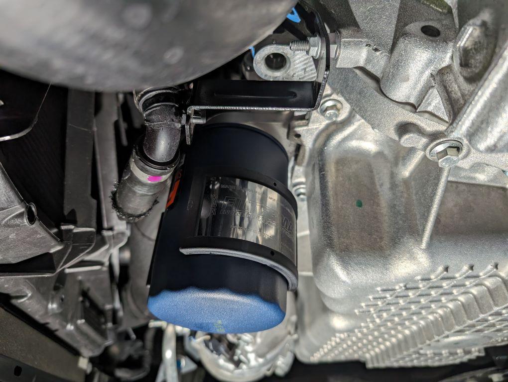

Plenty of info out there about how to do oil changes, this is some different info. Passing along a couple of my oil change tips - some just for the Maverick and some I've developed over the years.
First, specific to the Maverick EcoBoost - I have a 24 Lariat w/ 4k tow, but believe all will be the same. You can run the traditional FL1A size filter on the Maverick. No clearance issues with engine or under shield or anything other than a cooling hose, which is taken care of with the slight bend. The cooling hose is near the oil filter and is held in place to the engine with a stamped steel bracket. If you bend part of the bracket slightly toward the front of the truck with a pliers wrench or similar, it doesn't cause any clearance issues with the hose, but it does create more space for the bigger oil filter. It's easy to bend and doesn't take much movement, but gets you the extra clearance. I put arrows in my pictures where to bend. Essentially you want to make it about straight up and down vs. bent back toward the engine like it comes. If running a bigger filter for essentially the same cost isn't enough, the extra oil capacity is a nice bonus. Not only for extra oil itself, but with the FL1A sized filter, the oil capacity goes to exactly 6 quarts and reads right at the full mark on the dipstick. No more measuring and storing half quarts because 5.5 quarts is just plain annoying. I am running a Fram Synthetic Endurance filter in the pics, I happen to think it's the best filter on the market (basically a different color Royal Purple filter), but you can run a FL1A or any filter of that size, like a Wix 51515 or similar.

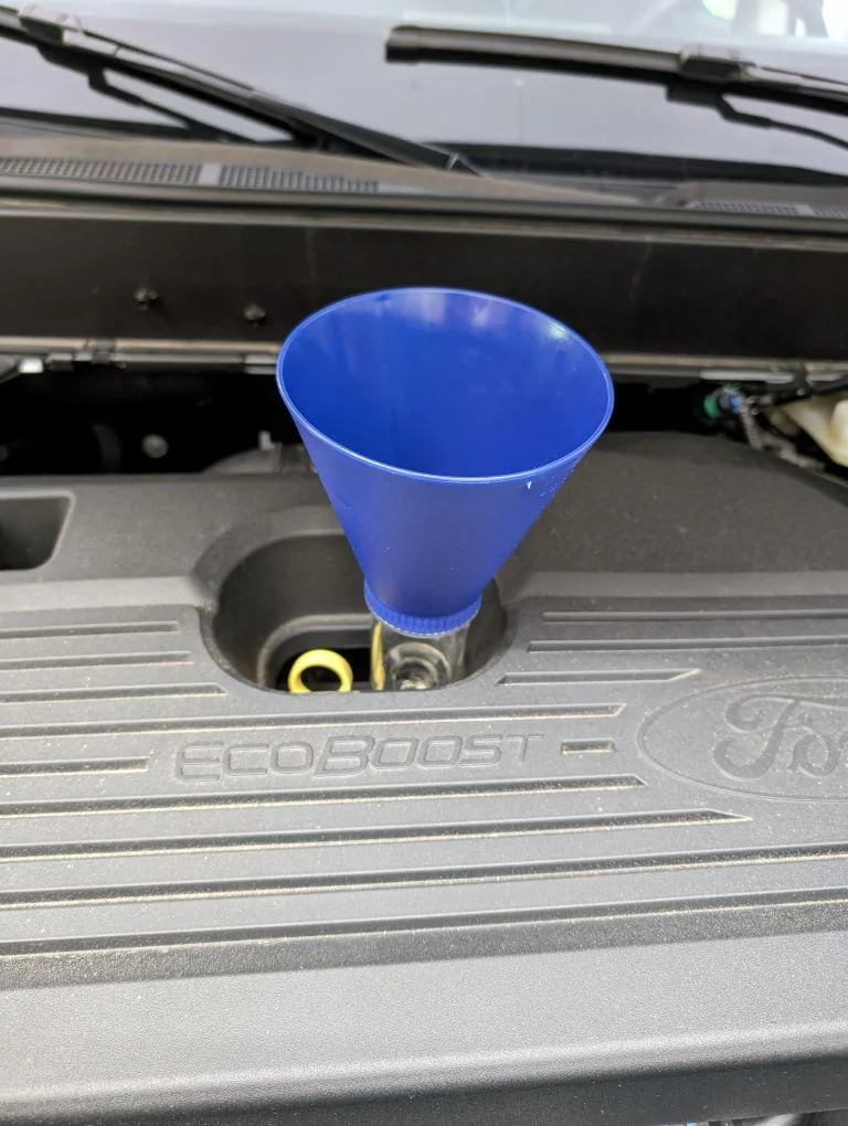

Now for generic tips I have picked up over the years and believe help with ease of oil changes and longevity. First, there are companies that make funnels that screw in place of oil fil caps vs. traditional funnels that just sit in the hold or maybe lean against things and stay in place if you are lucky. They are more expensive than traditional funnels, but to me - the ease of knowing I always have the exact funnel, it won't spill or slip or leak or anything that can happen with other funnels is worth it. They are sturdy enough you can even leave the oil container in the funnel if you like to get the last drop out of them. I've been using them for years on different vehicles. You can buy them in sets or individually, and I believe they are basically all the same. The one I got for my Maverick is made by MichaelPro and came from Amazon. It's a nice snug fit, and if you give it a chance, I think you'll like them for all of your vehicles.

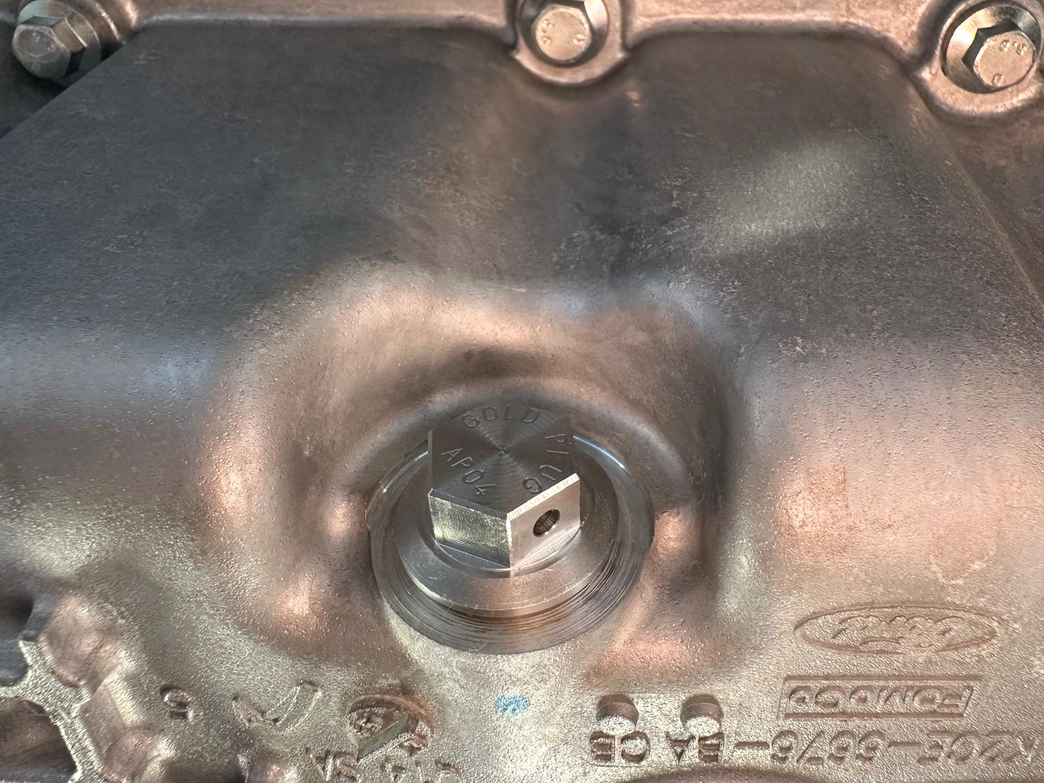

My last tip, is for longevity. Also for years now, I have been running GoldPlug magnetic drain plugs in my vehicles, as well as FilterMags oil filter magnets on everything with canister style oil filters (including my Zero Turn mower). The GoldPlugs are surely enough by themselves. I like them because they are high quality, very strong magnets, made in USA (Montana), and the selection is good enough that you can get one that is the exact specs as the factory plug - so it uses the same wrench, etc. I find it pretty typical to get a gray film on the end of the magnet at each oil change - and that is stuff that would be floating around otherwise. The correct one for the Maverick is AP-04, and spare crush washers are SW-01. You can buy them from several places, but here is the official link:
https://goldplug.com/shop/ap04/

I just changed my oil about an hour ago and noticed there is a under carriage opening right where the oil drain plug is located so I was wondering if it can be removed to avoid having to remove like 10 or 12 torx screws to remove the cover. Here is what I found in the pictures, I think we can actually remove it with just a screw and put it back w/o issues

I use the same drain plugs. Love the quality of their plugs. Thanks for the info on the funnel. Just ordered.

One more quick tip: You can limit the mess from filter removal by first placing a quart-sized plastic baggie around it. Loosen the filter enough that you can turn it by hand, but not enough to start leaking oil, then place your baggie around it being careful to ensure the top of the baggie is above the top of the filter. Finish turning the filter out by hand and all the oil that would normally drain out over your hand will go in the baggie.

I would have a problem about having the oil filter being below the more robust oil pan as compared to the oil filter "thin skin" !

I ended up going with a Stahlbus over the magnetic drain plug you linked. But I have it saved in my bookmarks for future reference. The link is correct for the EB's regardless of what Amazon says - same as OP's drain plug it's M12x1.75.

The magnet around the filter seems like a no brainer and great idea. However the drain plug quality, even though I'm not concerned with it being magnetized is fantastic! I just don't see it as impactful as magnets around the filter medium itself. But that drain plug looks a real good!
