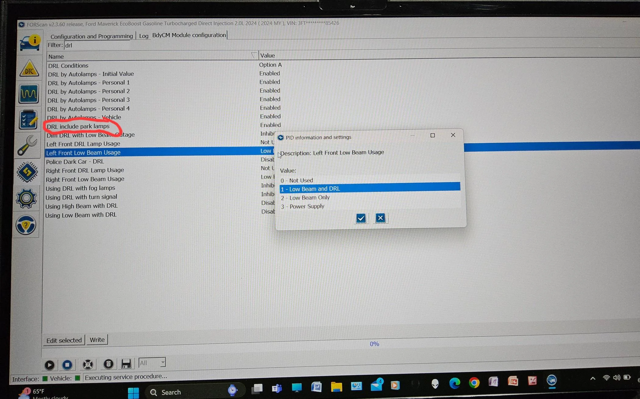

This is what I get for drls, no parklamps show as option...
Are you using your low beam as the DRL? I'm assuming you made the same change on the right side low beam? I'm using my front turn signals as DRL.
Toddman45
Todd
May 21, 2024
2,020
2,843
St. Louis, MO
I don't have that option shown in forscan for turn signals as drl

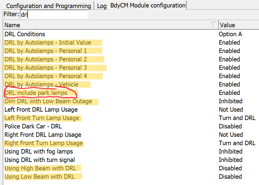

I have a US XLT Ecoboost and followed snowcatxx87's changes with the exception of Left/Right Turn Signal Usage. I have Switchback front turn signals and left the both as Turn Only. I wanted the low beams OFF with the white of the Switchbacks being my DRL's. This is exactly what I got with the changes.
I know that the lights don't look bright enough but I think this was just because my camera was looking up. I did drive to a storefront glass and the lights are plenty bright enough.
Things I noted in my process.
All my DRL's by Autolamps were already enabled, but my DRL include Parking Lamps was disabled. Another one was Using Low Beam with DRL. Both of these were not addressed in the original post. I know that I enabled the first and disabled the second during my attempt to get this working.
I also had the RIght/Left Front High Beam Usage set to "not used" (left) and "power supply" (right). I was a little concerned with changing these since are set as they are and didn't appear relate to the low beams. I went back and changed both back to their original settings and tried the other options. All selections except "High Beam" for both made my low beams flicker instead of going OFF. Since one of the settings that didn't work for the was "Auto High Beam", I hope it doesn't interfere with the Auto High Beam feature..

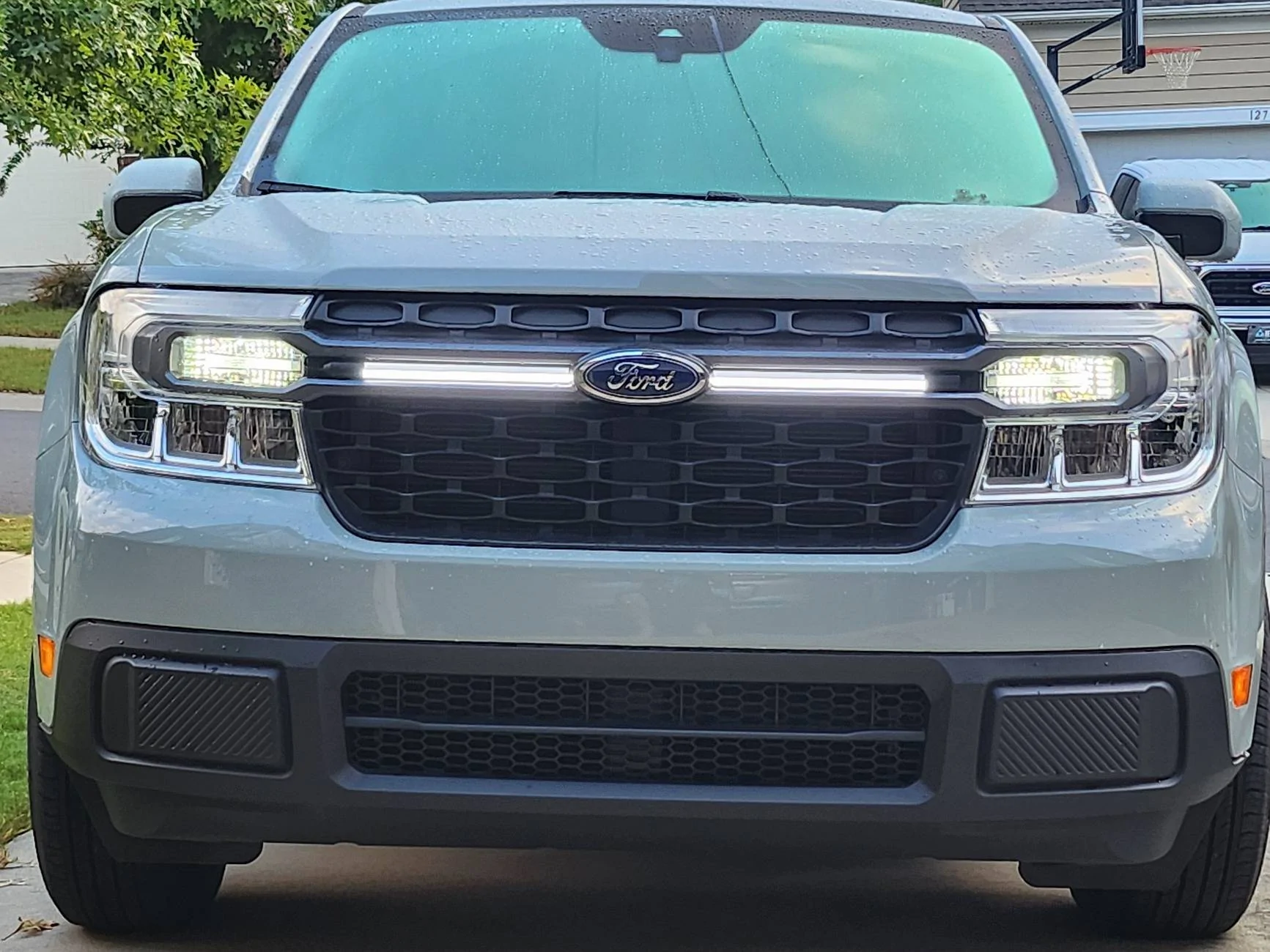

Drl park lamps and lightbar working, however lights seem to come back on after opening doors. Can this be fixed with police dark mode or something else?
Ford Maverick DRL as Turn Signal at 100% - No Low Beam - Working. (XL/XLT) 20240817_071235
Nemo
Feb 15, 2024
79
81
24 Maverick XL
Thanks @snowcatxx87 for working all this out.
Got it going on my XL with switchbacks (yellow turn light is on, wish the parking white light was a separate circuit). One other thing I disabled was lamp burnout notification since the switchbacks are Diode Dynamics LEDs without the resistors. Only thing I can’t get rid of are two codes in BCM, B14E5 and B14E7. These codes are for left/right front enhanced exterior lighting system. Read on the Bronco forum that this happens when headlights are swapped and need to be reprogrammed with a Ford diagnostics tool. Probably because of all the changes, something no longer matches. No check engine light just a code visible via FORScan. No big deal, just annoying.
