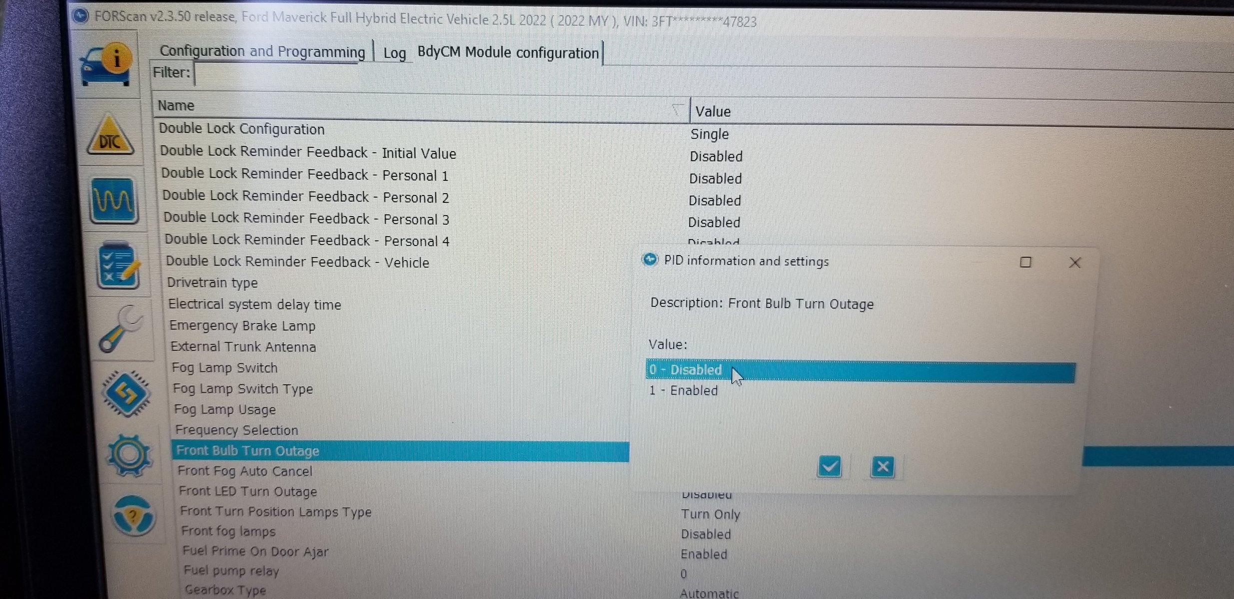

I had some switchbacks leftover from my Dodge ram that fit into the Maverick turn signal lights. It didn't have a resistor and made the turn signal indicator hyper flash. Through the Forscan I disabled the "Front Bulb Turn Outage" to "disabled" and it fixed it. Thanks for the writeup!

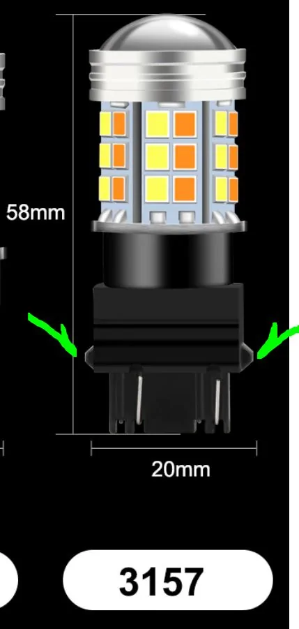

You’ll need to cut off the little nubs on the sides of the bulb socket. I used a sharp box knife. The plastic is soft and cuts fairly easy.
The bulbs are polarity sensitive. If the bulb does not work when you plug it in, pull it out and turn it 180 degrees, then plug it back in. I sort of freaked out when one didn’t work until I flipped it around.

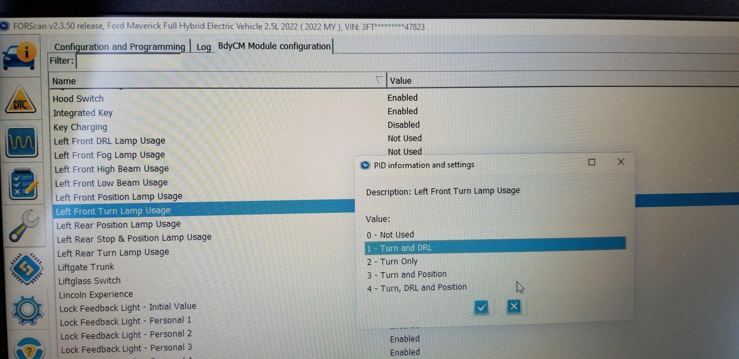

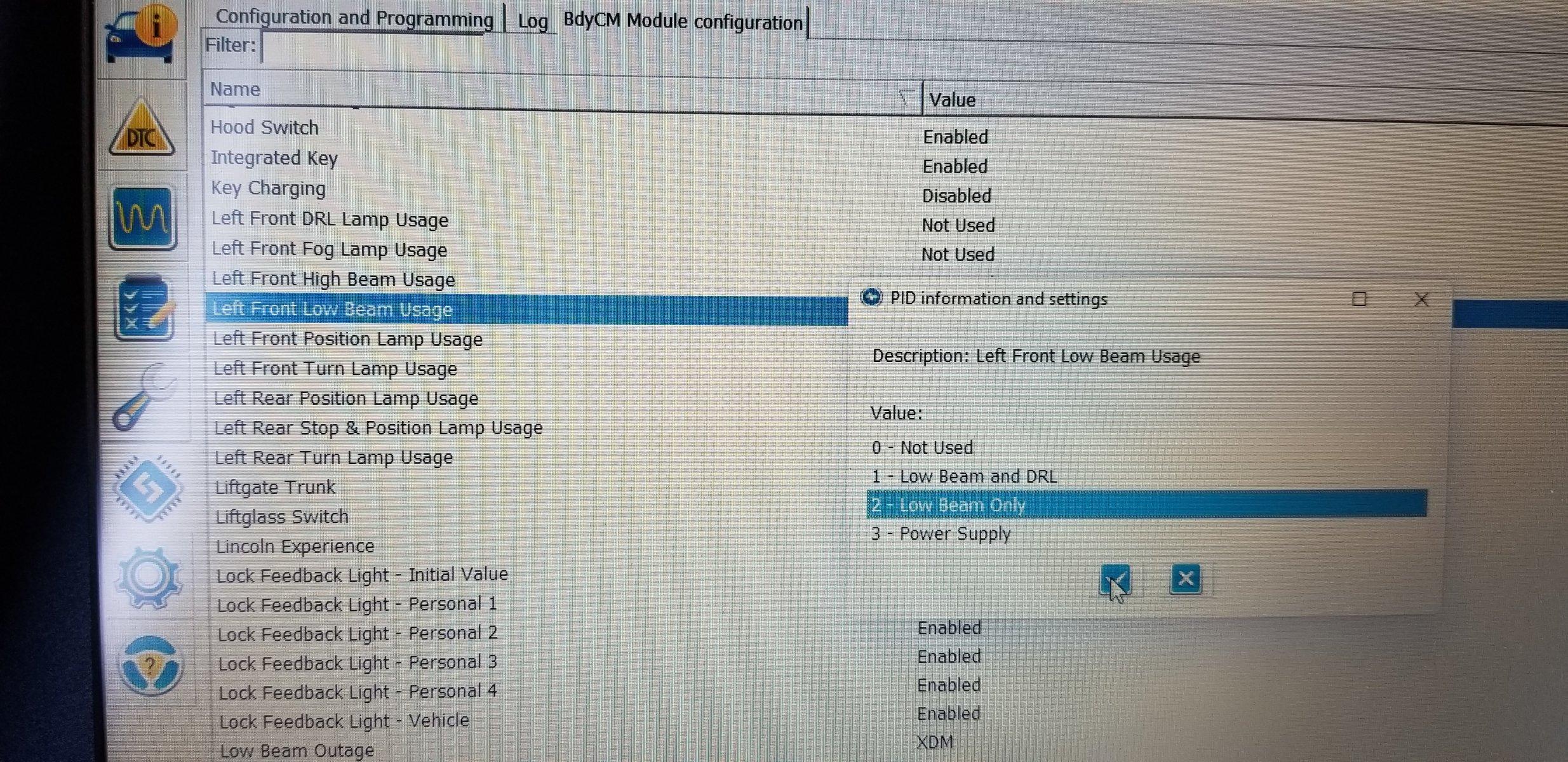

I finally got some time to try FORScan. I have an XLT which uses the Low Beam Headlights for DLR’s. I wanted to use my new 3157 Switchbacks for DLR’s also, so I made these changes in the BdyCM.
Changed the “Left and Right Front Low Beam Usage” to Low Beam Only (2)
Changed the “Left and Right Turn Lamp Usage” to Turn and DLR (1)
Changed the “Front Bulb Turn Outage” to Disable (0)
No more hyper flash and my Switchbacks are the DLR’s. If my front Switchbacks fail, I won’t get any hyper flash warning which is fine with me. Most of the vehicles I’ve owned didn’t have the hyper flash warning anyway.
I tried enabling the “Front LED Turn Outage” but that made the hyper flash come back. So I reverted back to Disable.
Thanks again 90.eunos.cosmo!
