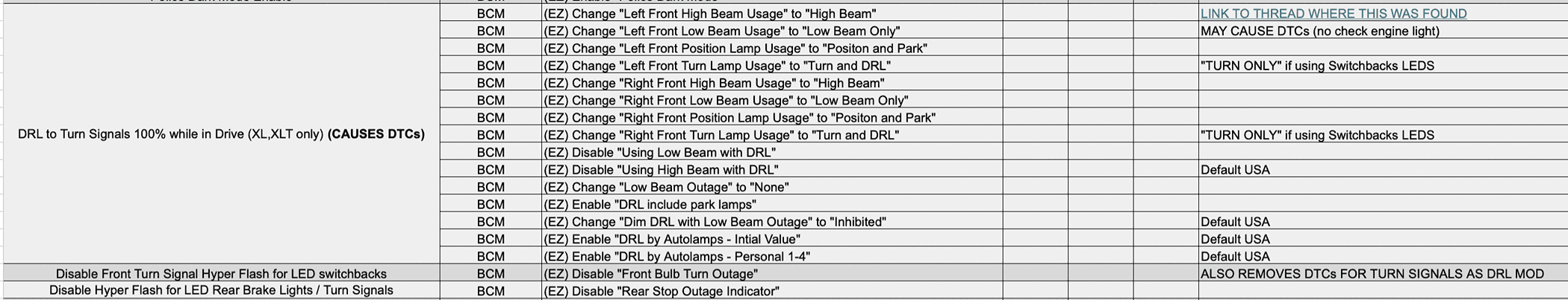

Forscan:
I had a lot of weird anomolies with my truck, causing it do weird things, so go through every setting carefully. What I found to cause mine not to work was the high beam said not used for one side, and "power supply" for the right side? This was really weird. I also had all my "DRL by autolamps" disabled as well.
Below are my settings to get this to finally work, and I checked after a bunch of cycles:
To get signals to be 100% brightness you have to change Left Front Turn Lamp Usage and Right Front Turn Lamp Usage. - Turn and DRL
LEFT
RIGHT
LOW
DRL

This absolutely works and is EXACTLY the way I wanted the DRL's on my 22 XLT FX4 to work. I personally can't stand vehicles that use the low beam for the DRL. One setting I did differently is I disabled the DRL with parking lamps. I ONLY wanted the amber front turn signal to be the DRL and after that setting change it is what I have. THANK YOU for messing with it long enough to figure out the right combination of settings. I knew there had to be a way to program it to do what I wanted, I just hadn't messed with it long enough to figure it out. Again, thank you for figuring it out and posting it!!

Yes, I am not sure why the left and right high beams are weird in forscan - but this was the trick I found to get this to work, perhaps the vehicle needs something to high beams to allow each function to work? But after trying everything, this was the aha moment and I couldn't believe it worked. I will test auto highbeams tonight as I am going out for dinner.

Yes! Changing the high beams to 'High Beams' did the trick. It was driving me nuts that I couldn't get the DRLs off when in drive.

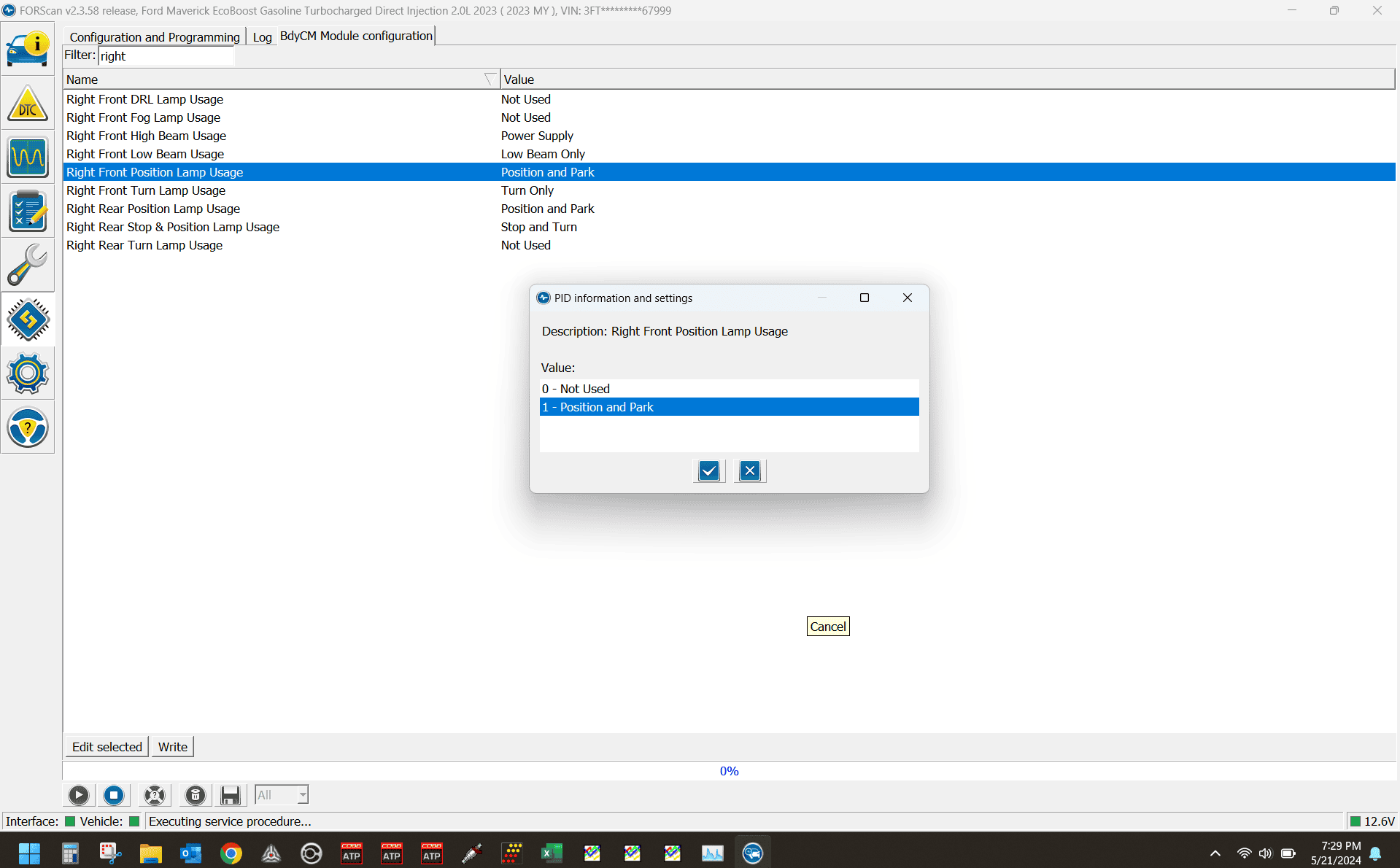

TRY THIS
(EZ) Change "Left Front Turn Lamp Usage" to "Turn ONLY"
(EZ) Change "Right Front Turn Lamp Usage" to "Turn ONLY"

IF YOU HAVE THE SWITCHBACK LEDS, YOU DO NOT WANT TO SET IT TO TURN AND DRL because the white switch back light works on low voltage and the orange lights works at full voltage.
YOU INSTEAD WANT TURN ONLY
