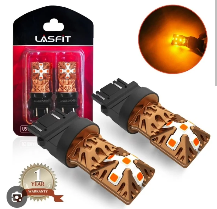

Thanks for that info. I am satisfied with how bright they are. I was worried that they would be too bright. The beam pattern of the Lasfit bulbs looks ok to me. My main concern is that the Lasfit bulbs will run cooler than the hologen and hopefully they will not burn out. I have read posts here where other owners said their Lasfits failed in a relatively short amount of time, not good.
I tried searching for the 3157 bulb you mentioned but couldn't find it on Auxbeam website? Other 3157 bulbs I found all seem to mention having to add resistors which I don't want to do. I guess turning off bulb outage in Forscan will take care of that?
I just realized you bought the Lasfit T3 bulbs. I had the previous gen bulbs which were reliable but were not very bright. I looked up the T3 and they were $63 on their website. Pricey
These are the Lasfit I had before.
